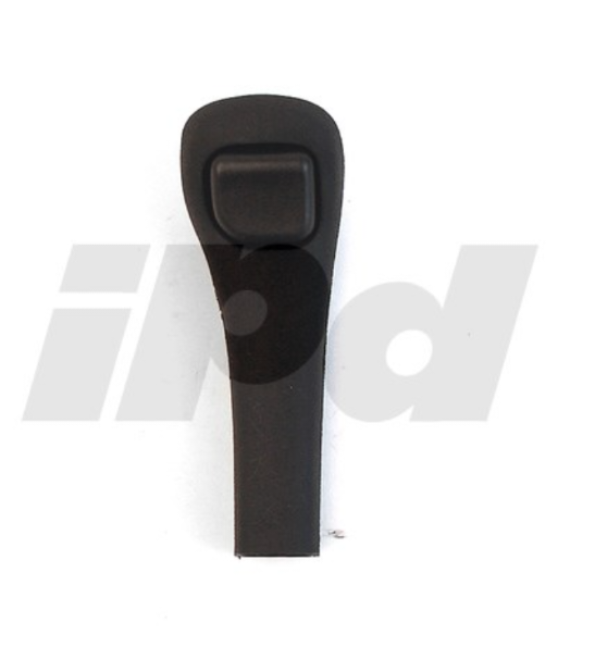

Now I have a new predicament: I need to find a plastic gear shifter. Mine cracked the other day. I looked online. New shifters cost over $120 - 160. This seems insane for a piece of plastic in 28 year old car. If anyone knows where to find this part for a reasonable price, I would appreciate it very much. If you have 960 parts car and can sell me this part PLEASE let me know.
The electrician in the local shop was able to fix this in a matter of 20 minutes. He even zipped tied the plugs to the coils to be on the safe side.
If you decide to replace ignition coil plugs, first of all make sure the wire is crimped properly. You can do it at home using regular pliers. This would save you WHOLE LOT of time later on and, possibly, even save you money.

Can you post a photo of the shifter knob? It may be the same as 240/740/940.

Here is picture of the shifter on my 960. Volvo part # 6843471
I believe, it is different from 240/740 as those shifters have a button on the top of the shifter. On 960 the button is located in the front (facing the radio).
Later 940 models might have the same shifter. Have not seen too many of these cars.
