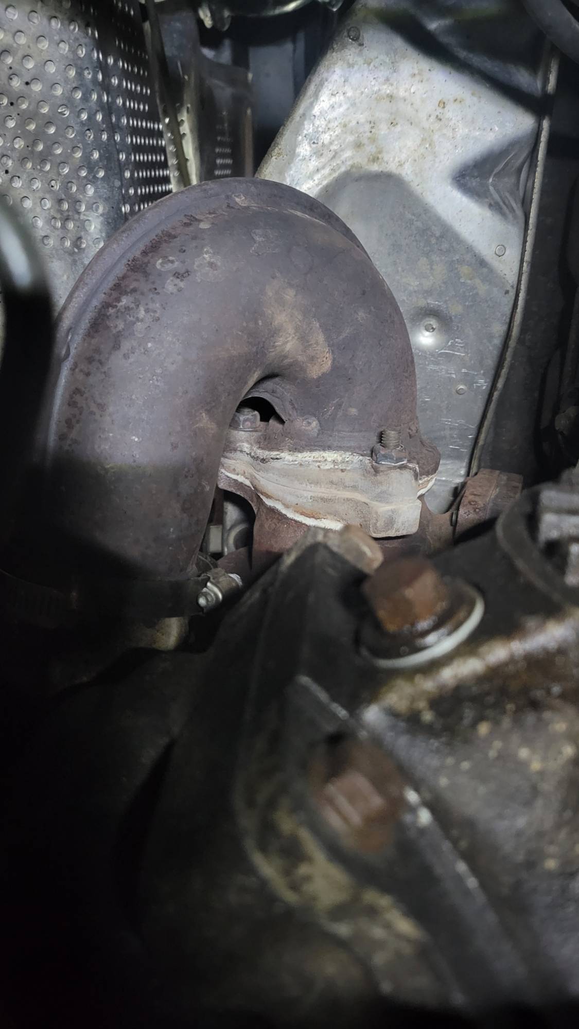

Hmm, this looks suspect. Brief research shows there isn't a gasket for P80s here but later cars do have a gasket. Has anyone adapted one before?

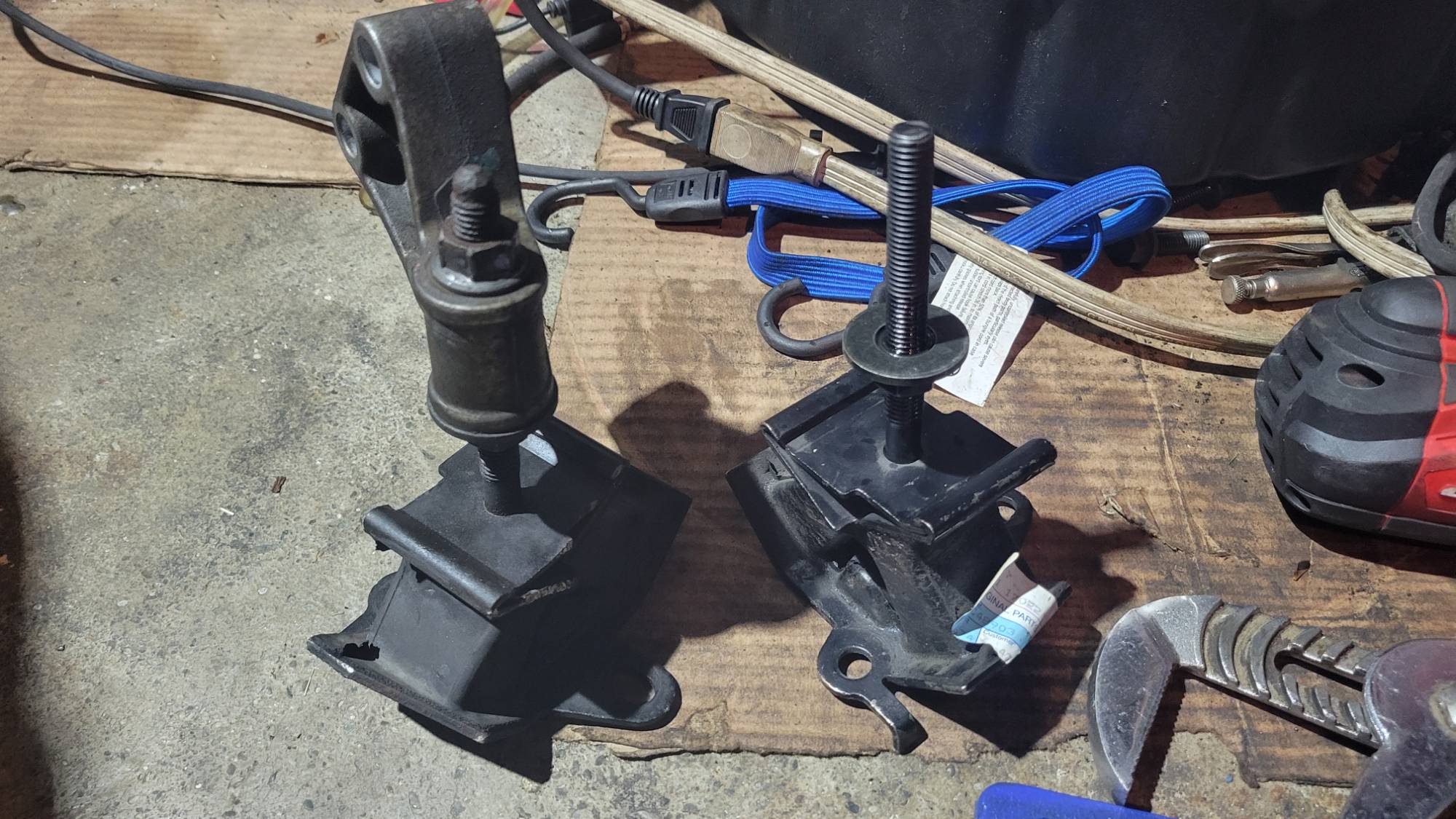

Last night I got the oil pan back into the car and bolts torqued. Very tricky to get the pan in without smudging the sealant, and I didn't like how far over I had to pull the power steering lines.
Also had a fight with the AWD engine mount.
Not sure this is going to be the issue. It was original to the car, but I read about adjusting the positioning of the bracket on the threaded rod changing vibration, and I remember when I put the top torque mount in, I had to jack the engine up on the transmission side to get the bolt in. But there was no way I could have adjusted it in the car with the amount of violence it took to get the retaining nut off the old mount.

Sorry, having difficulty orientating myself to the first picture. Is it the exhaust manifold?

That is looking up at the back of the engine as if your head was on the passenger side and feet dangling out from under the drivers side. That's the flange from the turbo to the downpipe.

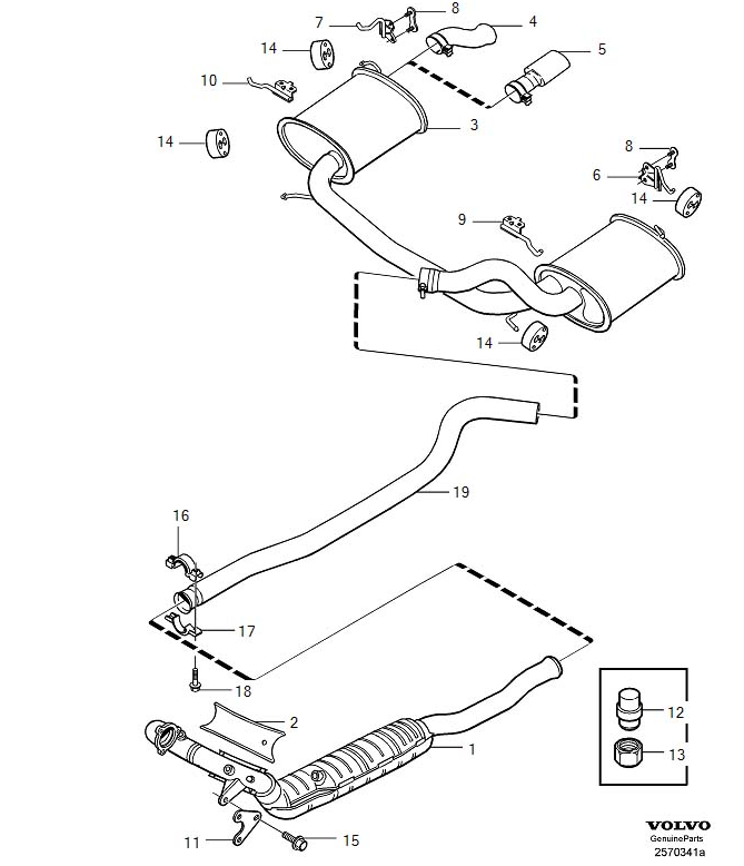

There should be a gasket from what I can see on a parts drawing. However, it looks like it is NLA:
https://www.volvocarstorontoparts.ca/p/ ... 75549.html
This is the muffler parts drawing for a 98 turbo engine:
https://www.volvocarstorontoparts.ca/a/ ... 69044.html
You may have to try for aftermarket suppliers for down pipes to get a suitable gasket or a muffler shop possibly?

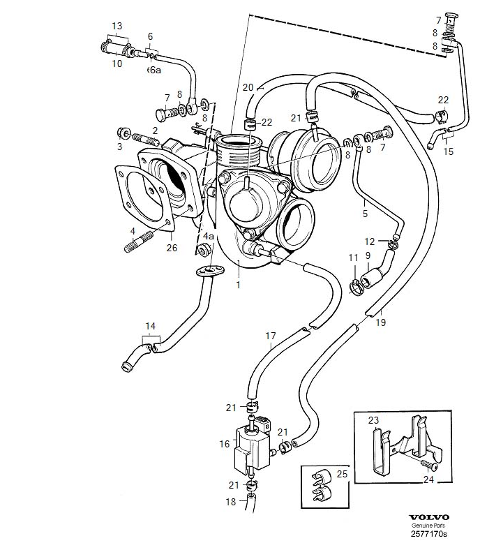

Interesting, for the AWD it shows no gasket there. But it does show a gasket between the turbo and exhaust manifold, which I had the understanding did not have a gasket. Trying to look for leaks between turbo and downpipe or residue doesn't produce many results, but does show many results for leaks between the turbo and exhaust manifold.scot850 wrote: ↑09 Aug 2024, 17:08 There should be a gasket from what I can see on a parts drawing. However, it looks like it is NLA:

There is a thin metal gasket there. Probably aftermarket only. I will look in my stash at home in a few days.

Unless it is a cup and ball design on the muffler there, it will need a gasket. As you may know, the joint behind the cat to the rear muffler pipe had that type of joint.
Sorry, did not pick up it was an AWD car, although you do mention it and it has an AWD trans mount! D'oh!
