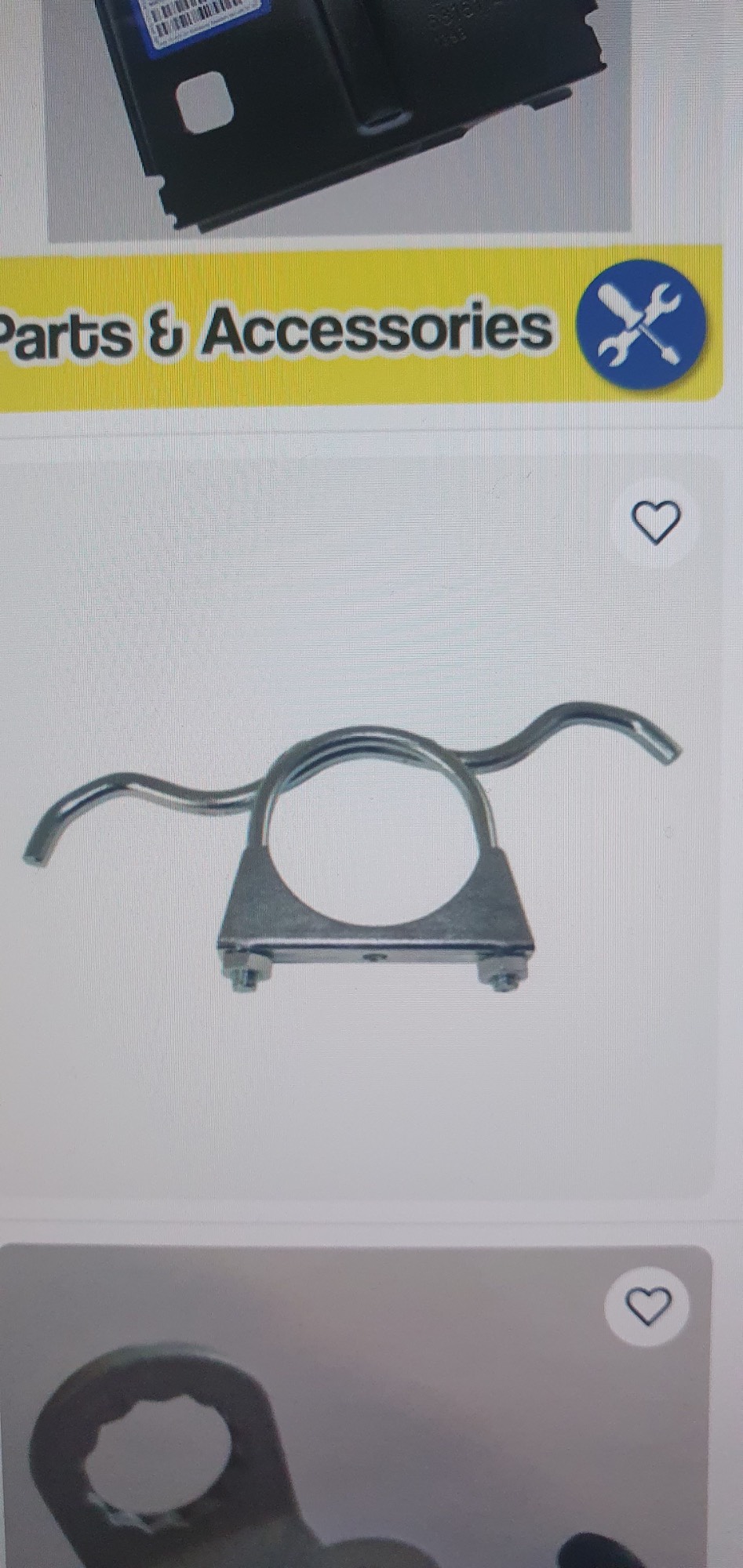

There has been these kind of bolt on adapters to replace rusted brackets.
But if you mean the the actual bracket at the car then its different story and i propably would screw it in place.

Thank you all so much for taking the time to reply.
I initially thought this was going to be a headache to get sorted but I am so glad I posted the question as its a simple solution. I looked at the different options and decided on the simple bracket as in the FCP image. Cost here in UK £5.99 so not bad to be fair.
I was tempted with the Volvo oem replacement bracket but the cost was not justifiable in my opinion.
Once again thank you all for the links and advice on the repair, I am very grateful that it will be a simple fix.

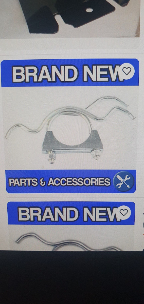

To Xanthefin and all.
I purchased the repair bracket here in the UK but I've just noticed your image has two hangers on the right and one on the left. The bracket I purchased only has one hanger on the right and one hanger on the left.
Have I missed something here? I would post a link to the site I purchased the bracket but for some reason I'm unable.
