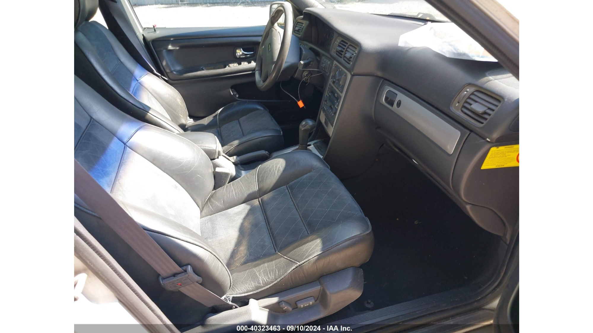

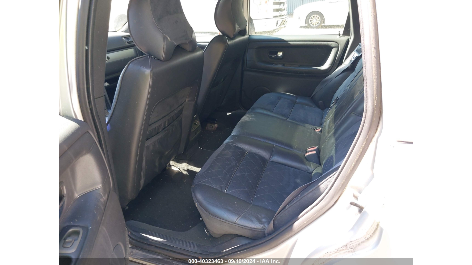

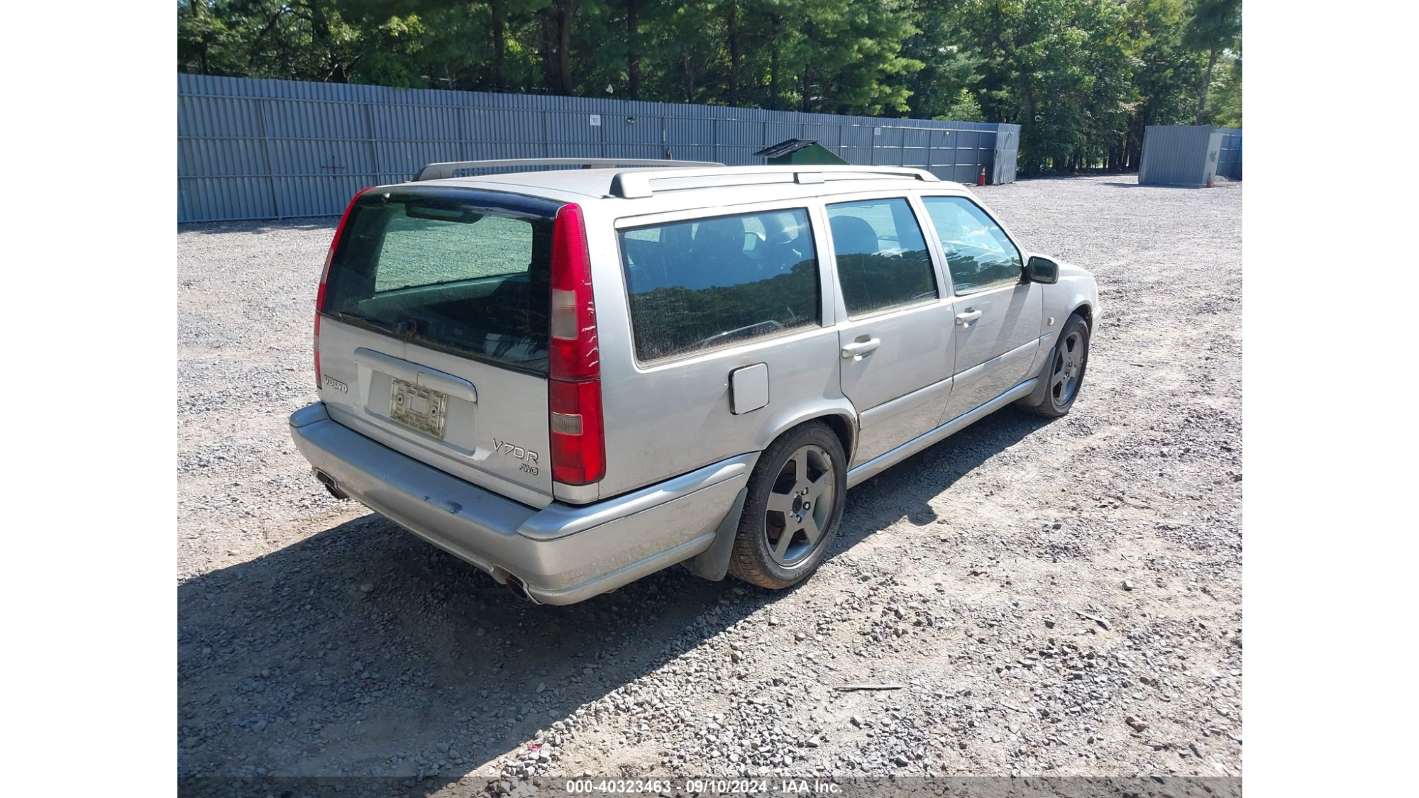

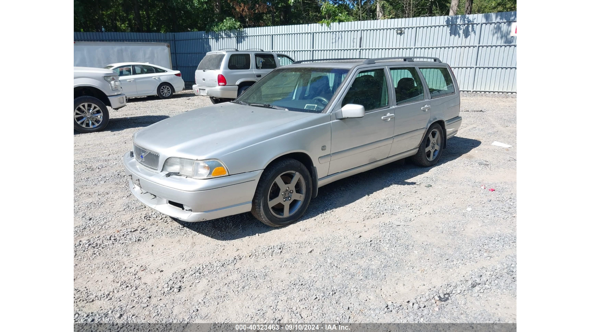

Here is an interesting one but you have to use one of their Brokers unless you're a dealer or dismantler. Auction is tomorrow morning.
If the AWD breaks will using just the FWD be similar in terms maintenance as a reg FWD?
Selling Branch: Central New Jersey (NJ)
2000 VOLVO V70 R
Buy Now Price: $1,000
146,576 mi
The interior and door cards!
https://www.iaai.com/VehicleDetail/40811948~US
