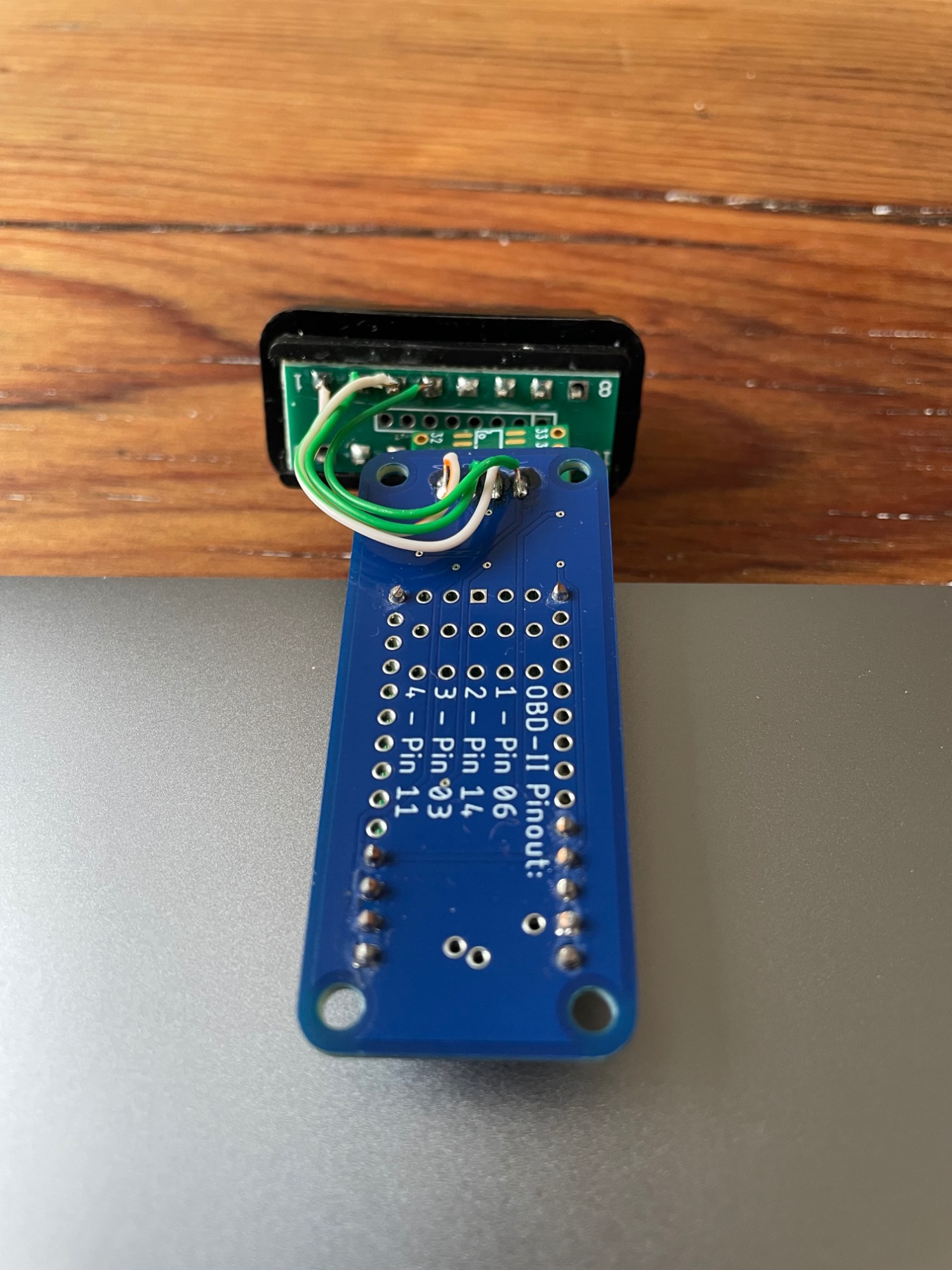

vtl wrote: 13 Oct 2024, 19:00
nikemen wrote: 13 Oct 2024, 18:37 Hello there!
I've got the printed board (https://www.pcbway.com/project/sharepro ... 037d5.html) to crack the CEM PIN of my C30 and I soldered the Teensy and the Bosch transceivers, but it doesn't work. I got no communication with the car's bus, regardless of the key position. Basically, I get the same respnse in the console whether the cable is connected to the car's OBD or not.
When I compare the plan posted on volvo-cem-cracker's Github to the board I got, I see my board hasn't any resistor. I get R3 and R4 are not needed when cracking via OBD, but the board has no place either for R1 and R2. I think that could be the source of the problem, but I am not sure.
Also, the Bosch CF160 transceivers don't have numbered pins or a dot to signal pin 1, so I could have soldered them wrongly... but nothing smoked while connecting them.
Can someone guide me in the right direction? Did someone make it work with the PCB I got?
Thanks in advance!
Show pictures?
Here they are. The setup is not good looking: due to the chip shortage when I bought the components, I got a Teensy 4.1 instead of a 4.0.

Post by vtl »
nikemen wrote: 14 Oct 2024, 08:57 Here they are. The setup is not good looking: due to the chip shortage when I bought the components, I got a Teensy 4.1 instead of a 4.0.
No common ground between OBD connector and Teensy? The original schematic has it:
