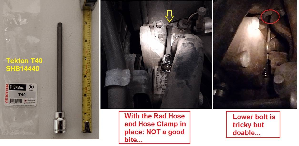

So,
I just bought a Tekton T40 socket (6" long), PN SHB14440.
It says 6" long but the usable portion is only 5" long as shown.
It is about $6-$10 online (eBay etc.).
In a perfect world, remove the 4 bolts on PS Pump and set it aside, but some may not have the
serpentine belt Torx tool.
So, if you replace it in situ, options are:
1. As I mentioned previously, swap ONLY the Upper housing + Tstat itself + ECT sensor.
This is the easiest way.
2. Now, if you insist on replacing the whole Tstat housing, then undo the Rad Hose + and Smaller Hose.
Then you can get access to the upper and lower bolts.
Best is to remove the Upper Housing, then it is much easier.
To install the bolts without dropping them, use tiny piece of paper towel to wedge the T40 bit into the head
of the bolt (an old trick taught to me years ago). Practice it outside of the car and you will see.
Anyway, pic of the tool in case you want to buy it...
