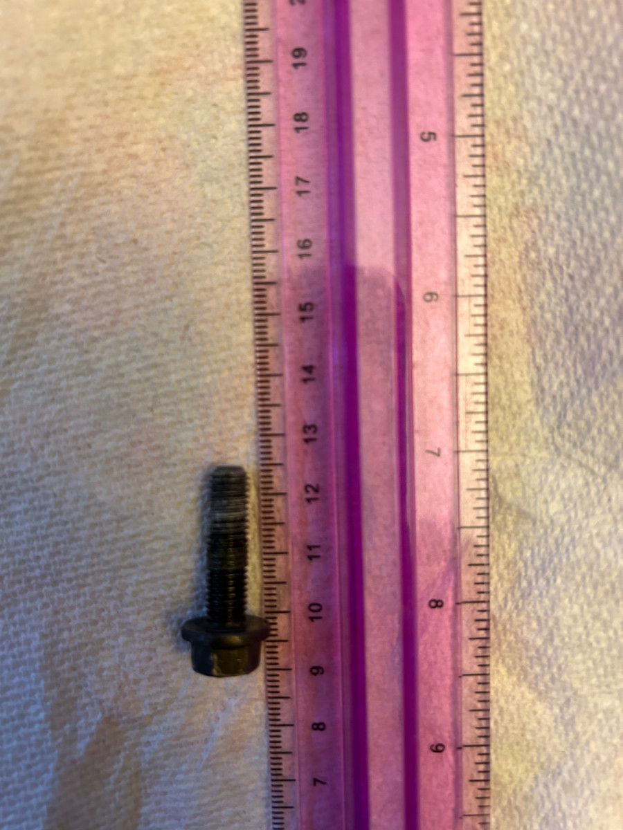

Putting the engine back together on a 2004 xc70, 2.5t engine.
Can't remember/can't find the 2 bolts for the metal coolant pipe that attaches to the back of the head, right next to the water pump and timing belt.
2 bolts, both attach to the head, the hold a metal pipe to the head via gasket #1236119 https://www.fcpeuro.com/products/volvo- ... or-1236119
Should I just use one of the old waterpump bolts? Those M7x25mm bolts seem to go everywhere on the head...

I just removed one of them (upper) to be sure: yes the thread is M7-1.0, length is 25 mm.
Water pipe top bolt
Water pipe top bolt

Awesome. Thanks!
