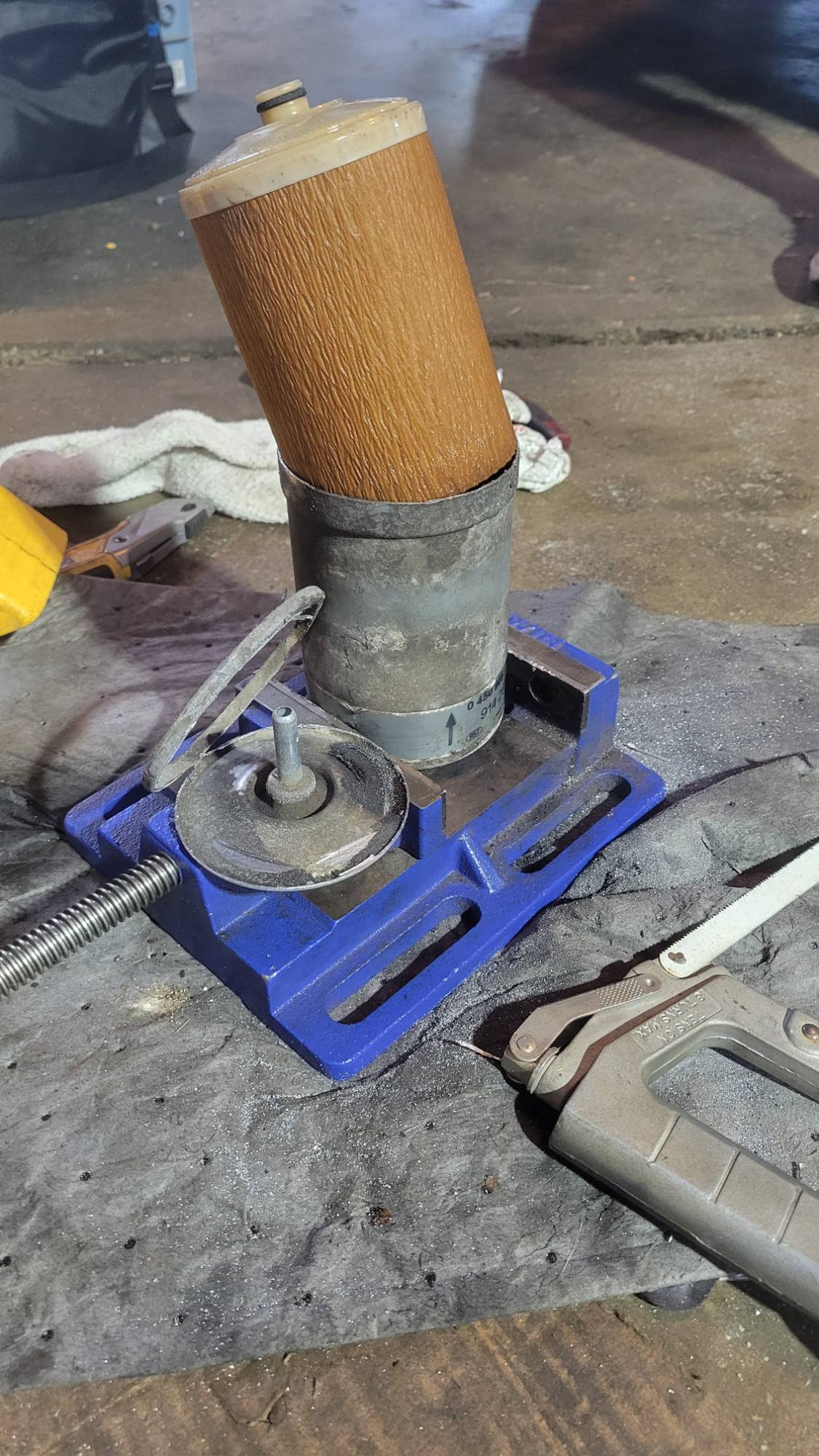

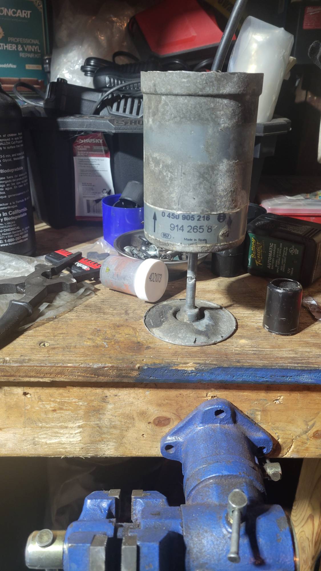

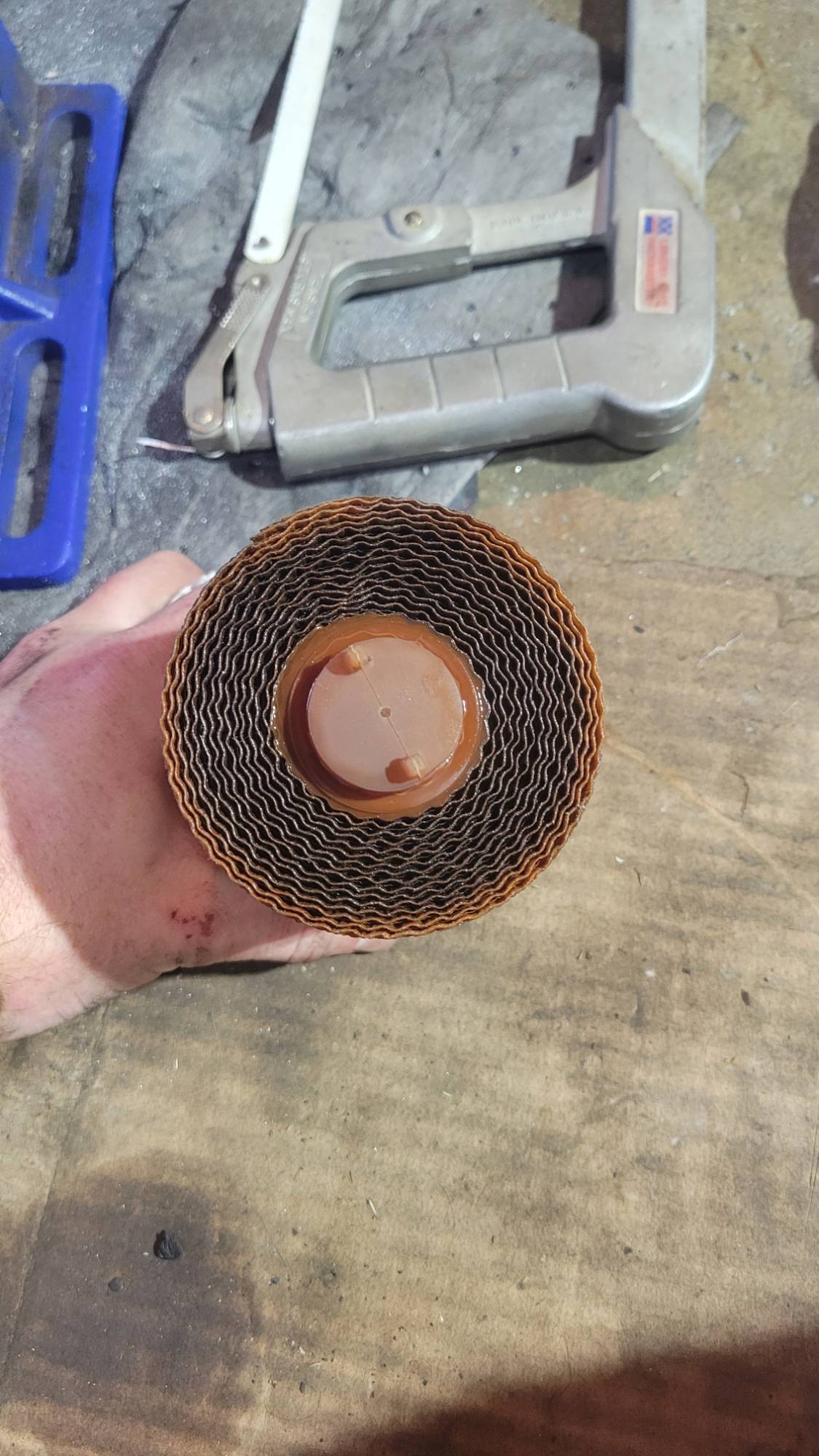

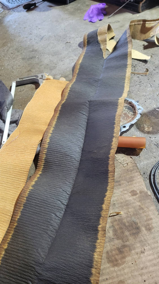

I had posted about my original 188k mile fuel filter, then forgot I said I would post pictures.
As you can see, the media was a little dirty. Almost 2x the recommended change interval.
Got a little distracted and pulled out the flux core welder to make this elegant wine glass (pen/sharpie holder)
