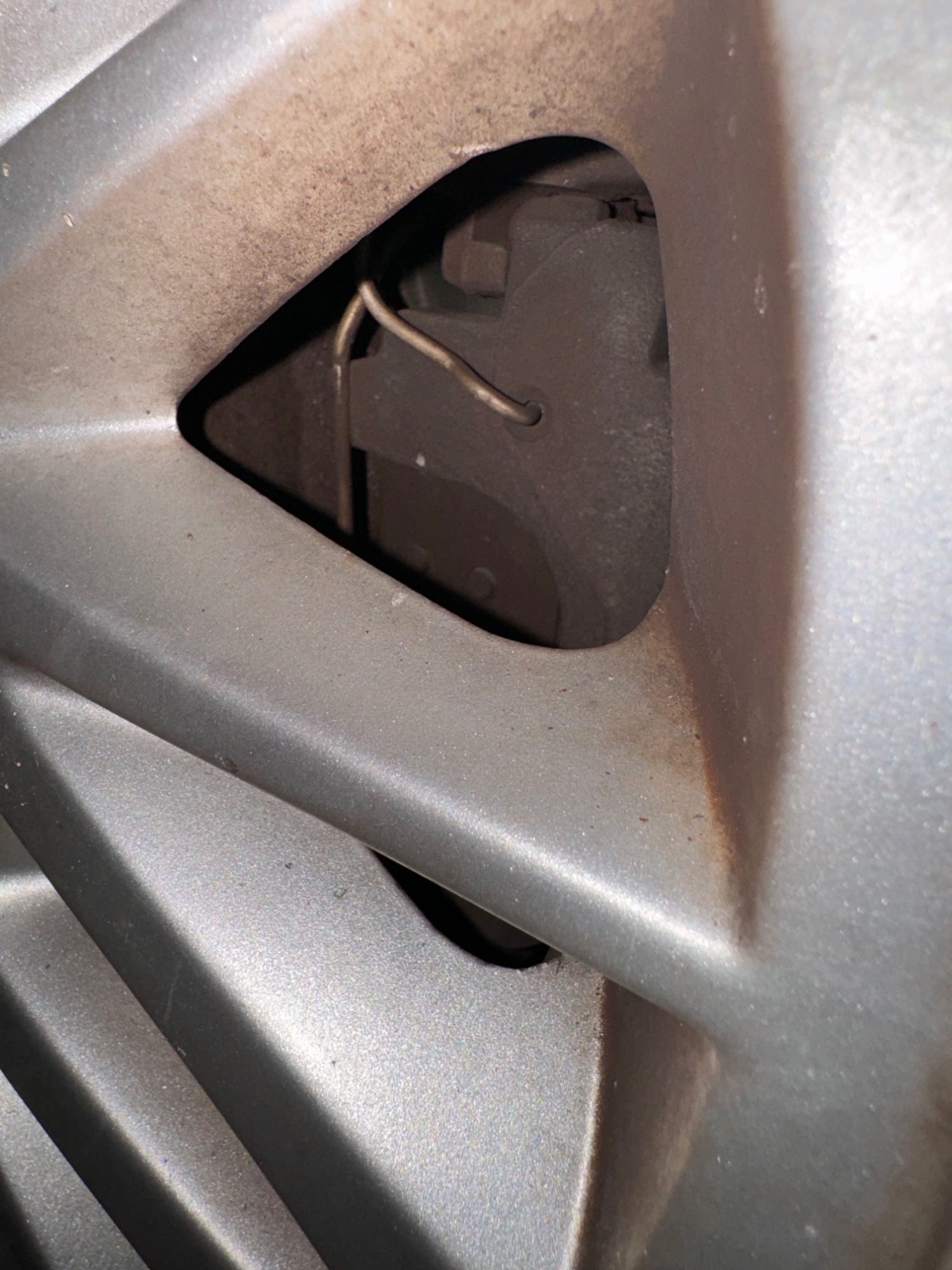

Ok guys, so the front calipers are ok but the rear ones are not ok
I’m really grateful for your help guys, I’m gonna try to put the callipers in the correct position and then let you know if the problem is solved!!

I don't know if it's possible with your car but I've seen calipers swapped left on right, right on left and the air bleed screws ends up in the lower position because the calipers are mounted on the wrong side and this traps air in the calipers.
