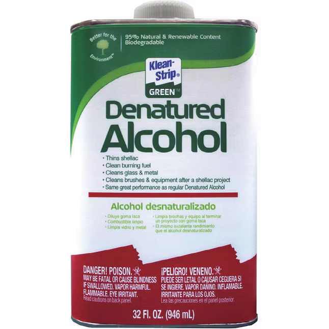

https://en.wikipedia.org/wiki/Denatured_alcohol
Denatured alcohol, also known as methylated spirits, metho, or meths in Australia, Ireland, New Zealand, South Africa, and the United Kingdom, and as denatured rectified spirit, is ethanol that has additives to make it poisonous, bad-tasting, foul-smelling, or nauseating to discourage its recreational consumption.
Klean-Strip Quart Denatured Alcohol
https://www.lowes.com/pd/Klean-Strip-Qu ... ol/3078771
It use to be the cheapest multipurpose go to product for cleaning but seems to have been overshadowed by other similar products like paint thinner, acetone or paint surface preps. Any of the products dry quick so I doubt there would be long term harm to the seals.
If in doubt use 99% rubbing alcohol as it evaporates extremely quick. Careful however it is not as forgiving as regular 70% on household paint or potentially other surfaces.

I had thought about IPA/rubbing alcohol. I tried it but with brake fluid it leaves a residue and does not remove it completely. I have ordered some denatured alcohol, but for some reason, all of these products take weeks to get here. I will try brake cleaner initially and reclean it when the alcohol eventually gets here.
Thanks for the info, but I had already read all of that. Also we no longer have Lowes up here, and even when we did, they did not carry all the stuff they did in the US. Rona who Lowes bought out, bought them out the other way when Lowes decided like many other US companies their business models don't work here for some reason (Bed, Bath and Beyond, Target, now Lowes to name the more recent failures).
