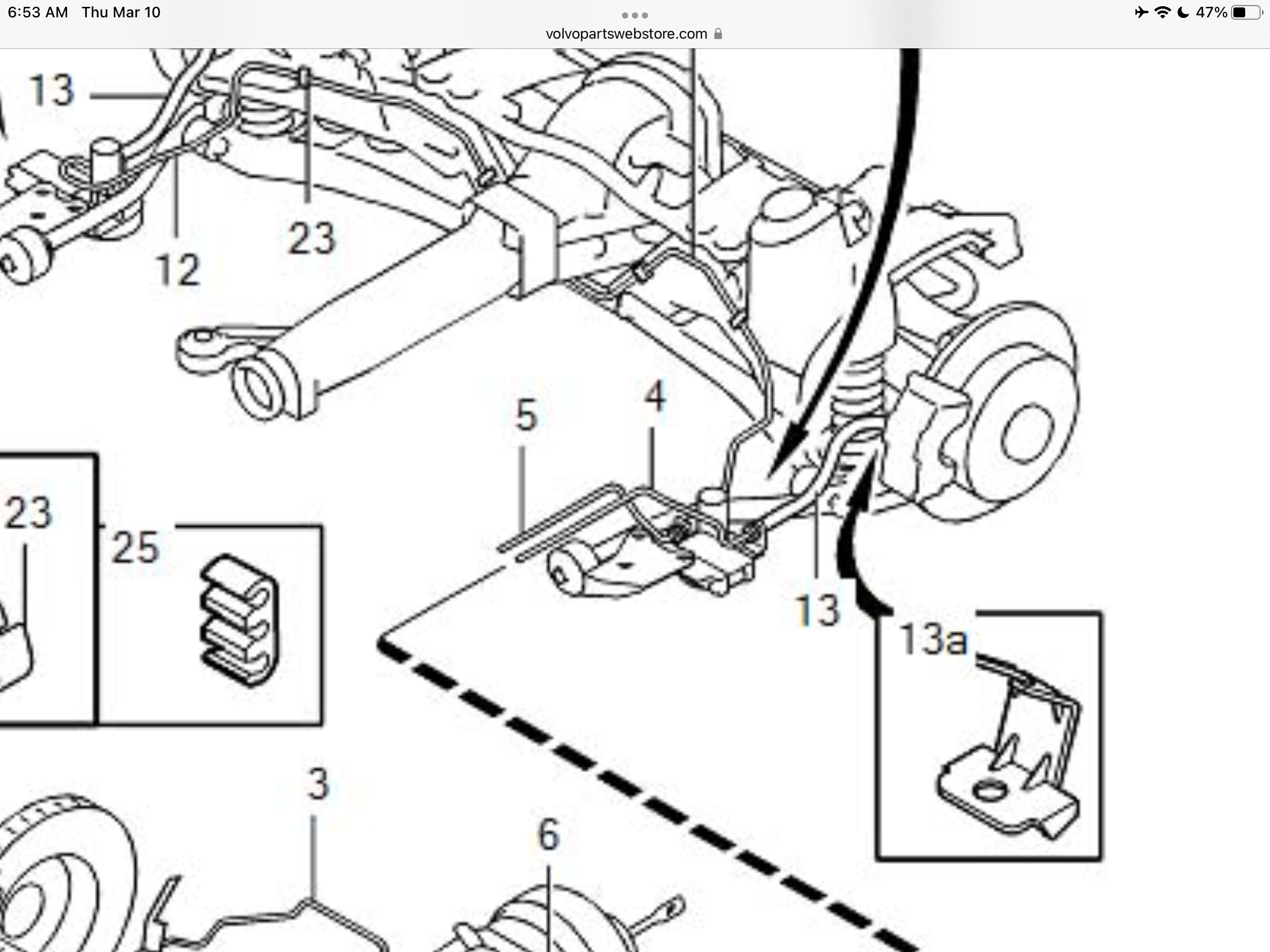

Bled all brakes except left rear, no fluid push, possible ABS hang up ?

Found I had pinched left brake line torsion arm. Will make up new hard line

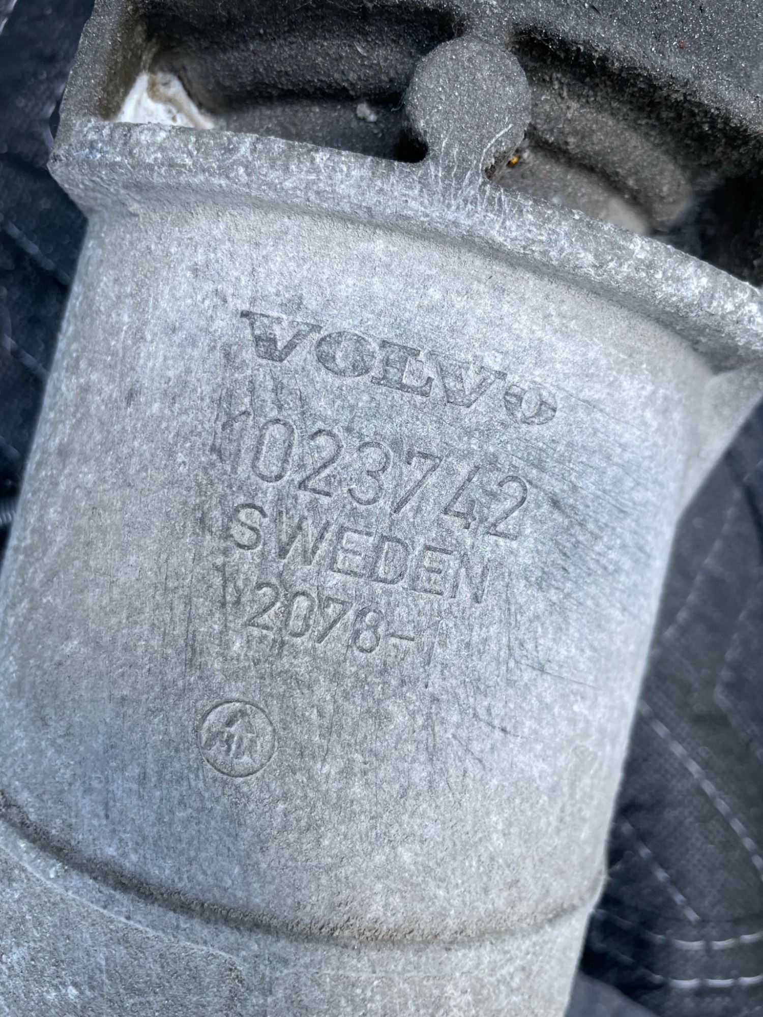

6 Sep 145660 Fuel pump failure, replaced with grj444 adapted to case
viewtopic.php?t=100728&start=10
Nice diagram of AAwD fuel pump insert
viewtopic.php?p=596972&hilit=1999+fuel+ ... or#p596972
Documented VC part number below
