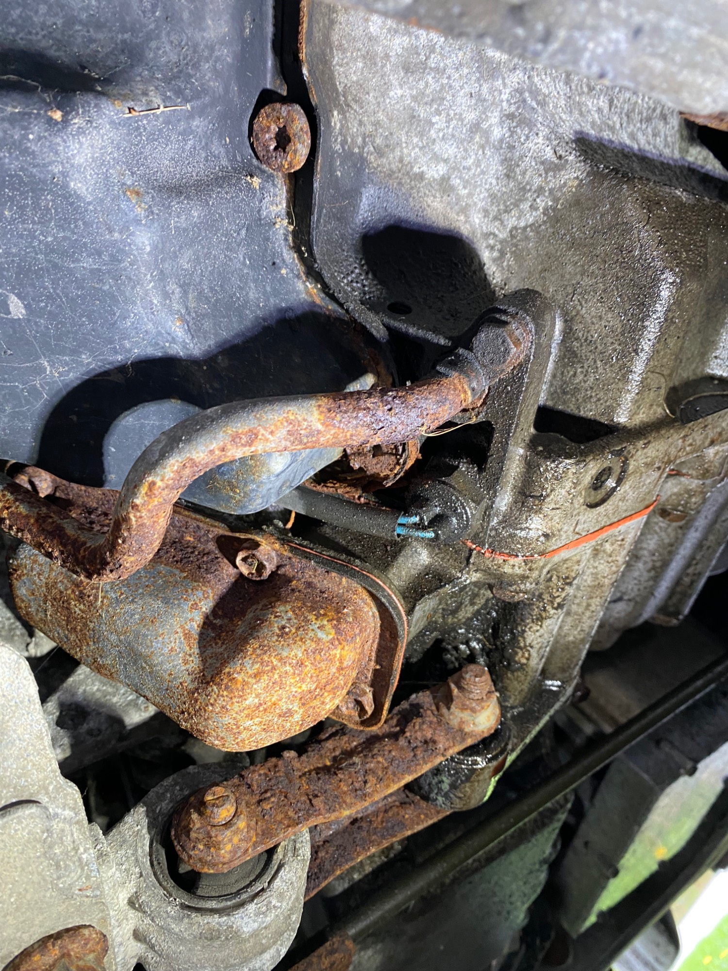

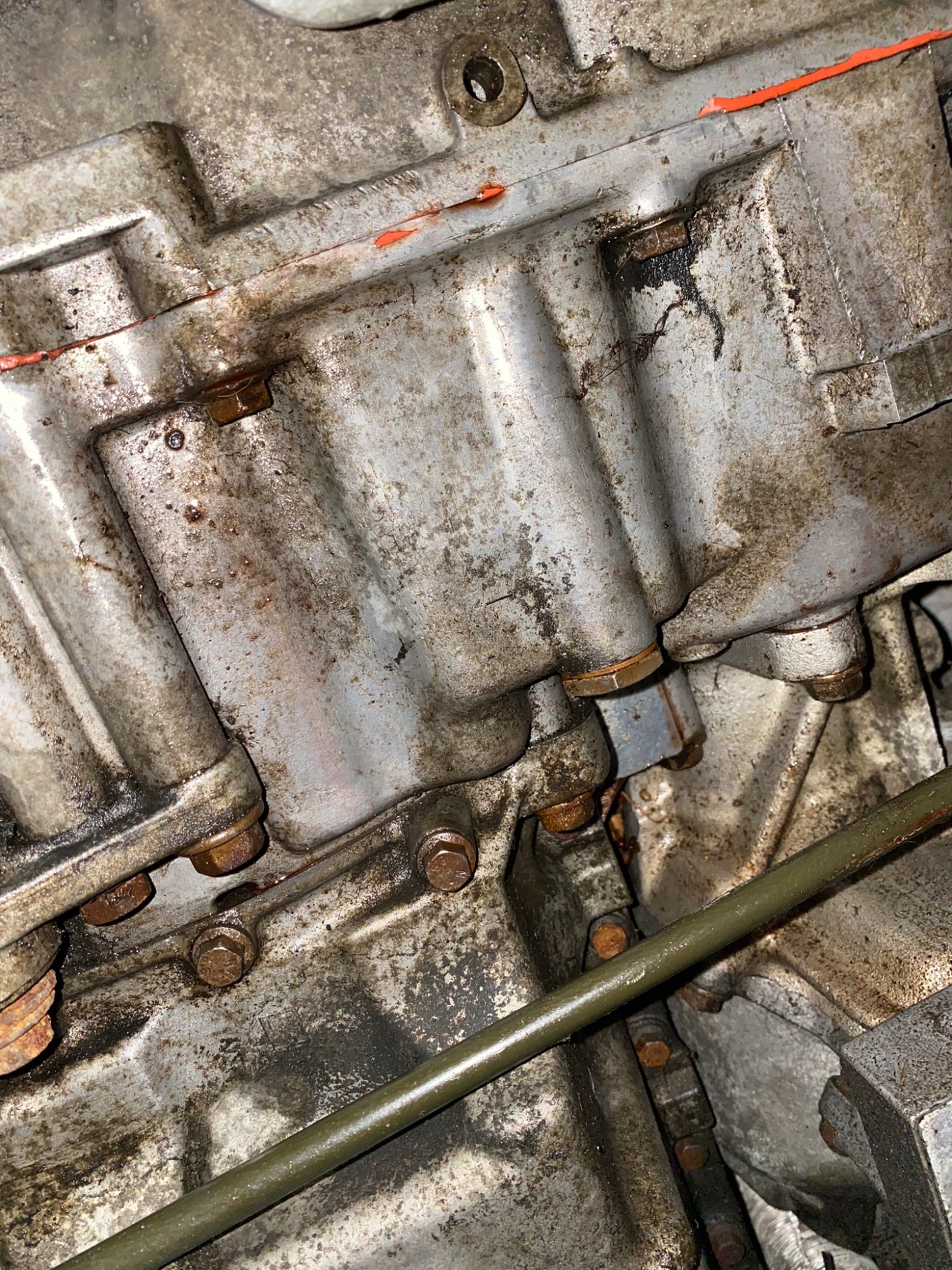

I’m seeping some ATF from the front of the trans. I’m guessing o ring on lower ATF hose
- Posts: 15496
- Has thanked: 2203 times
AS we always recommend, clean, run and re-check. I don't think that bottom pipe is leaking. Hate to say it it looks more like an RMS which is often a symptom of standing for a long time. Try some Blue Devil or AT-205 RMS sealant if it is now available again in the engine oil and take it for a good run. I had a similar issue with the California bound 850 which started to leak on the run to CA. A bottle of Blue Devil in the oil just short of Reno and all was good by Santa Rosa. Still not leaking 6 years later.
Oil at the A/C compressor might be PCV which might also explain an RMS assuming that is it.
Point of Note!! Check your second picture above. Look at the upper mounting bolt for the A/C compressor!! EEK!

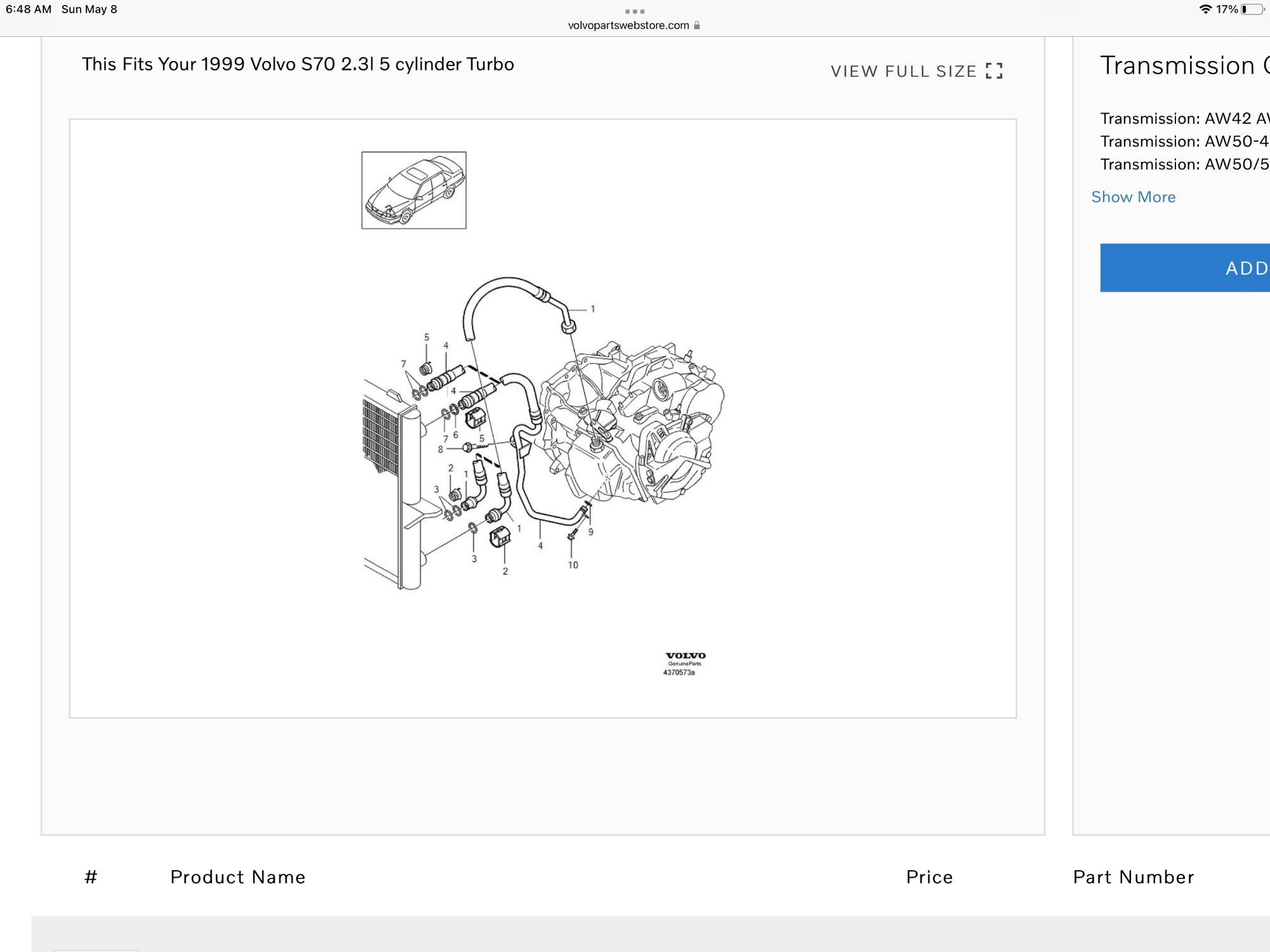

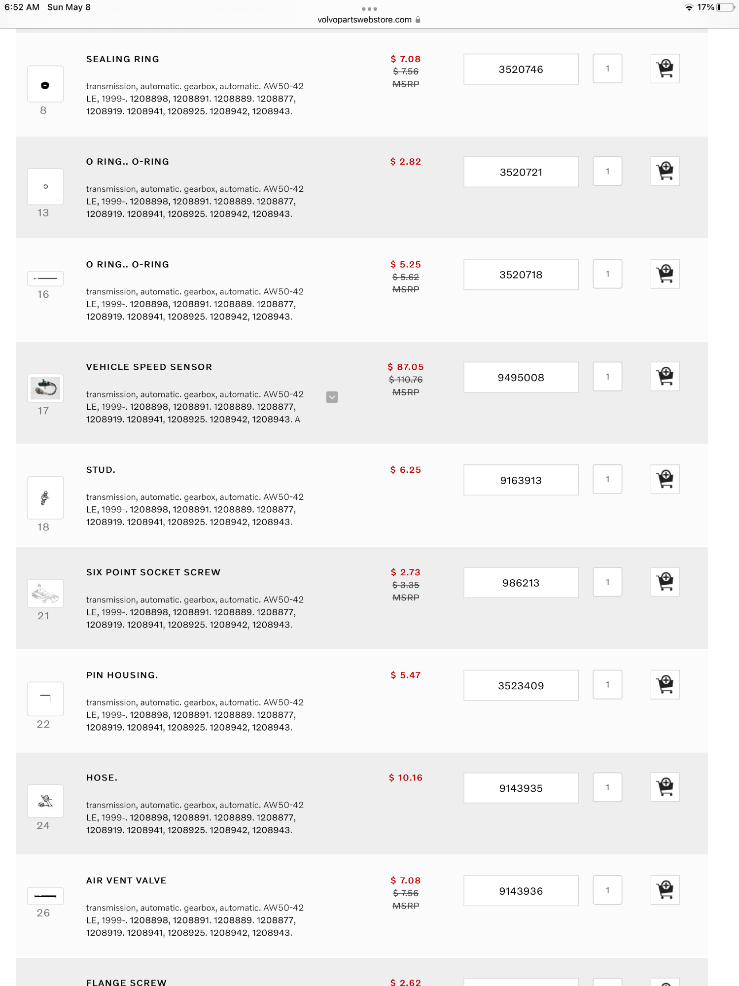

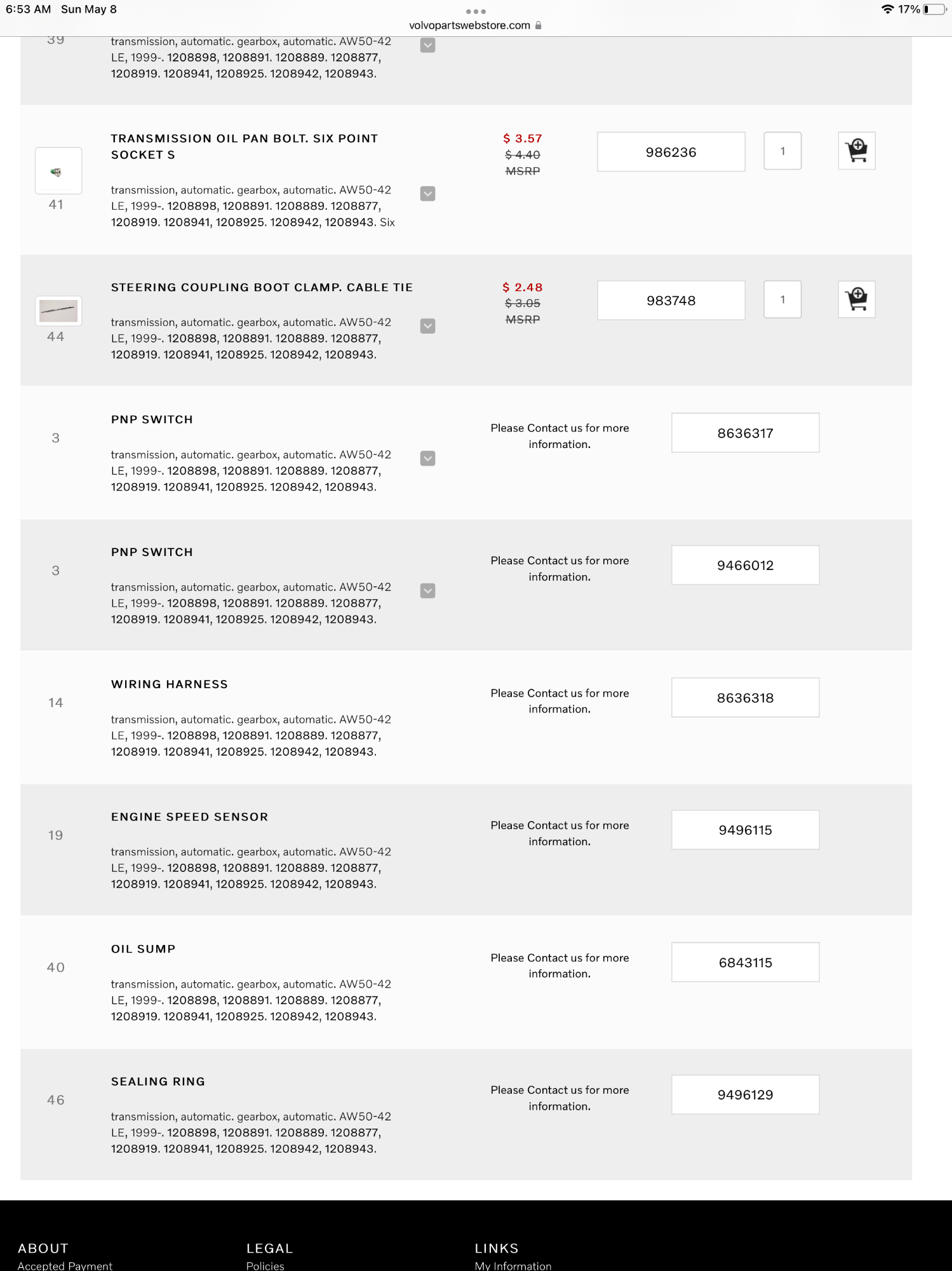

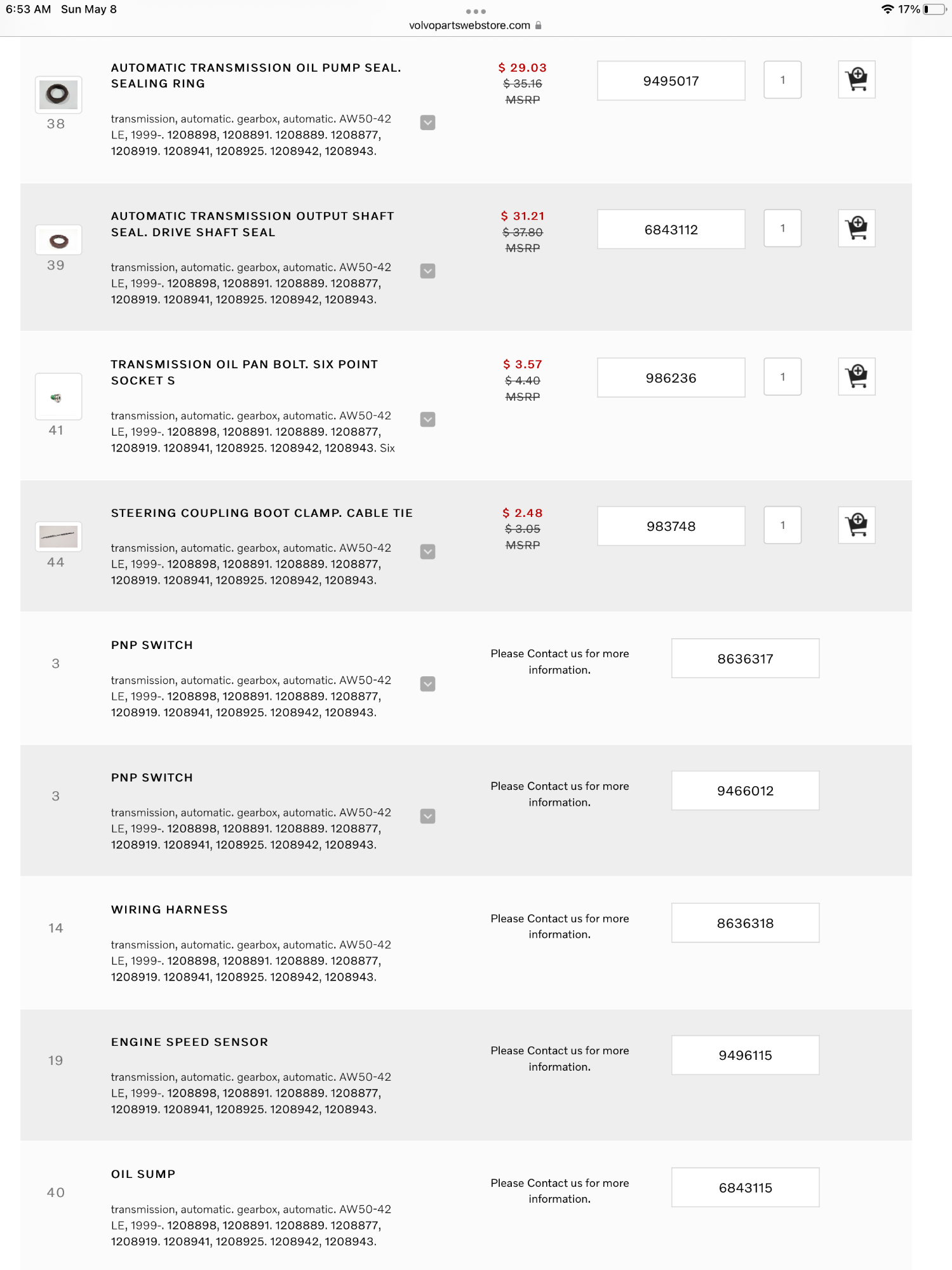

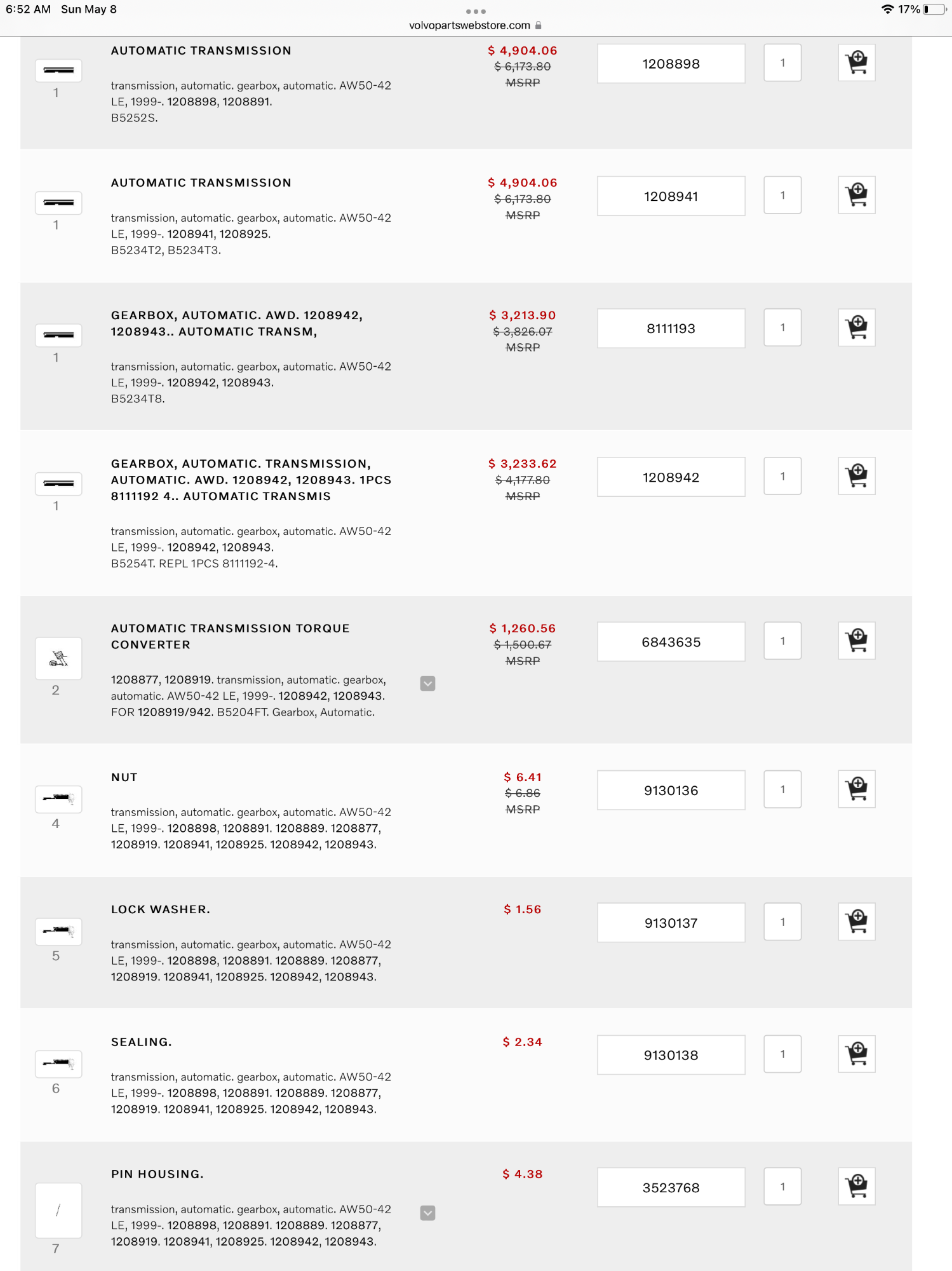

Transmission cooling parts
- Posts: 36149
- Been thanked: 4068 times

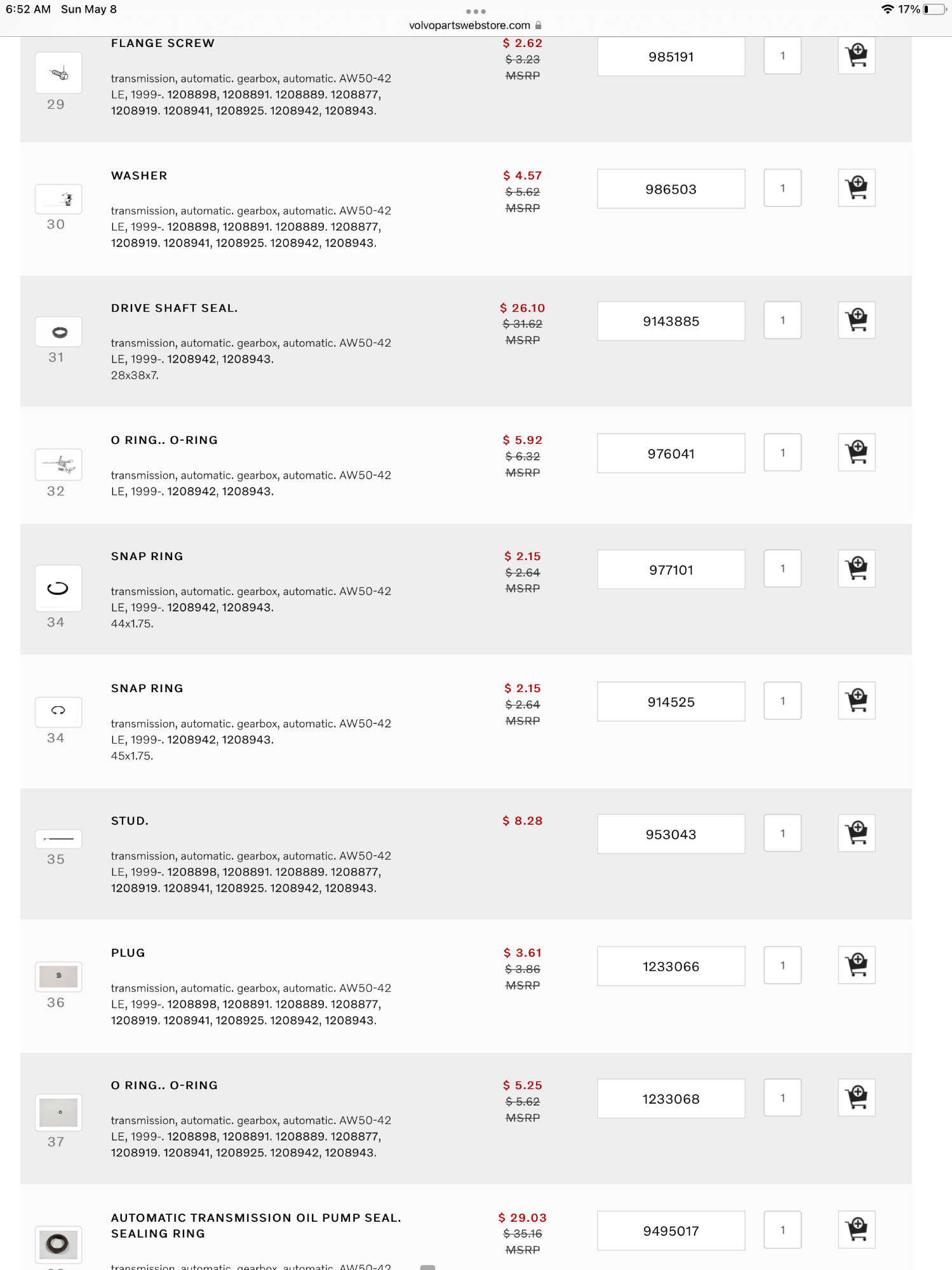

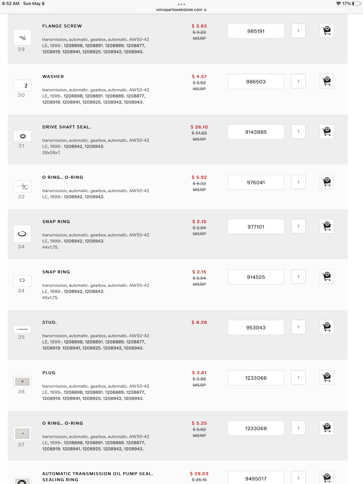

Full transmission parts
- Posts: 15496
Umm, should we be worried when you show the whole parts thread?? Hopefully you need little if none of this!

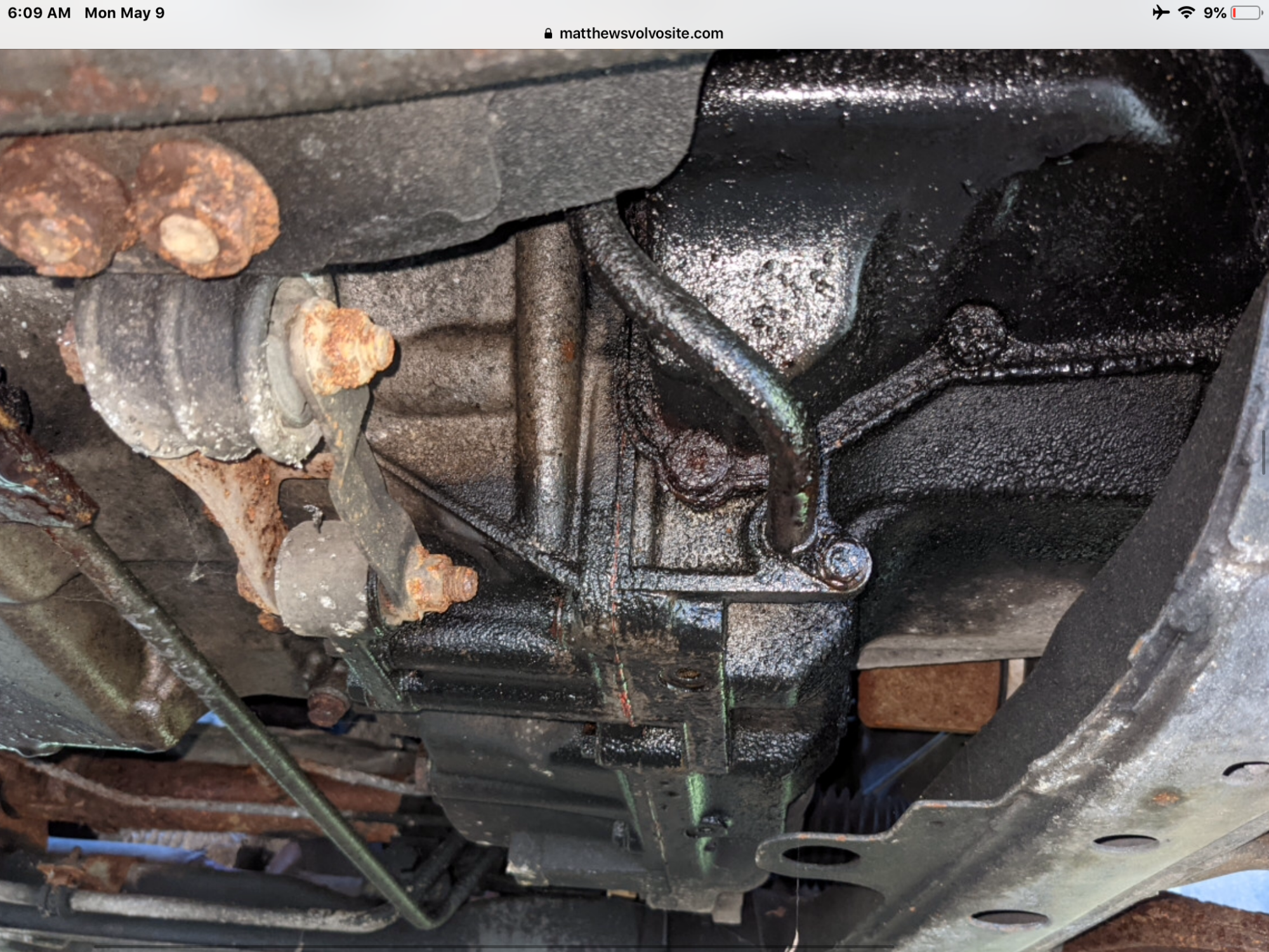

Cleaned and dried it. Idled got 20minutes.
Nothing
Nothing
- Posts: 36149
Looks like Transmission main seal, serp from the weep hole
- Posts: 15496
That is not a fun seal to do. Ask my local dealer! They had to do it twice to get it to seal.
