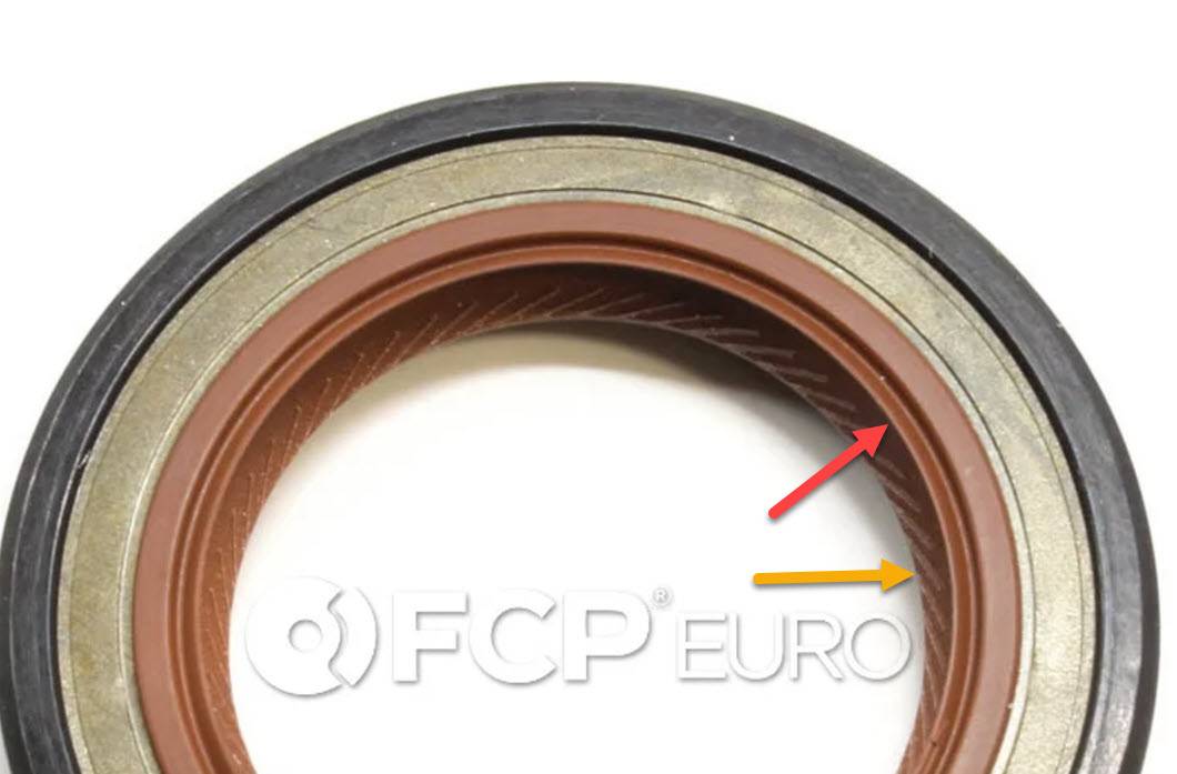

ok, lets go ahead with the dumb question. so what I was concerned about was the really small lip at the red arrow being folded in at a few spots. Which I could barely see but I got ocd in my inspection and noticed it. after i pulled the seal thinking that was a failed install it seems maybe this part of the seal isn't of much significance. the inner seal yellow arrow I guess is what is of importance? because that small outer seal is so insubstantial in its thickness that I see no way of keeping it from folding in some using the install tool. any thoughts?

Do a Google image search using key words "seal garter spring", which sits under the YELLOW arrow.
The RED arrow is simply a "dust sealing lip", just to keep debris from getting to the main seal

cn90 wrote: 09 Dec 2024, 15:32 Do a Google image search using key words "seal garter spring", which sits under the YELLOW arrow.
