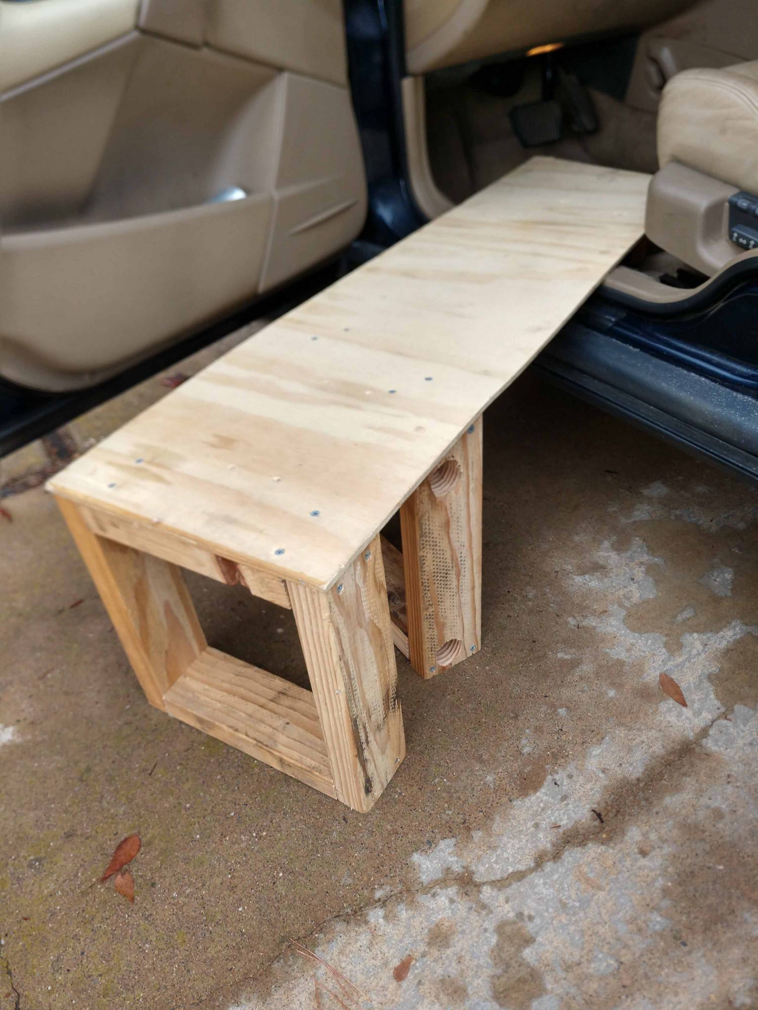

"Heater core replacement can be eventful with driver seat in place" Eventful!xHeart wrote: ↑12 Dec 2024, 08:05 Heater core replacement can be eventful with driver seat in place, but without driver seat can be a joyful work space.
Alawys use Volvo clips and o'rings, more here viewtopic.php?t=105361
compares well to medieval torture levels of pain. Removing the seat is well worth the extra effort if spending any amount of time under the dash.
Here's what under dash repair pain inspired me to do for another upcoming under dash repair. I also now remove the seat every time.
