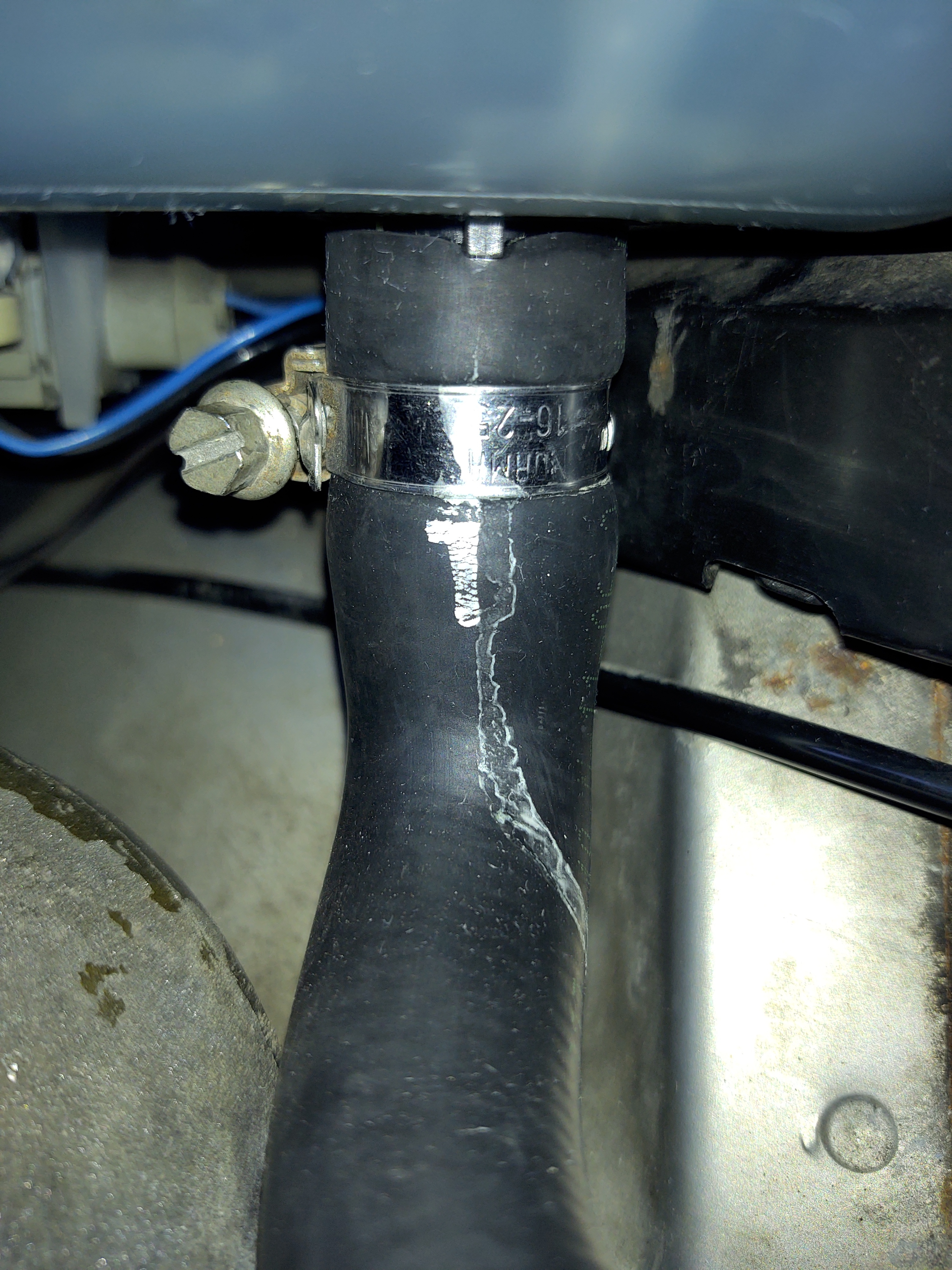

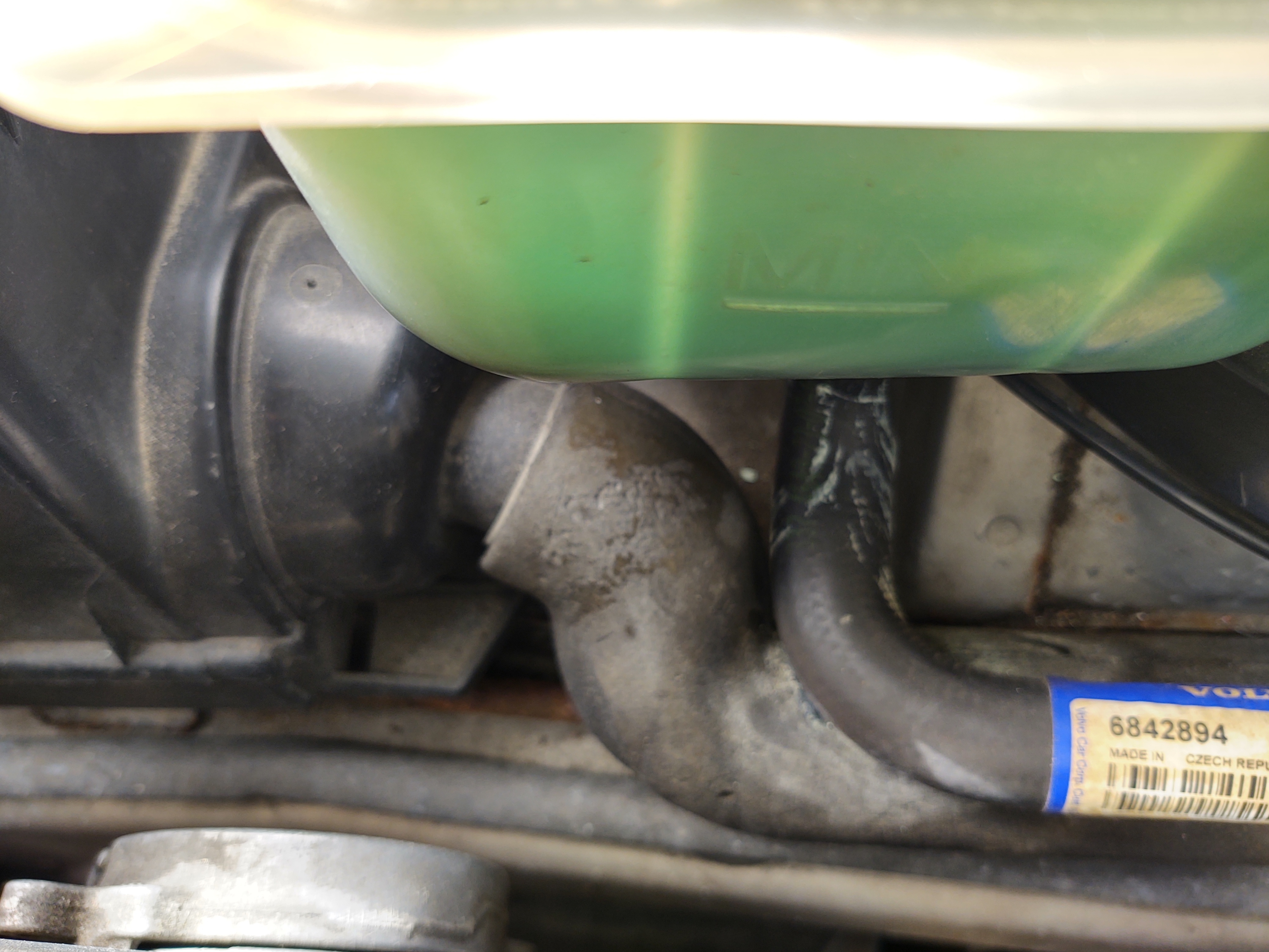

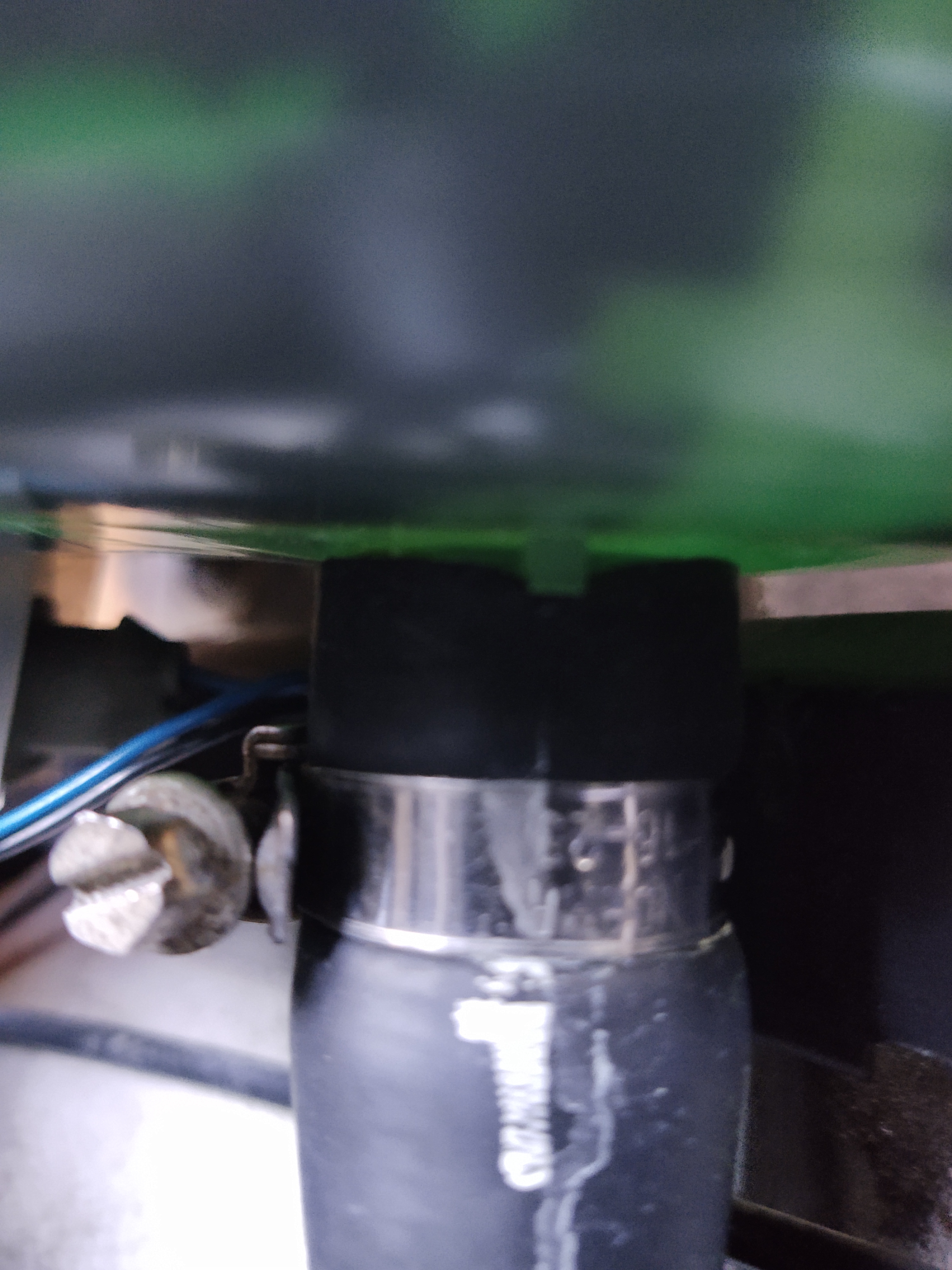

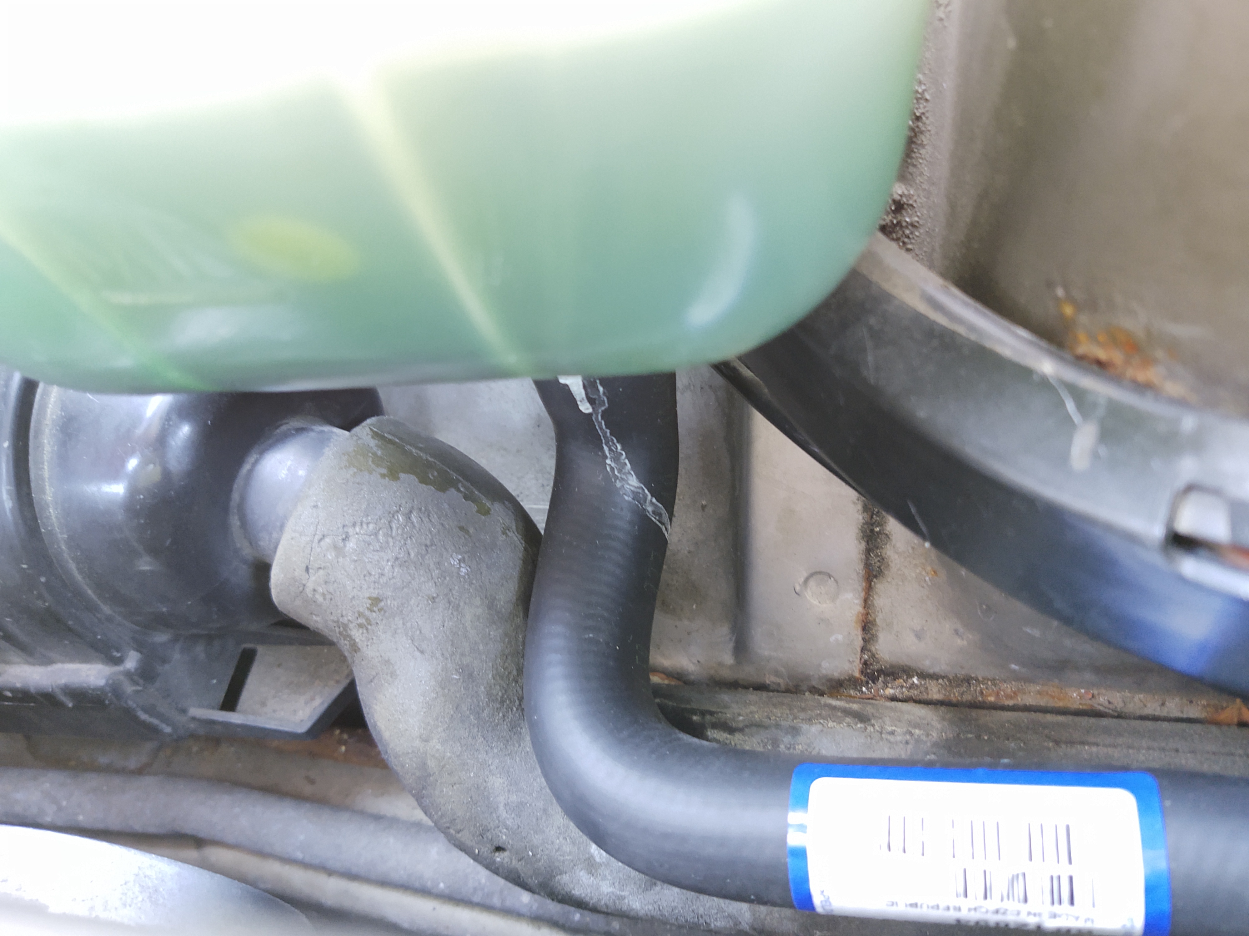

The little hose is "new", less than 6 months old along with the new clamp. Here are some pictures of the area where the leak happens.

Post by scot850 »
Is there a metal sleeve inside the lower hose outlet? It is meant to be there to prevent the plastic hose being squeezed so it is not round. If it is missing, then with that type of clamp it is not possible to get it to seal fully.
Also check it is not leaking from the level sensor.
If all that fails, then there has to be a small crack in the pipe where it meets the main header tank.
You could also see if you can get a different pipe clamp like those used on fuel hoses which clamp more consistently around a hose to prevent leaks.

scot850 wrote: 13 Oct 2021, 16:37 Is there a metal sleeve inside the lower hose outlet? It is meant to be there to prevent the plastic hose being squeezed so it is not round. If it is missing, then with that type of clamp it is not possible to get it to seal fully.
Hi Neil,
Yes, there was a metal sleeve inside the hose outlet. I did not pay attention to it and to check whether it was still round or else.
When I replaced the hose, I did unplug the level sensor but did not remove it from the tank. AFAIK, there was no coolant residue around the level sensor area. I will try to find the fuel hose type clamp to try when the new tank arrive.
Thanks,
Ching-Ho Cheng
