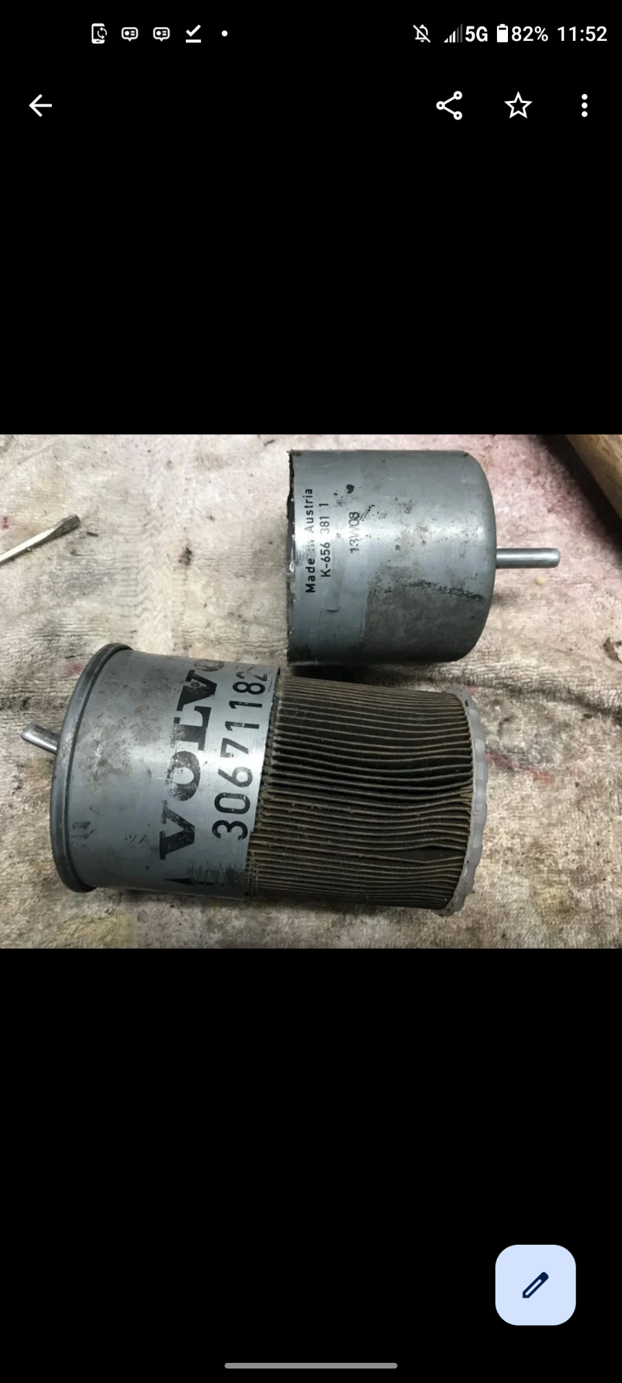

Attached is a photo of a fuel filter cut open.
Sure, one should install it correctly (fuel flows from outer diameter and converges in the center).
But you can see in this case, even if installed wrong, fuel is still filtered anyway.

Thanks for this-- it's good to know mine wasn't completely unprotected with the backwards fuel flow! The fuel that came out of the filter after removal on my 2004 seemed very clean-- on the 2006 it was almost black when pouring out of the input side...

The worst that can happen with that fuel filter mounted backwards is sludge gets trapped in a confined area rather than a large area (center vs. exterior). And also the fine-particle trapping would happen before large-particle trapping, essentially negating the large mesh.
Shorter useful life.
