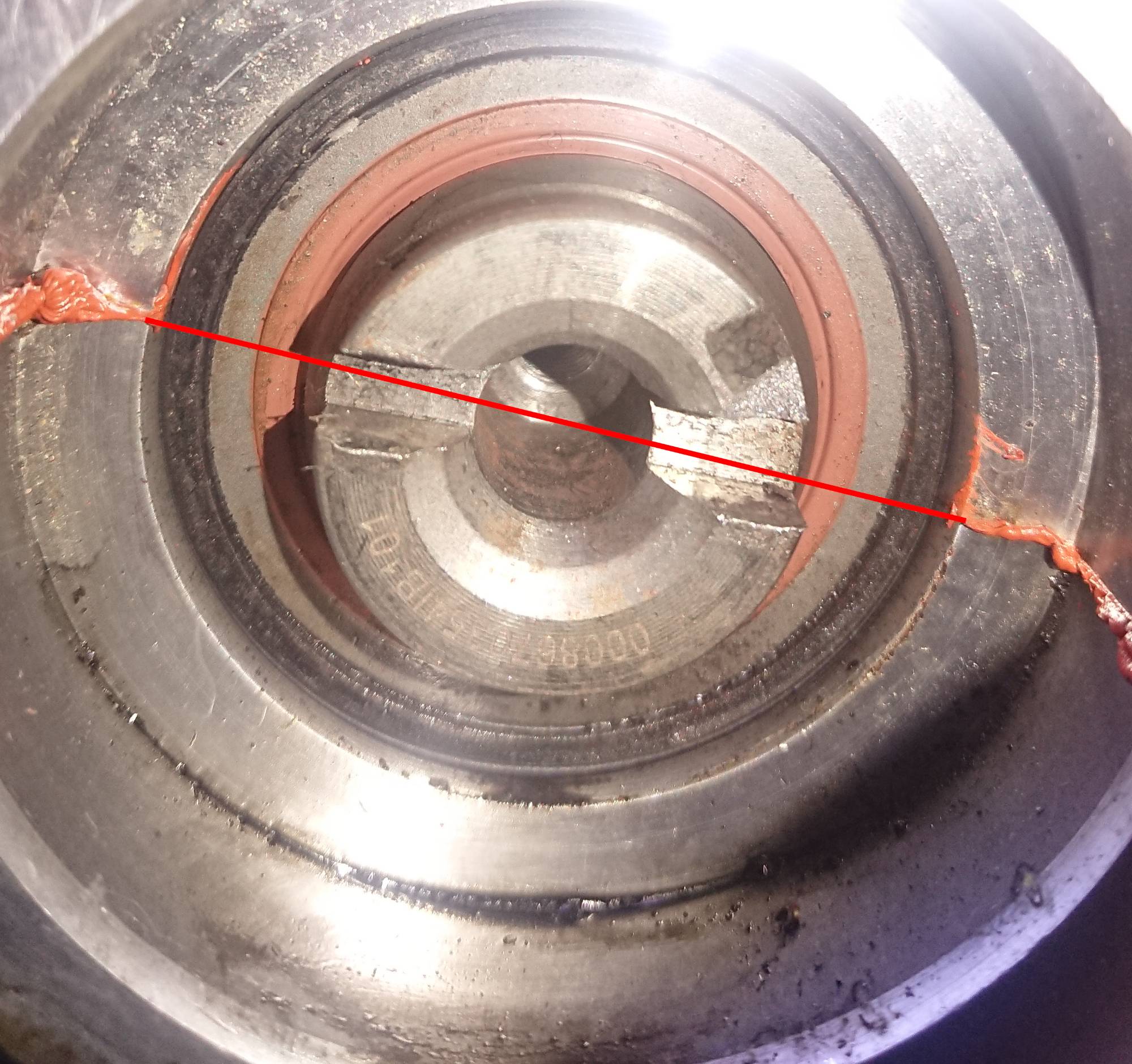

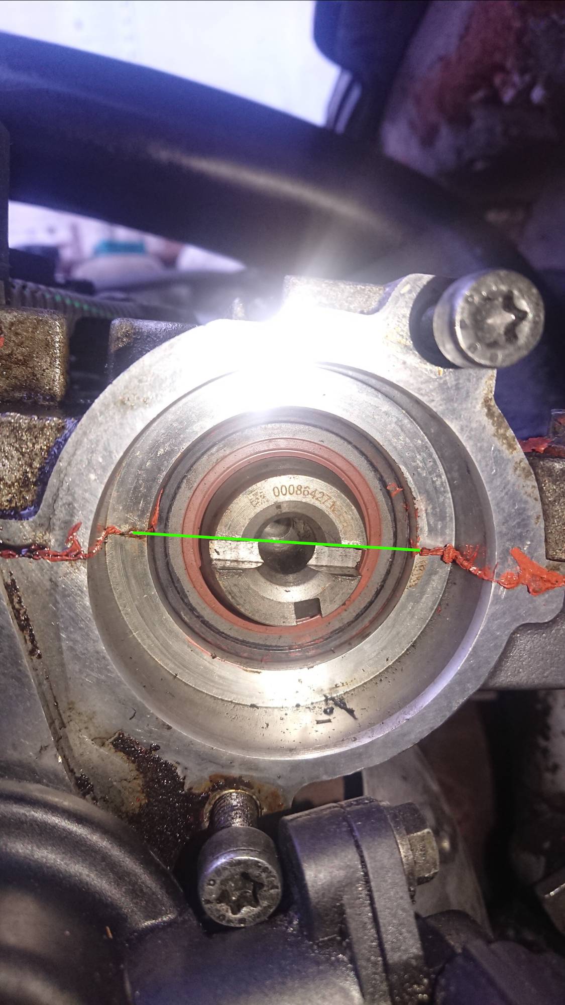

Is this cam timing set correctly?
Post by 777funk »
See pics

That intake needs one more tooth tweak, ccw when viewed from front of engine

Post by 777funk »
abscate wrote: 19 Jan 2025, 01:11 That intake needs one more tooth tweak, ccw when viewed from front of engine
I edited the photo a little bit and it turns out to be about 4.5-5 degrees off. How many degrees is one tooth on the wheel?
Posts: 35267
Has thanked: 1497 times
Been thanked: 3809 times
I think it’s 46 teeth I the cam pulley, so that’s about 8 degrees per tooth. So, one tooth
