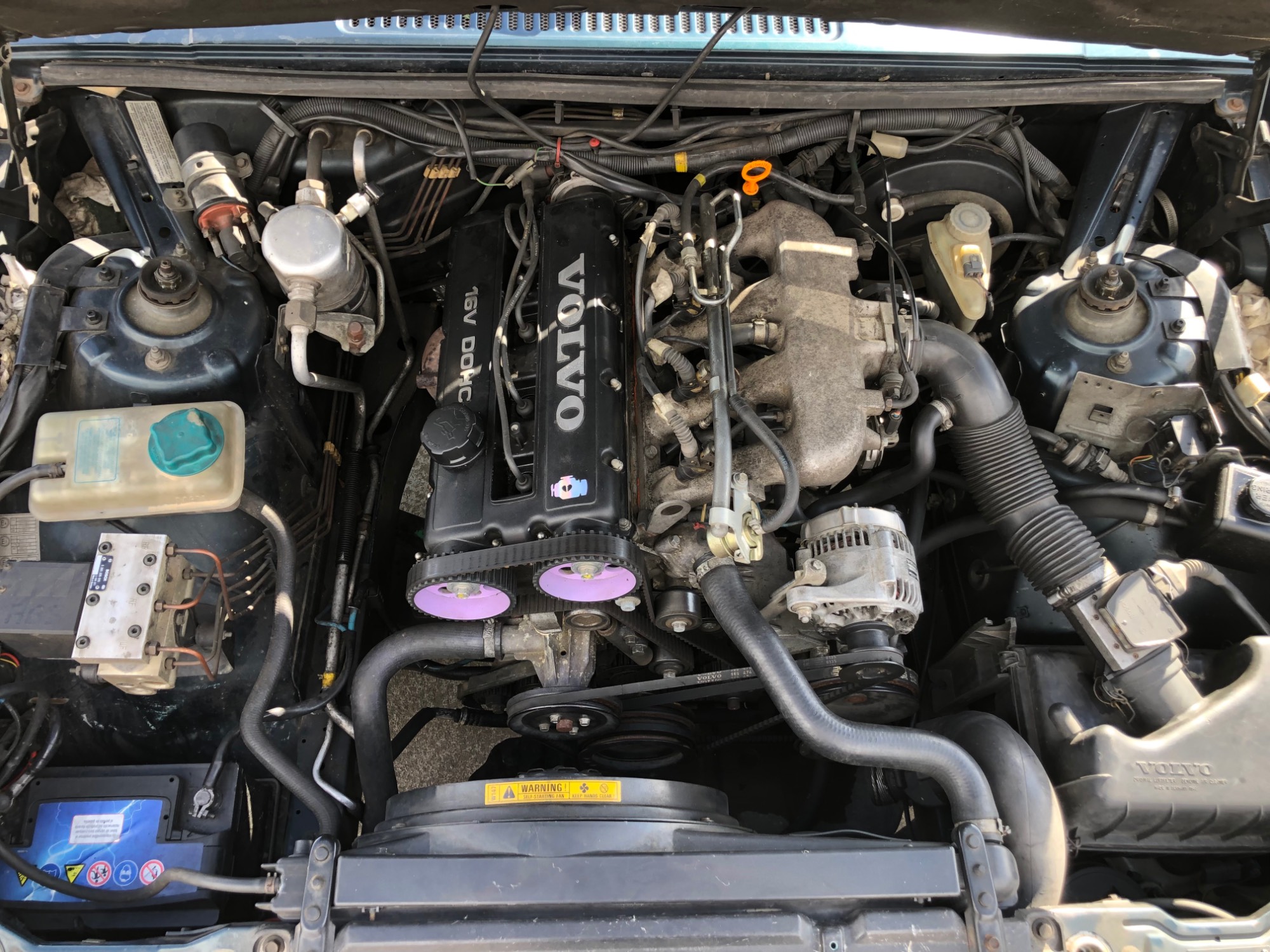

I will, for posterity, upload some photos of what I found in the engine bay. Perhaps I best start a new thread looking for advice on anything glaringly out of place.
In general a pleasing layer of crud everywhere, what my father refers to as "part of the insurance policy". I had been warned on my 240 by my father (mechanic of 40 years experience) NOT to clean out the engine bay to make it sparkle. Ignored his advice one incredibly sunny week when I had very little to do, car looked great for six months in dry Spain before returning to Scotland and salt and two years later... oh my, what have I done!
1992 Volvo 940, B234F

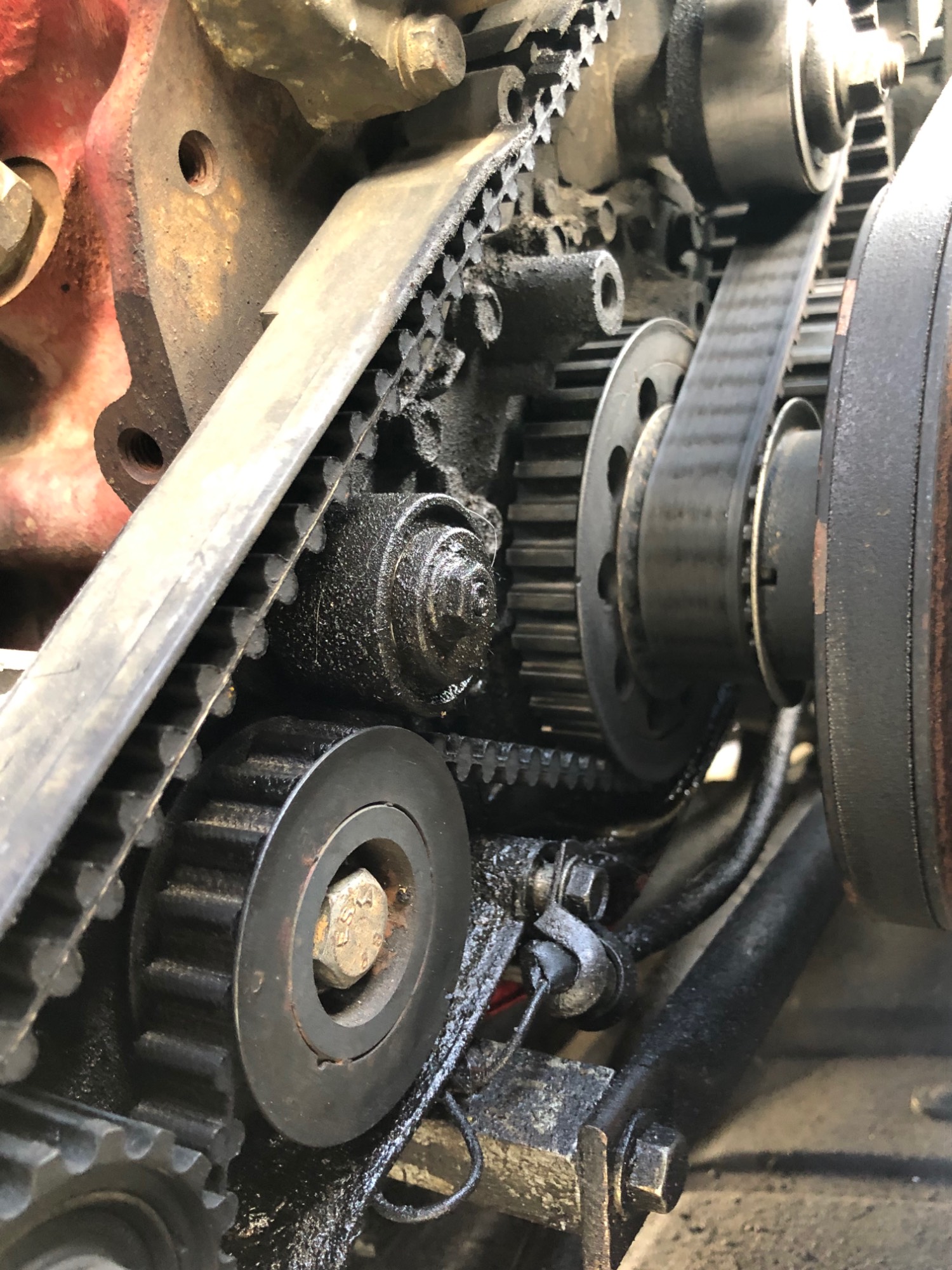

The previous owner, a very young enthusiastic car tinkerer took the freaking cover off the timing belt when he changed it... and then didn't put it back on... for aesthetics?! :oops:
Detailed image of the oily mess inside (what should be) the timing belt casing. Was assured it doesn't go through a drop of oil, since the timing belt change, gasket replacement... but he may have been full of it. Why wouldn't you clean the thing out entirely when doing the job?
1992 Volvo 940, B234F Timing Belt Detail
I do have the case, in bits. Found it in the boot. Minus the bolts I think I will need to reattach it. I will diagnose where that wee leak is coming from, if it is active. Camshaft seal is quite common, is it not? Before buying the bolts I need to reattach the cover. Any ideas?

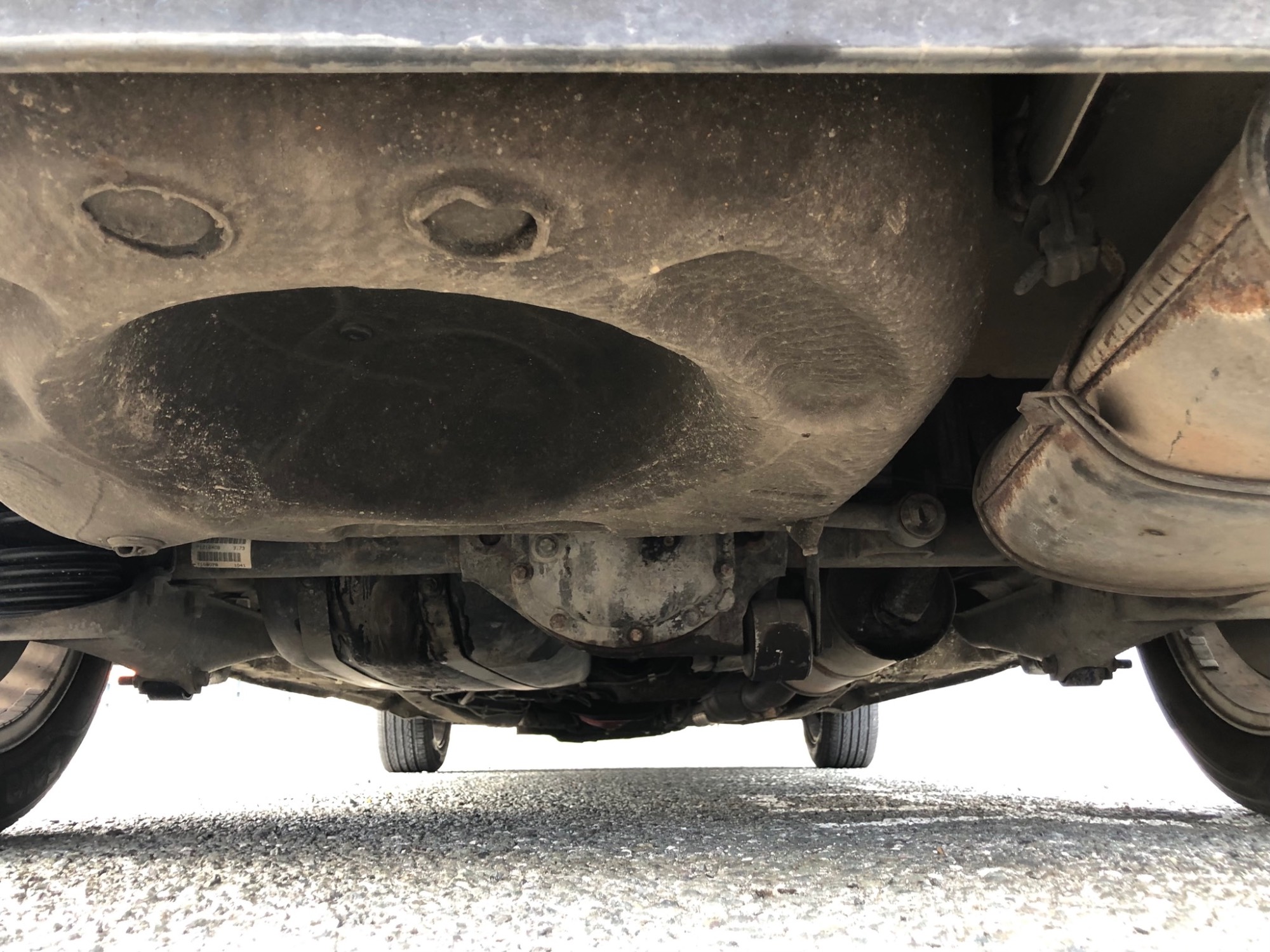

One more absolutely filthy image for you total freaks. Note: car was not sitting quite level at the time.
1992 Volvo 940, B234F Underside
Some work to do!

Yes, but a very good looking position to start from. I always want an 'honest' car if such a thing exists any longer. Ideally with a service history, even if done by the owner. Where we live, I am more concerned if it has had any maintenance by local repair shops as often they don't know or care what they do. I bought one 850 that had s bunch of work done it by the previous owner's local shop. When I went through and compared the notes with reality, they charged him for work that had never been done!! This then added to my repair costs which I was not amused by.
It has been 20 years since I last worked on a RWD Volvo I owned. It was a 89 Volvo 740 Turbo, so similar to the engine you have. It was a good car that the engine had been rebuilt on. Car had been 'clocked'. Engine was rebuilt by a former Rolls Royce mechanic who ran a Volvo specialist repair ship. His young mechanics were amazed the process he went through with plasti-gauge and all. Car ran beautifully once done. I sold it when a wagon became a need and it was not being used.
There should be no major surprises that I recall doing a timing belt was not terrible that I recall. Make sure the breather system is clear or it will cause oil leaks like cam seals, especially at the rear.

I have changed a couple timing belts and a cam seal on 240 red blocks. They are easier than timing belt on white block (5 cylinder) Volvos. The hardest part is removing the fan for access.
I would want to replace the oily timing belt on that engine.
