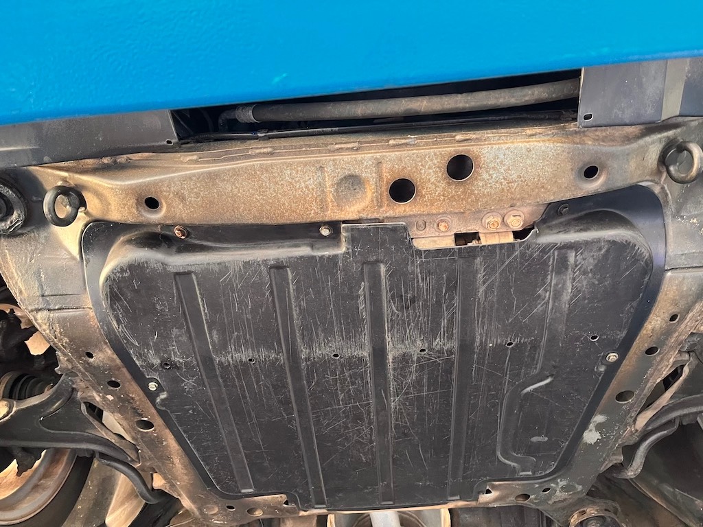

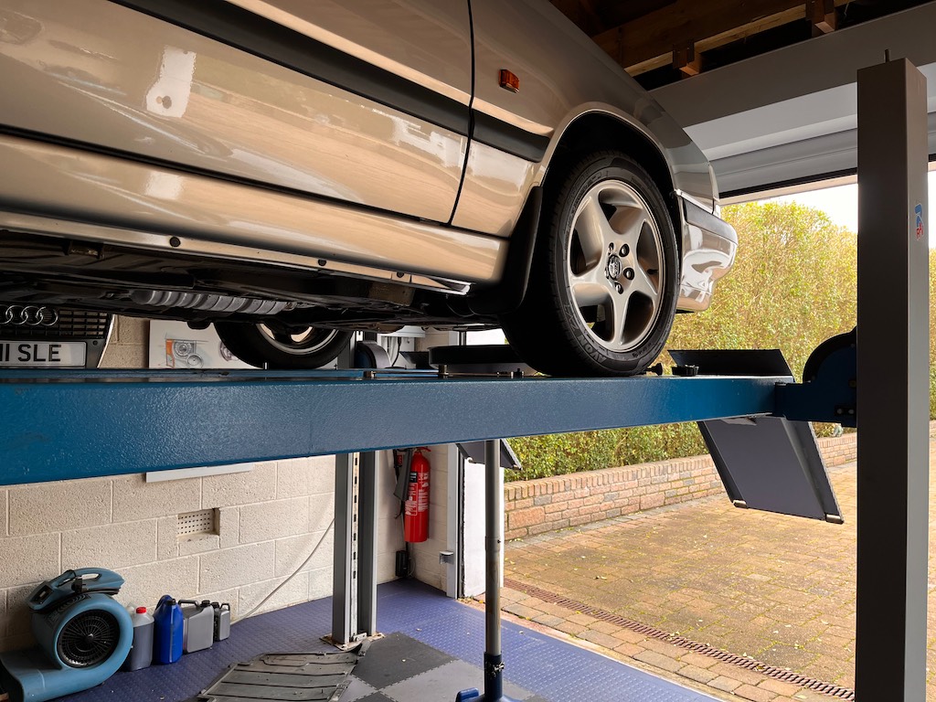

170 days since Val the Volvo was last run and with spring in the air and the weather a little warmer it's time to start getting her ready for the summer ahead. Today I started her for the first time since 19th September last year and she fired straight up. After a few seconds there was a little bit of belt chirp which had gone by the time I drove her out the garage.
I drove her out the garage to let her warm up a bit to allow me to drain the oil
While waiting on the oil warming I checked the A/C was still working
On the ramp and oil draining for an hour before refilling
Filled with Shell Helix Ultra 5W-40 fully synthetic
Along with a new genuine Volvo filter
Checked for any leaks
Engine under tray back on and all buttoned up
Post oil change and sounds the same as before

- jreed
- Posts: 1665
- Joined: 08 Mar 2009, 05:43
- Has thanked: 384 times
- Been thanked: 221 times
Gorgeous car! Thanks for sharing the photos. The paint, wheel, underside all looks beautiful.
