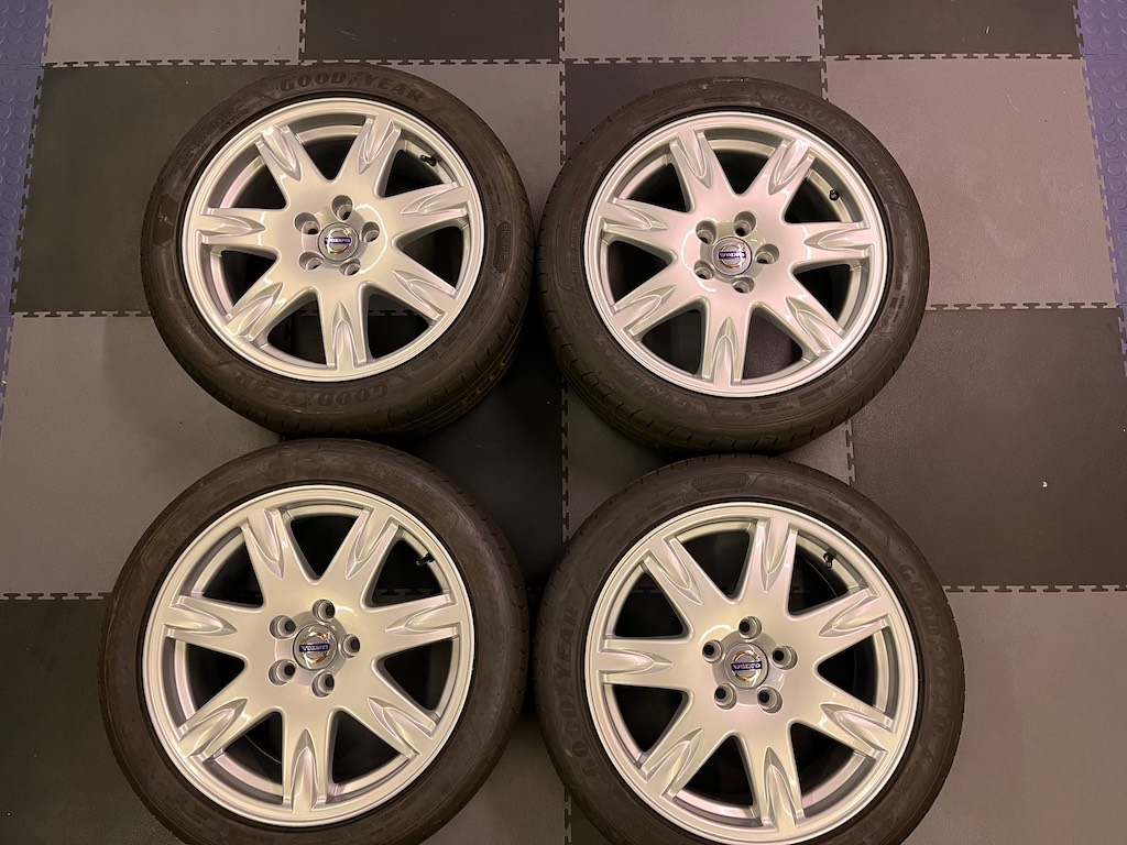

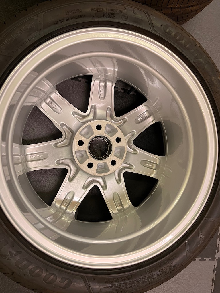

Had my Thor wheels powder coated at the beginning of December and they are sitting waiting on the warmer weather when I change over from my winter wheels. Today I gave the a coat of Gtechniq C5 Wheel Armour in the hope they are a little easier to clean.
