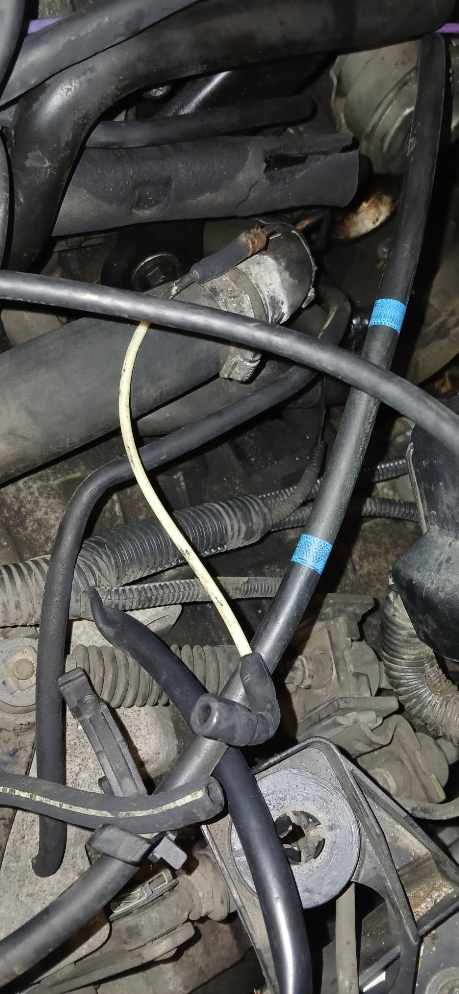

1998 T5, what is this white hose

Goes back to turbo somewhere. I blew through it and it is completely clogged

Too small for turbo boost.
I would guess Fuel pressure regulator vacuum hose or SAS valve vacuum hose. Is there a UFO flying to the rear of your engine?

Ding-ding-ding to Abscate, it's an FPR vacuum hose. Not SAS.
