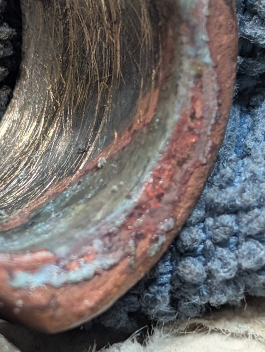

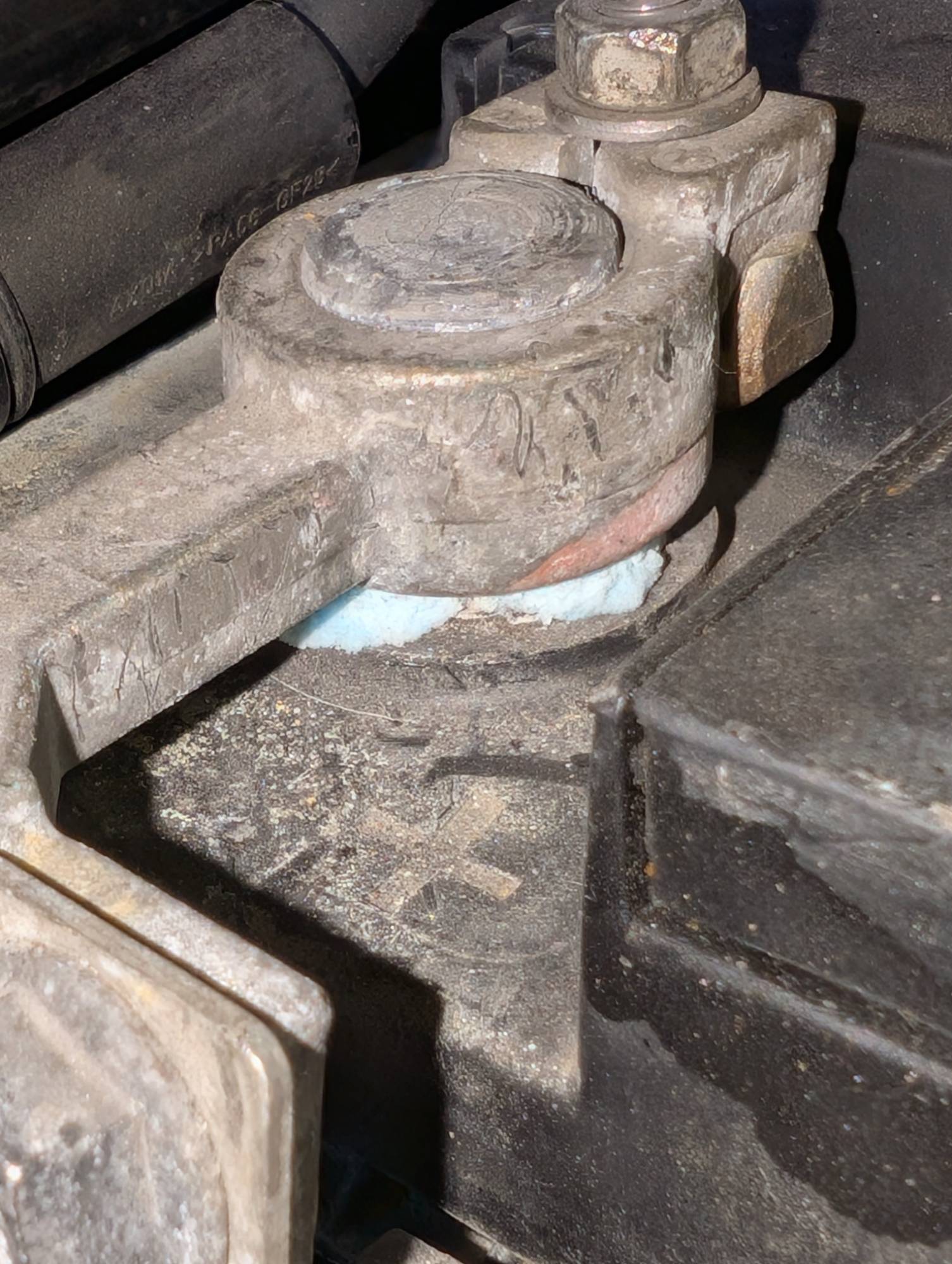

Next onto the +ve terminal. Now this is what the terminal looked like before starting on the car:
I cleaned both the terminal and the battery lead clamp previously using one of those tools with the wire brush internal ring for the post and a round wire brush for the cable end connector. Both looked clean.

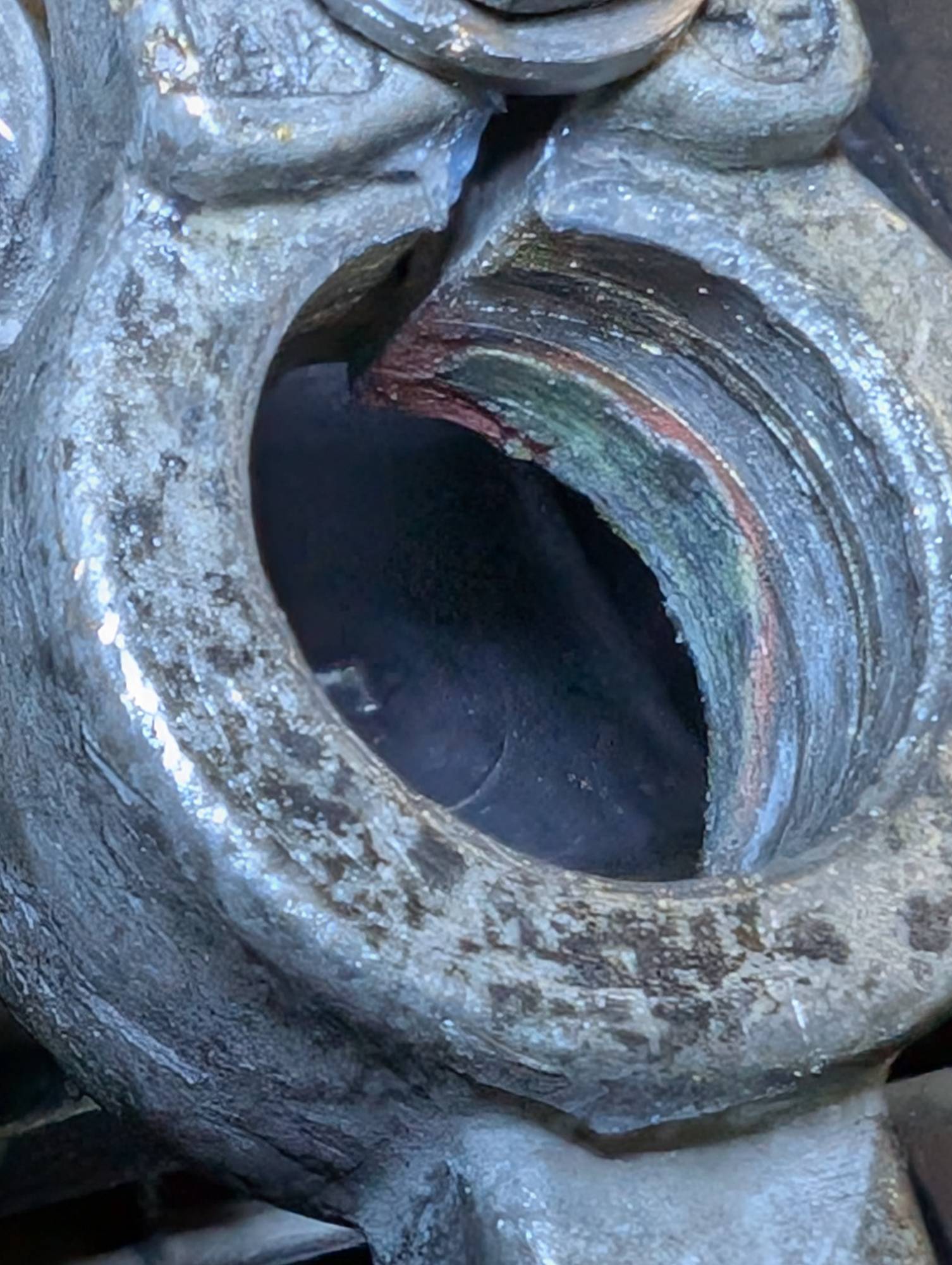

When I removed it this time I immediately noticed a copper colored high point on the post. Sorry, did not get a picture of it. However, looking into the lead clamp I saw this:
Yikes! So I think the battery when it was over heated has caused a lot more corrosion to the clamp internal face on the bottom which I had not noticed. This has caused a high spot possibly which I have made worse by perhaps not having the clamp in it's exact original position. Therefor the terminal may only have been contacting the +ve lead over a small portion. with all that nice insulation of oxide and then the layer of No-Ox-ID, it will likely have caused a poor connection which would mirror what my ears were telling me it felt like. I will now have to try to carefully clean that off and hope it has not compromised the contact footprint of the terminal.
So provided the clamp is not compromised, I will try the No=Ox-ID again and confirm if the issue is better or not.

Well I cleaned all the dirt and corrosion off the battery clamp and it looked terrible. It has been eaten away by battery acid.
I did a mega junkyard visit last Saturday and the one and only P1 (a 2011 S40 T5) had the same shorty battery clamp so it came home for a few dollars. This is what the original looked like part way through cleaning:
It looked even worse after further cleaning to remove the copper oxide. So a replacement as mentioned was substituted after cleaning both terminals and the -ve clamp as well again including terminal cleaner. Decided to try not to use No-Ox-ID on any surfaces as never have up until now to see how it went. Car started immediately and quickly no issues. Much better!
