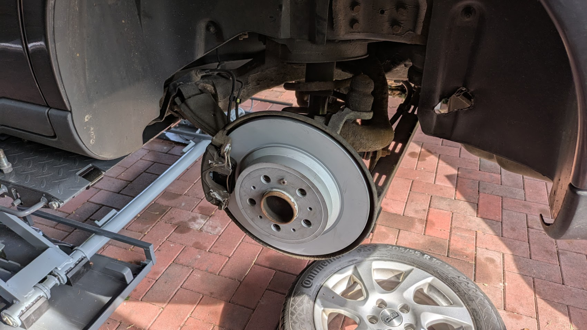

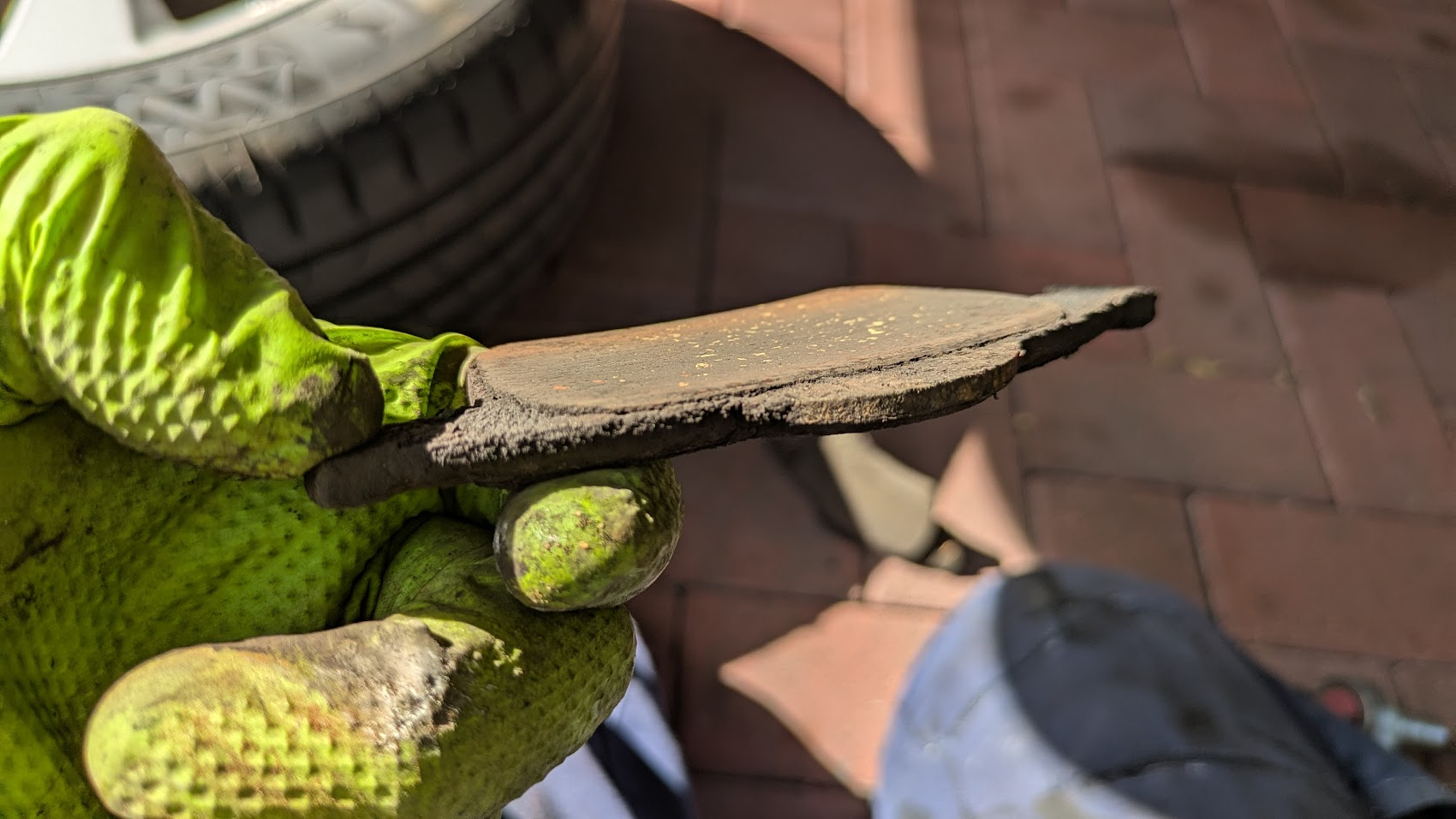

After 2.5 years or 80,000km my rear brakes were due. I think I got my money's worth out of the brake pads
Usually I don't run them THAT far down but I simply forgot that I wanted to replace them when I put the winter wheels on, so it was a bit of a surprise in the spring(ish)
