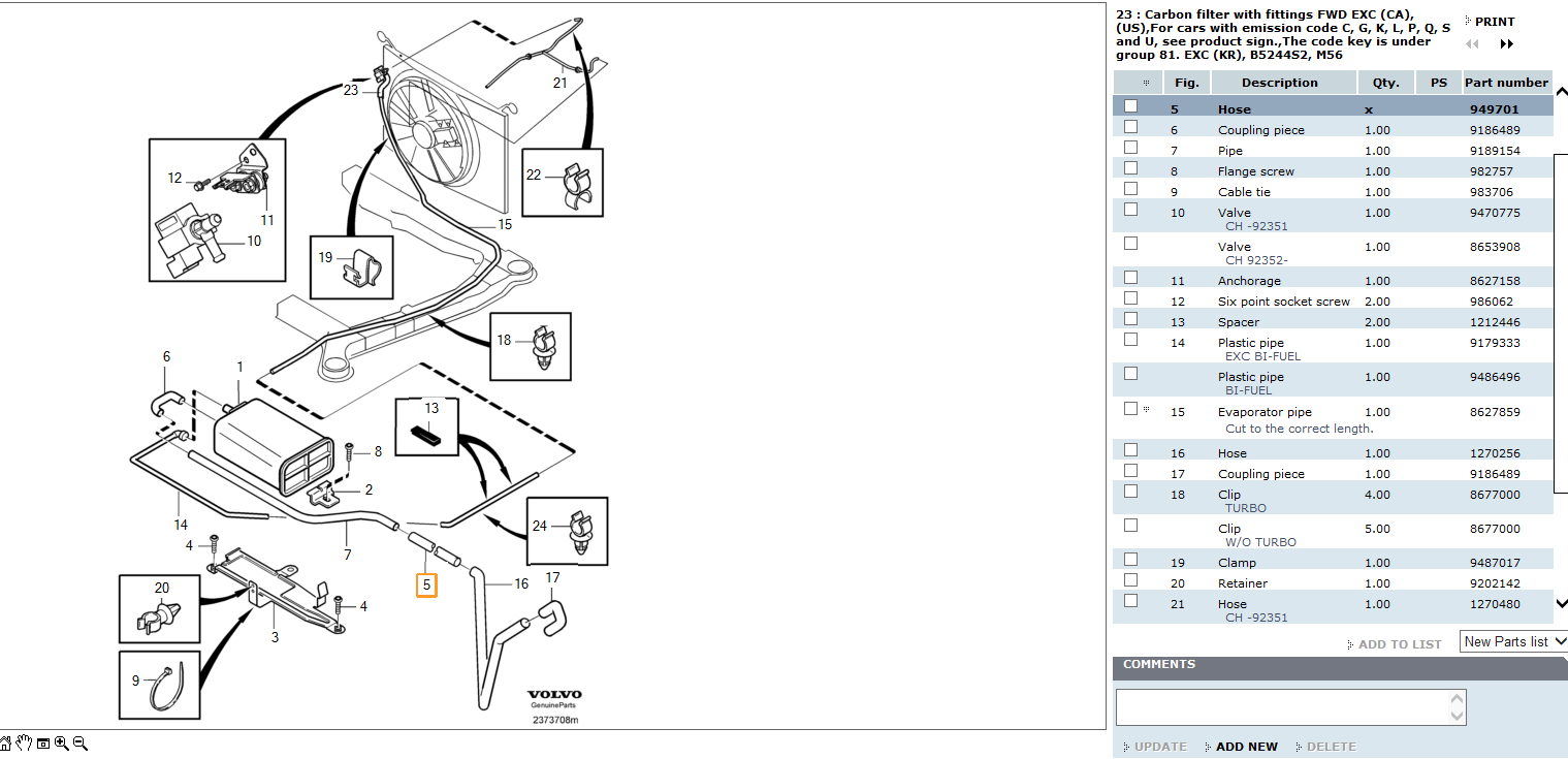

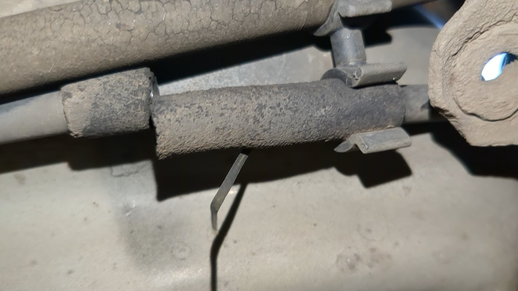

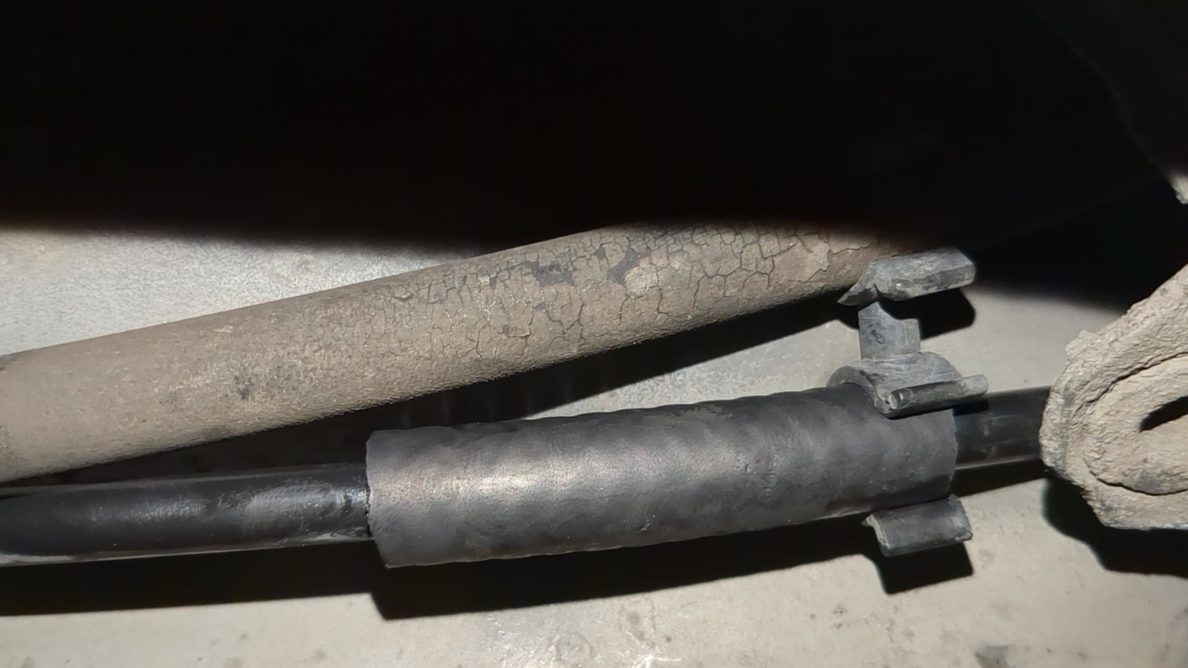

There is also a short piece of rubber hose that connects the tank ventilation hard plastic line coming from the engine compartment to the hard plastic line going to the charcoal canister. On my 2002 S60 that rubber hose completely deteriorated and broke, leading to a gasoline smell (occasionally) and strange noises while idling. You could not hear the noise from the inside though.
The VIDA screenshot is misleading, it's right at the end of the front subframe on the passenger side and the line next to it is a fuel line.
If I remember correctly it's 7.5mm diameter.
Not sure if the later cars and/or US-spec cars also have that piece of rubber hose, but it's worth a shot. Possibly there are other short rubber hose pieces that might be broken.

Worth a check for sure. Not been down into the garage yet to check if there is still a smell of gasoline or not.
