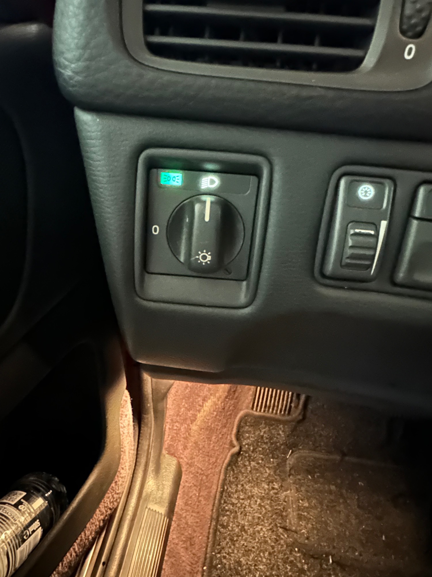

Had to replace my new junkyard found blinker. I was too careless and used too much force whilst pushing the housing back in, which resulted in me breaking the two inner tabs.
Also replaced the dead light bulbs in the headlight switch. Did not know there were two lights! One bulb for the parking lights and one for the head lights.
