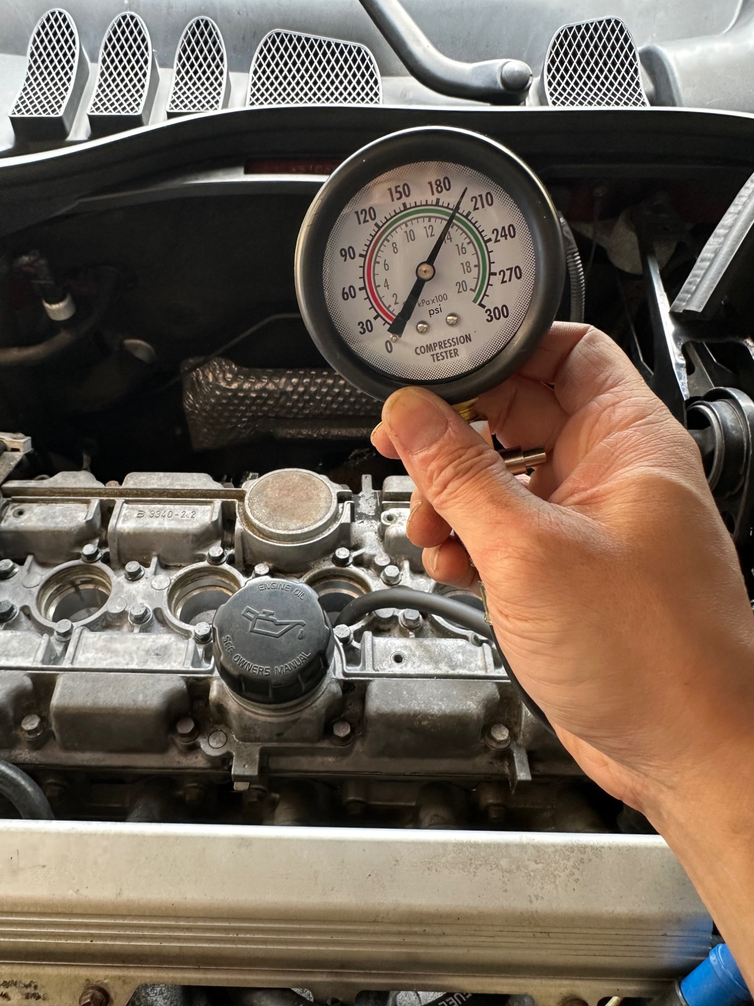

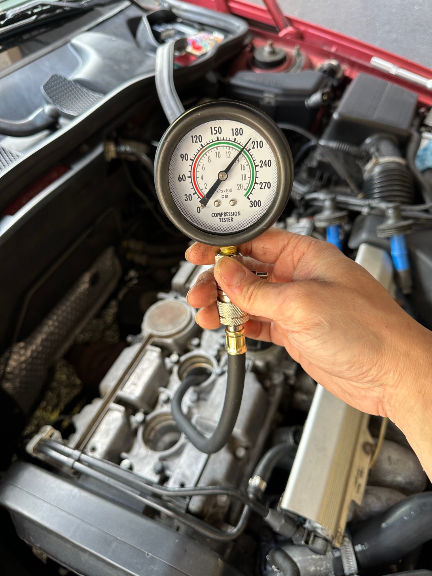

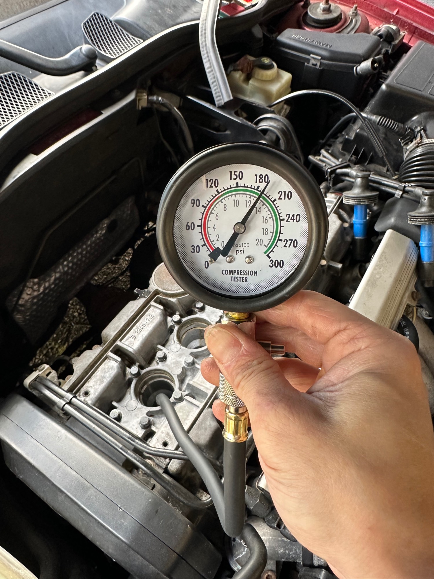

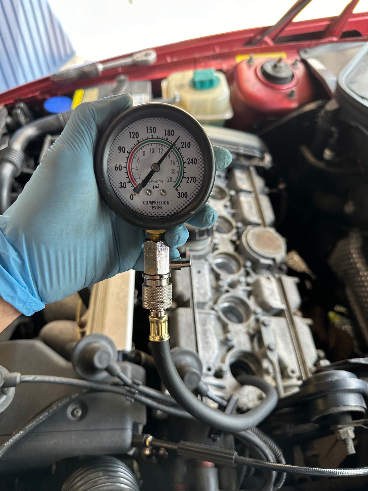

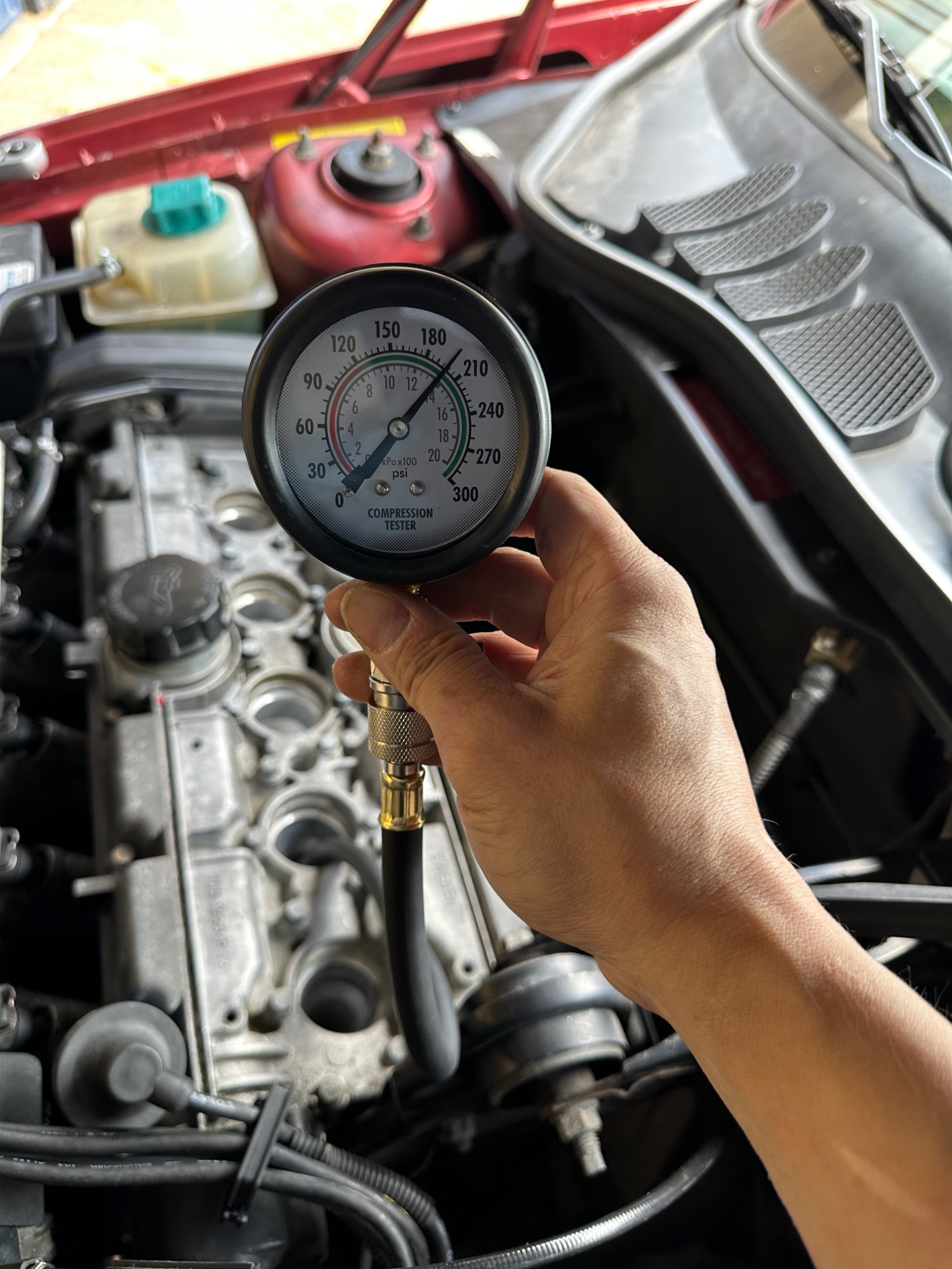

Furthermore, I’ve checked the compression. Seems to be quite ok for an engine with 450k km’s.
To be honest, I should’ve checked this when I just got the car. But the car was running smooth, but still losing coolant after swapping out the faulty heater core.
So I kept postponing the compression test, in case it was real bad news.
I still have to do a leak down test, alas, that’s for another time.

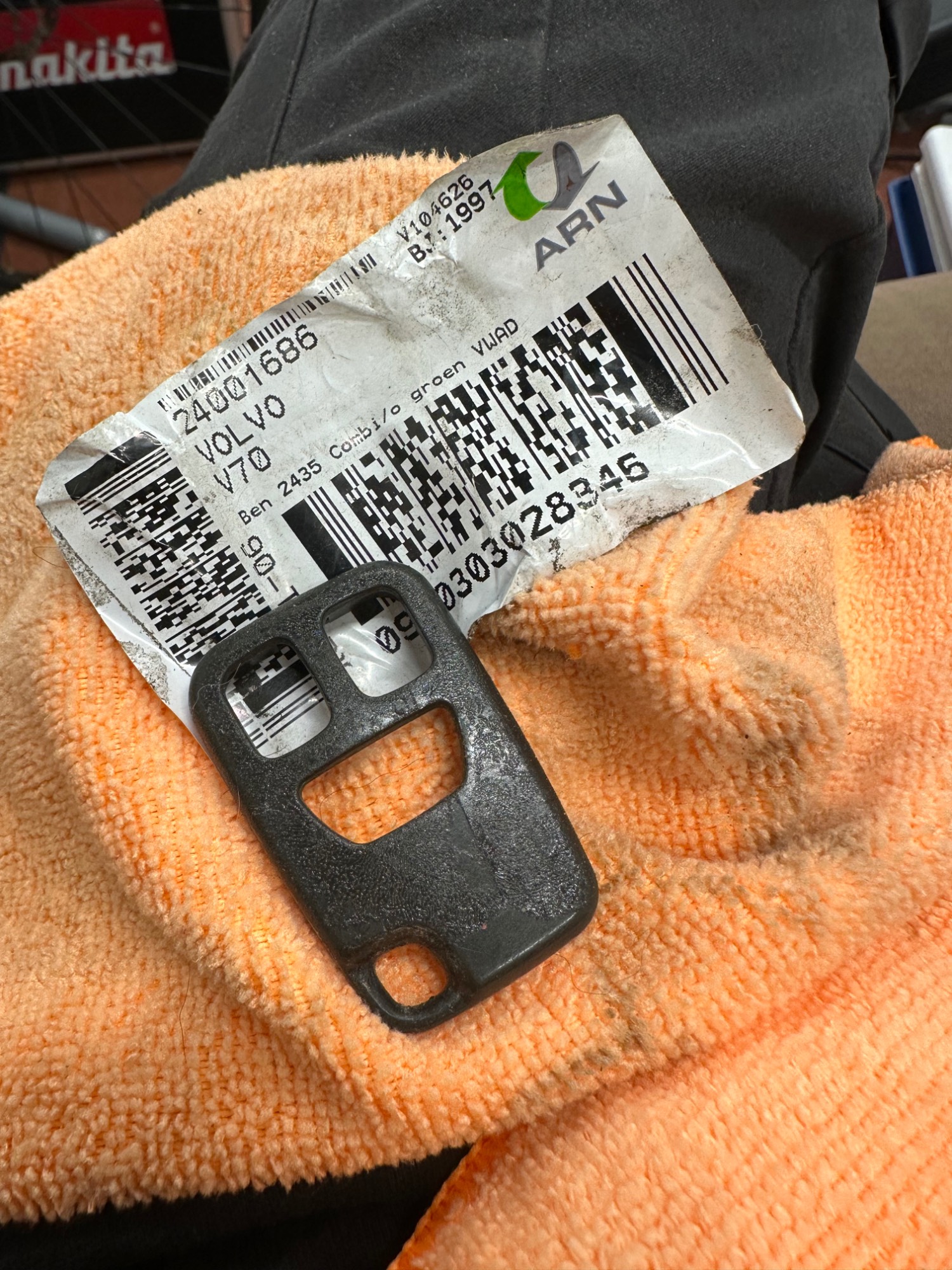

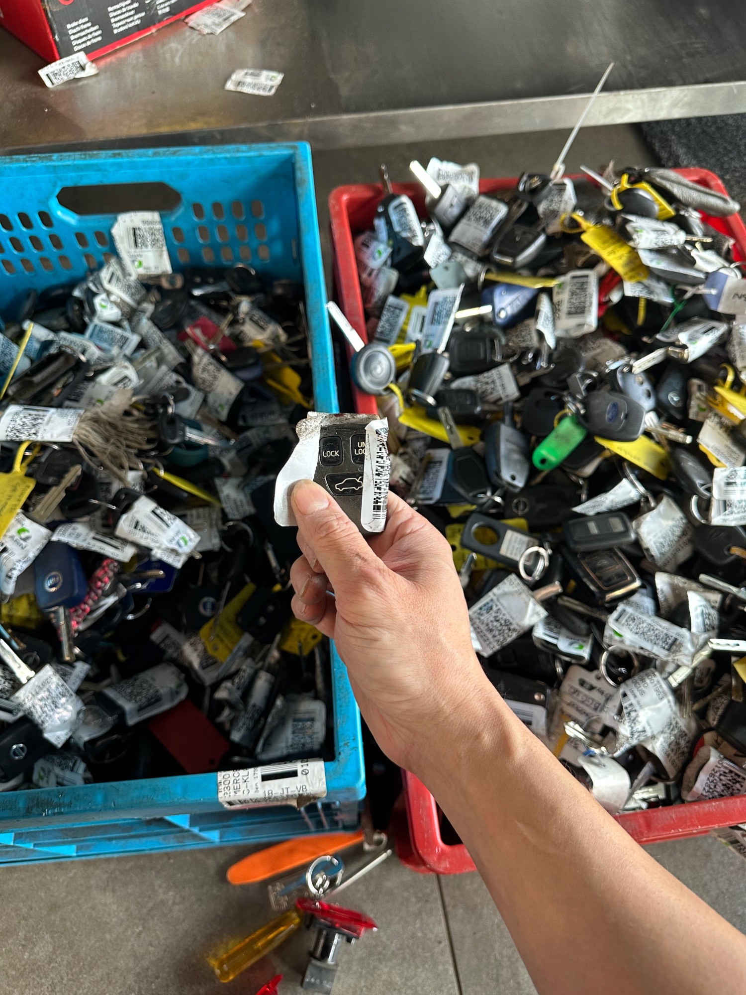

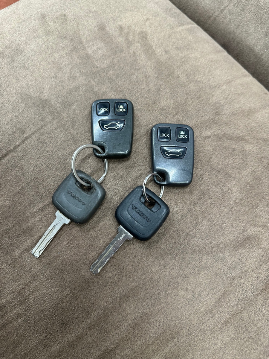

Also, at the pick’n pull where I got the damper motor, I miraculously found ONE used remote amongst a mountain of keys.

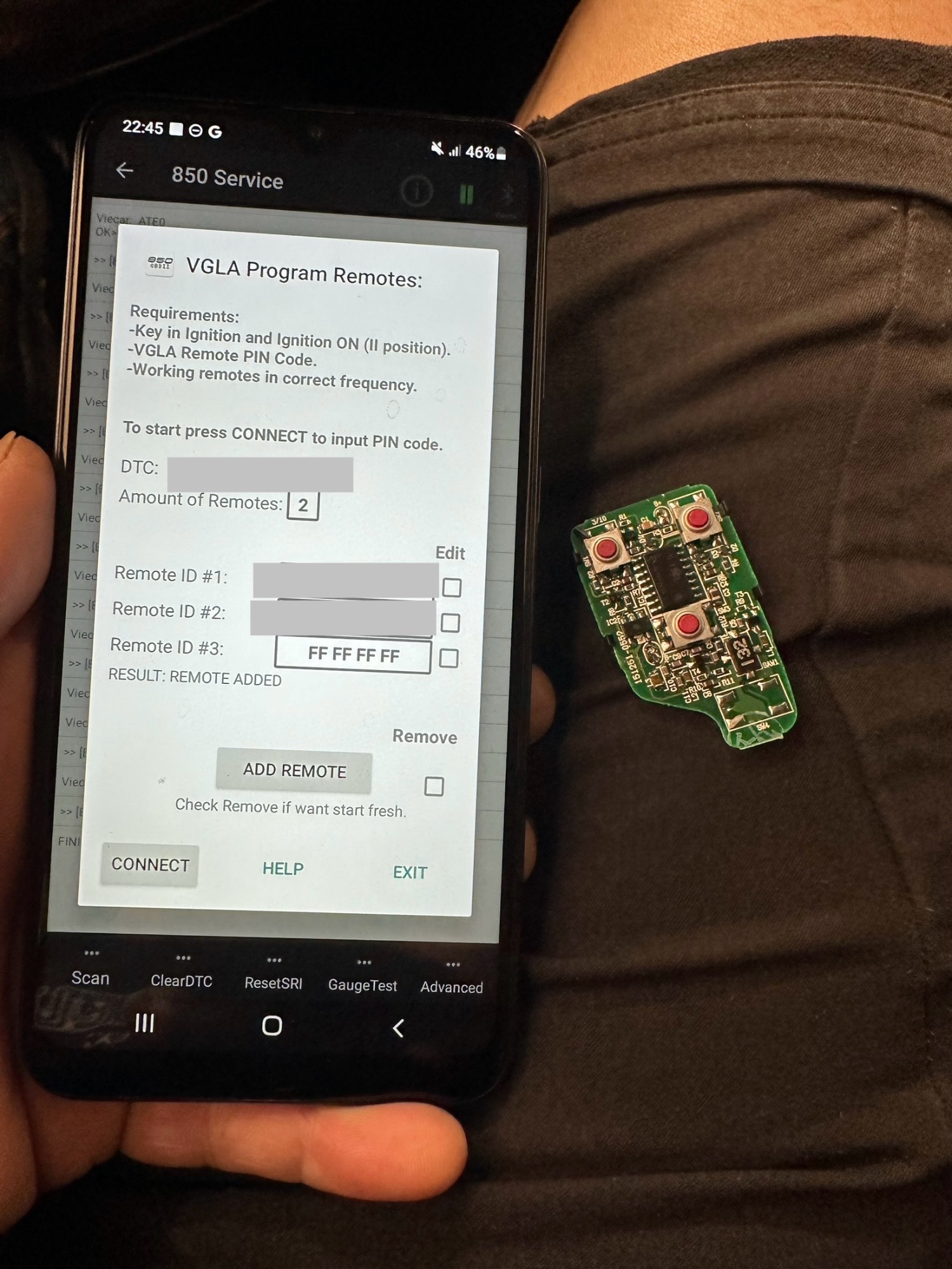

It got a new battery and I retrieved the vgla pin to add the ‘new’ remote to the car.
When it was confirmed that it worked, I cleaned up the sticky shell. The pnp stuck a label around the remote.
