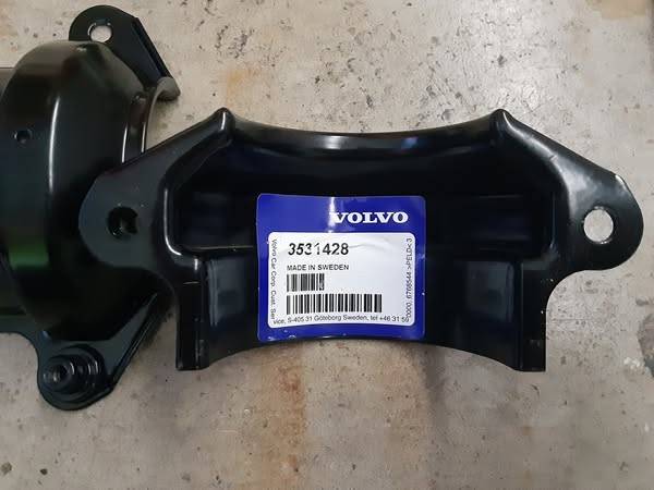

I replaced the filler neck retaining sleeve (both halves) on my 99 S70GLT.
The lower half was almost completely gone.
Each half cost $39 on fcp. Genuine Volvo, no aftermarket available.
The new parts look much less sturdy that the old.
