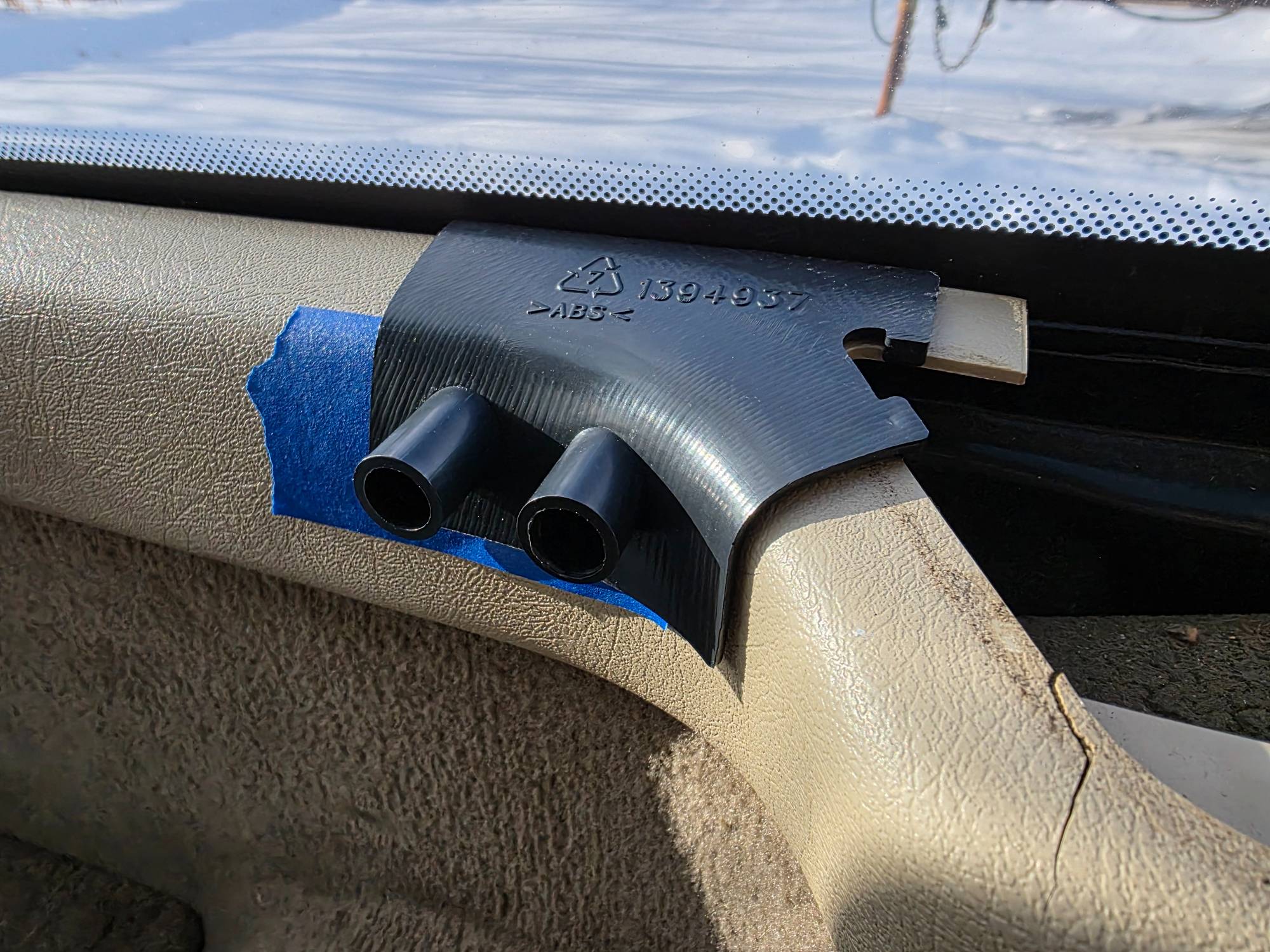

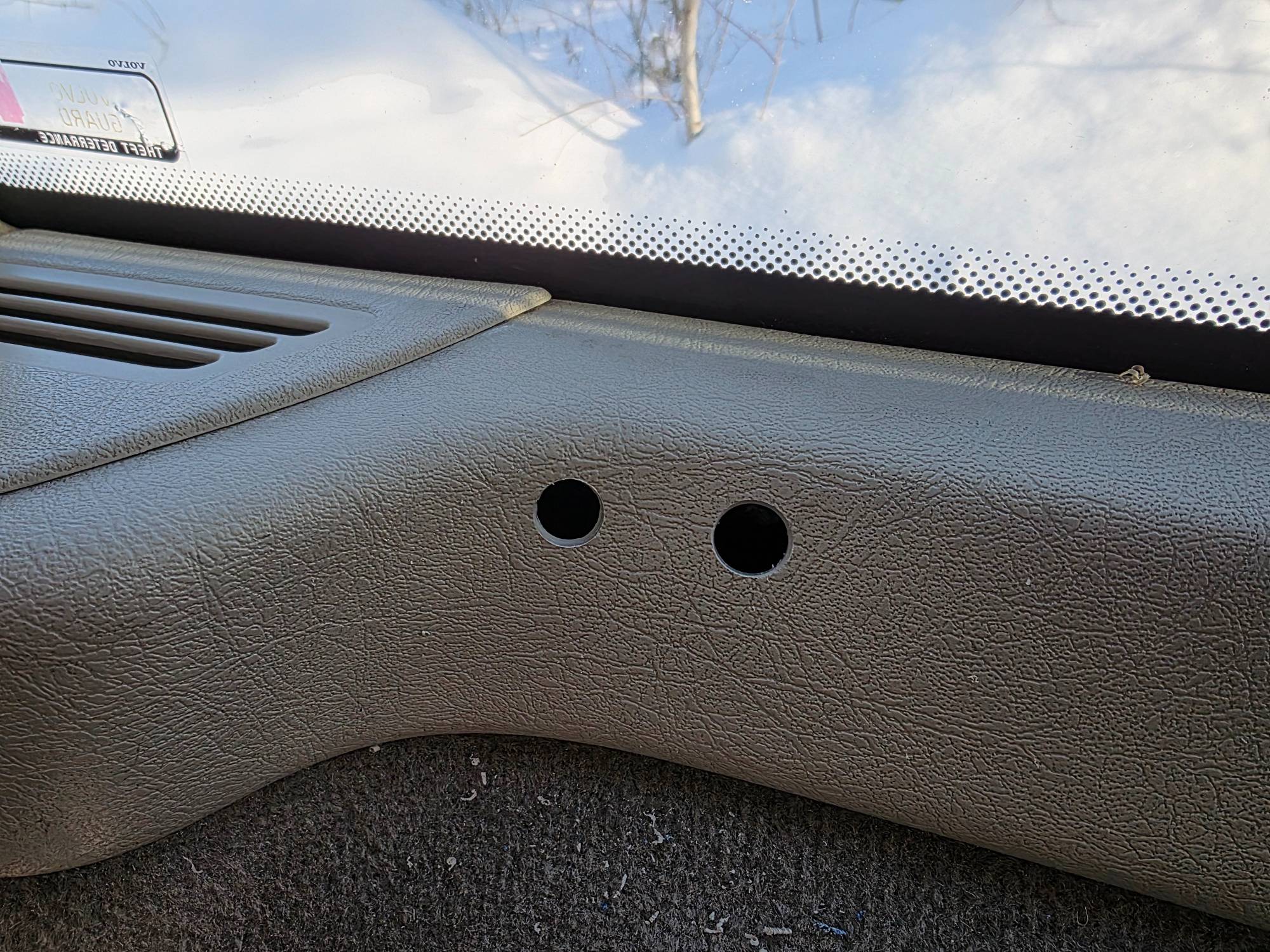

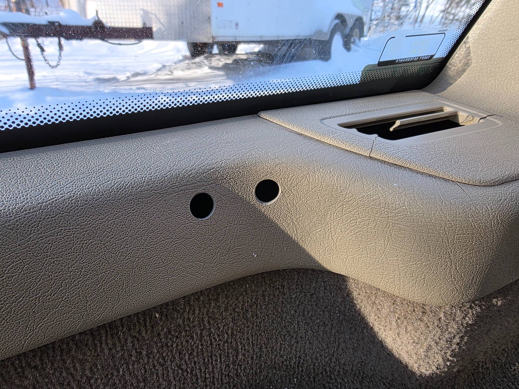

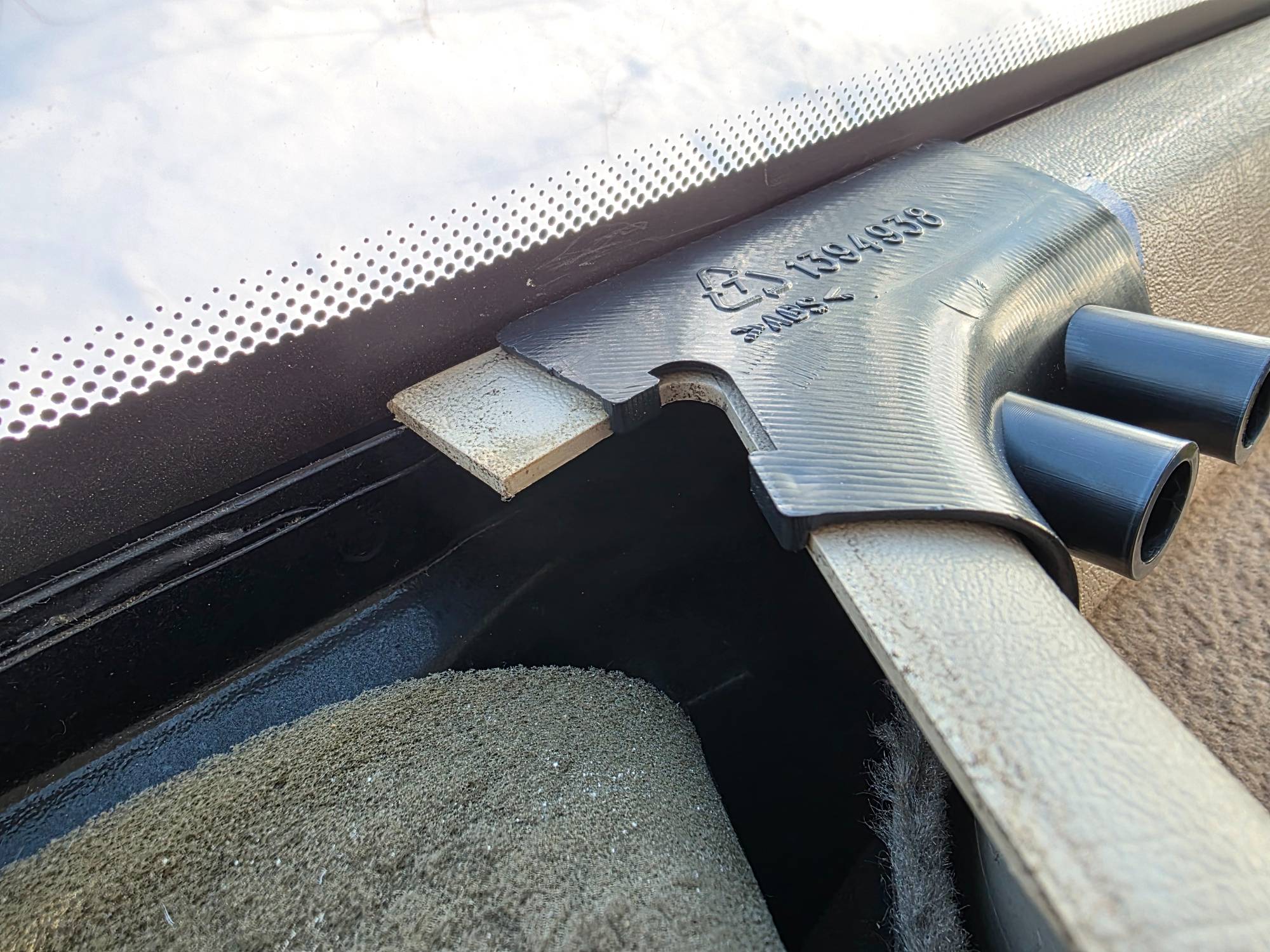

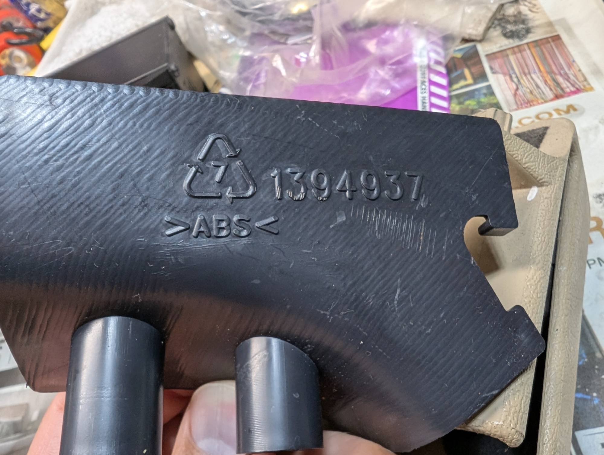

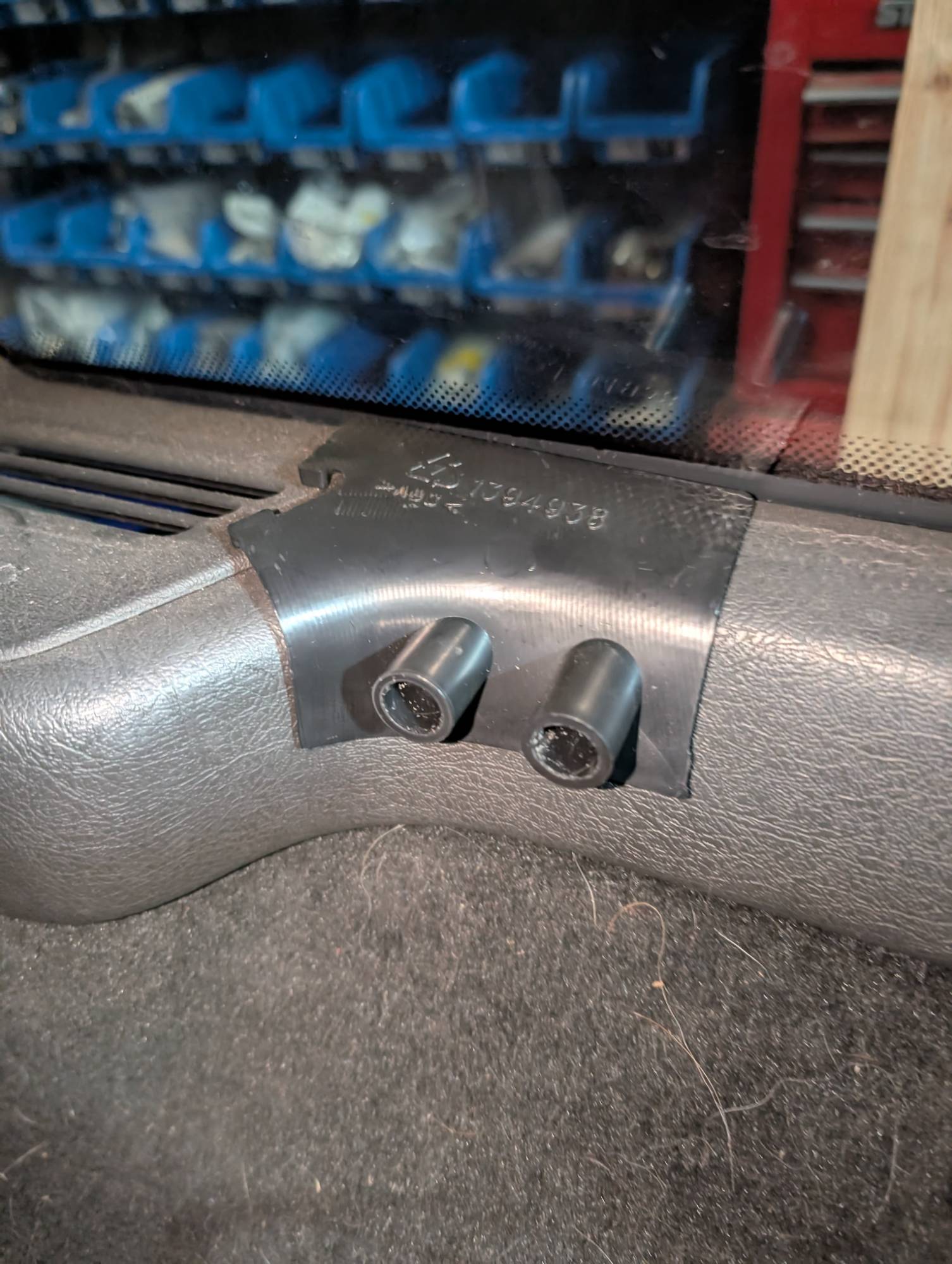

Now that I have returned from vacation, I managed to get hold of my buddy who has the templates. He dropped them off yesterday briefly so I could look at them. I will chase him to get the job done as it should take no more than 10 minutes of access to his car.
Once that is done, as soon as Canada Post decides with the employees if they want to keep their business and jobs and return to work I can send the originals to you so you can see about making a 3D copy. Just did a similar thing with the brackets for the wagon rear hatch spoiler mounts with another MVS member.
Just so you can see how it works:

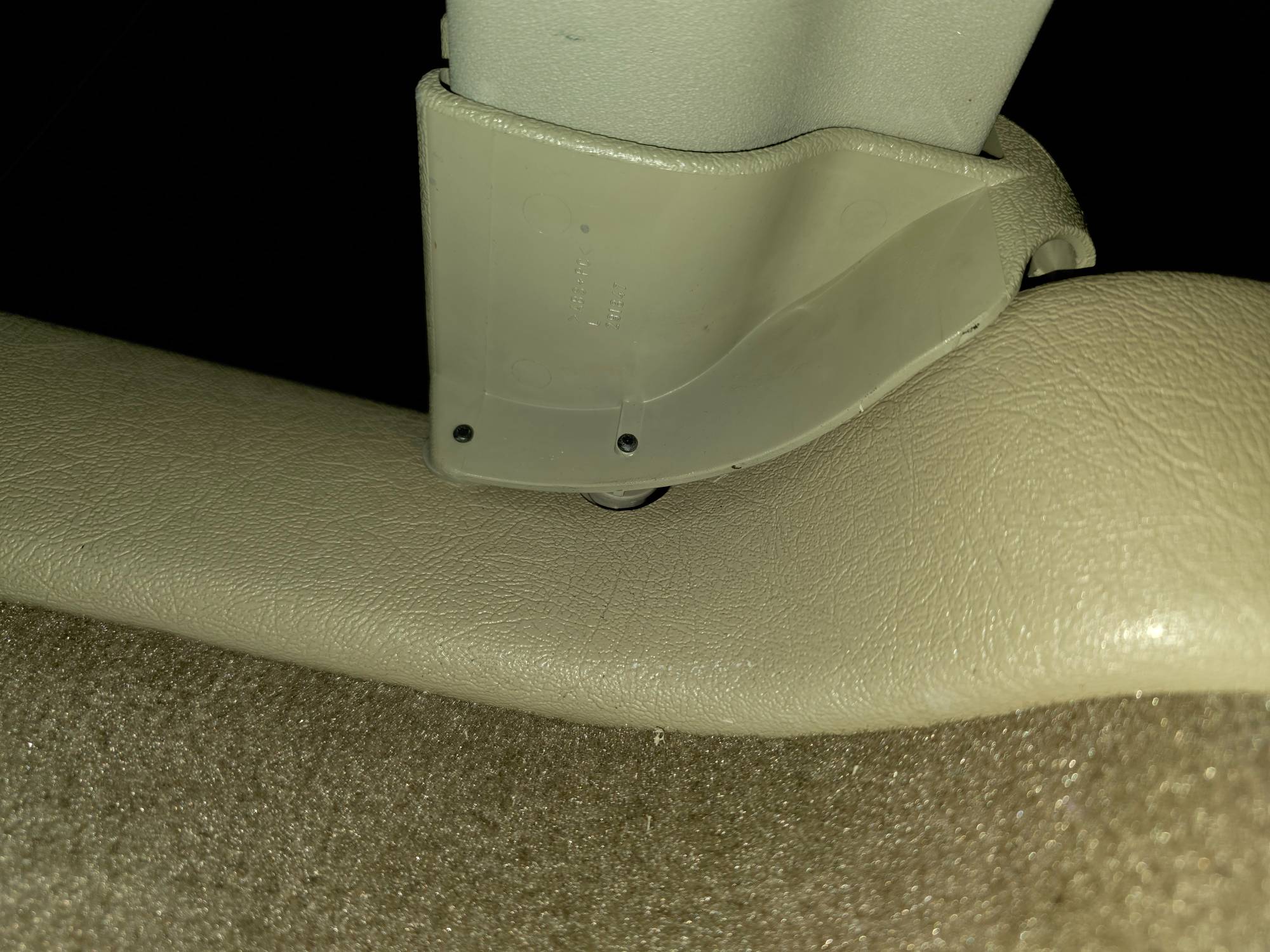

Load cover template (1)

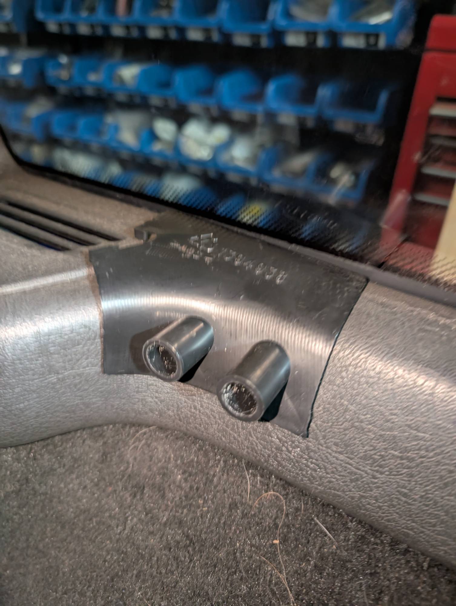

The little tabs on the top end in this picture align with the trim edge when the cover for the rear seat belt is removed. Then drill 2 holes using the template on either side and good to go. There is a LH and RH template as per your picture.

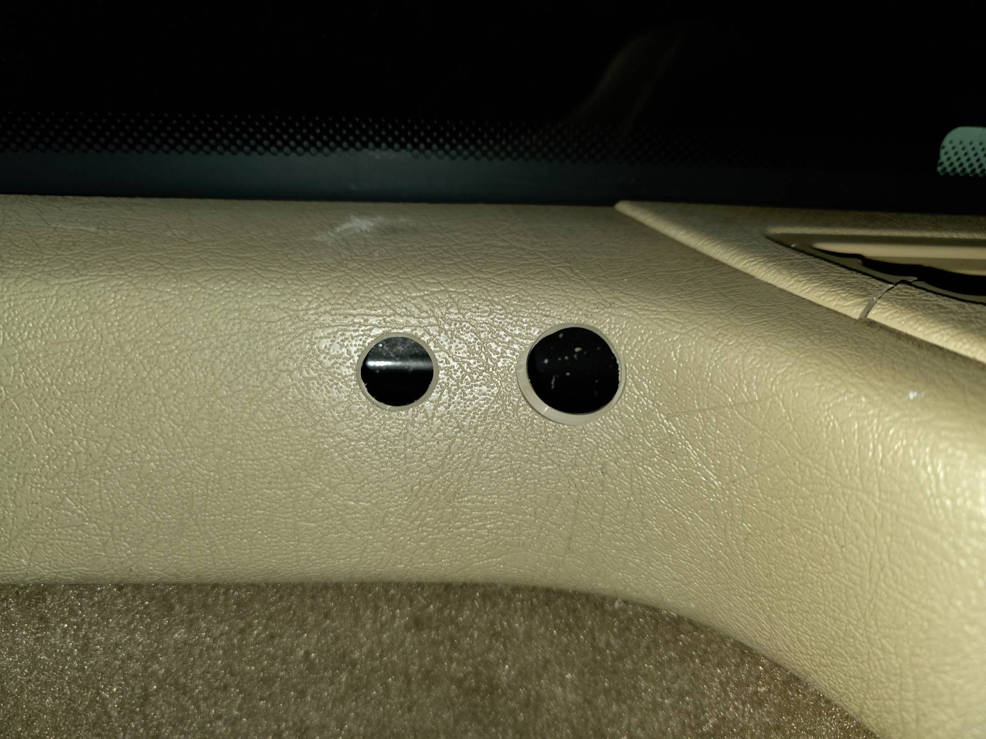

Load cover template (2)

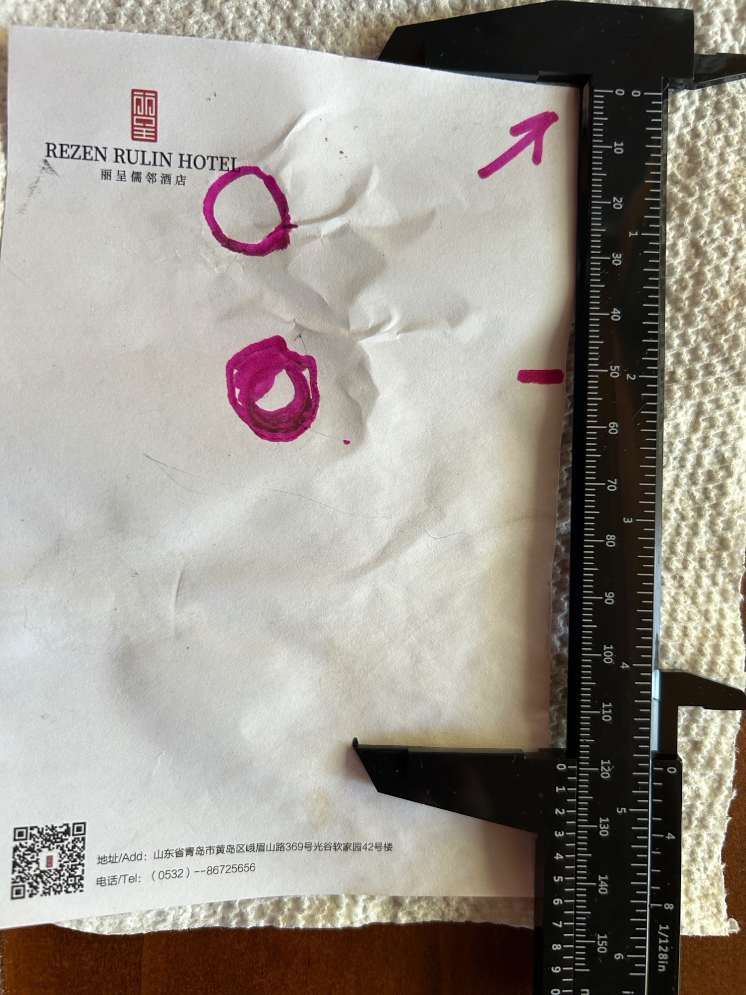

Load cover template (3)
Load cover template (4)

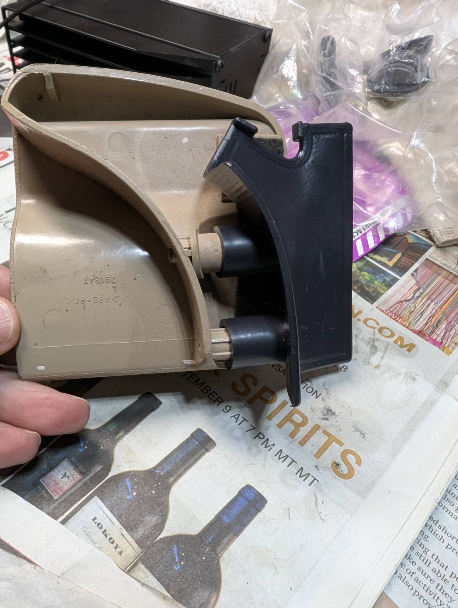

Load cover template (5)
This is our own car, these work fine and were done using measurements from the cover and a paper template. Slowly increasing the hole size until the cover locating pins fit snuggly.

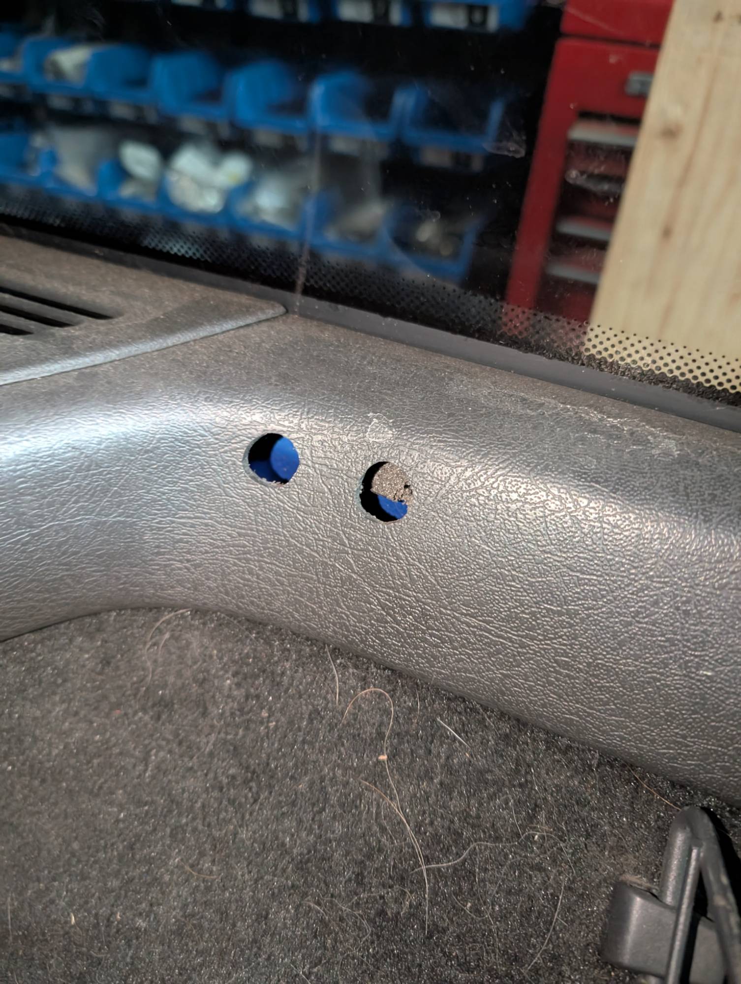

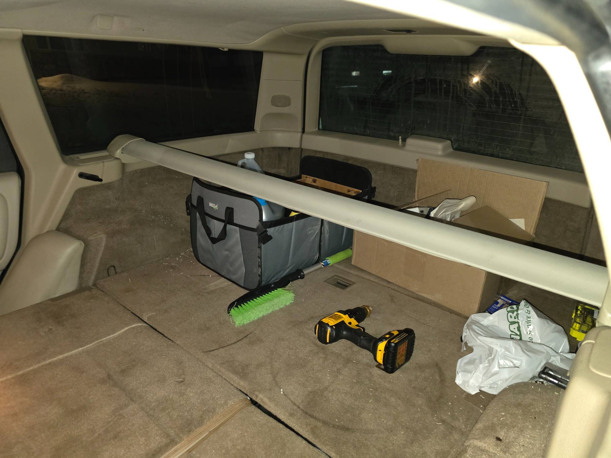

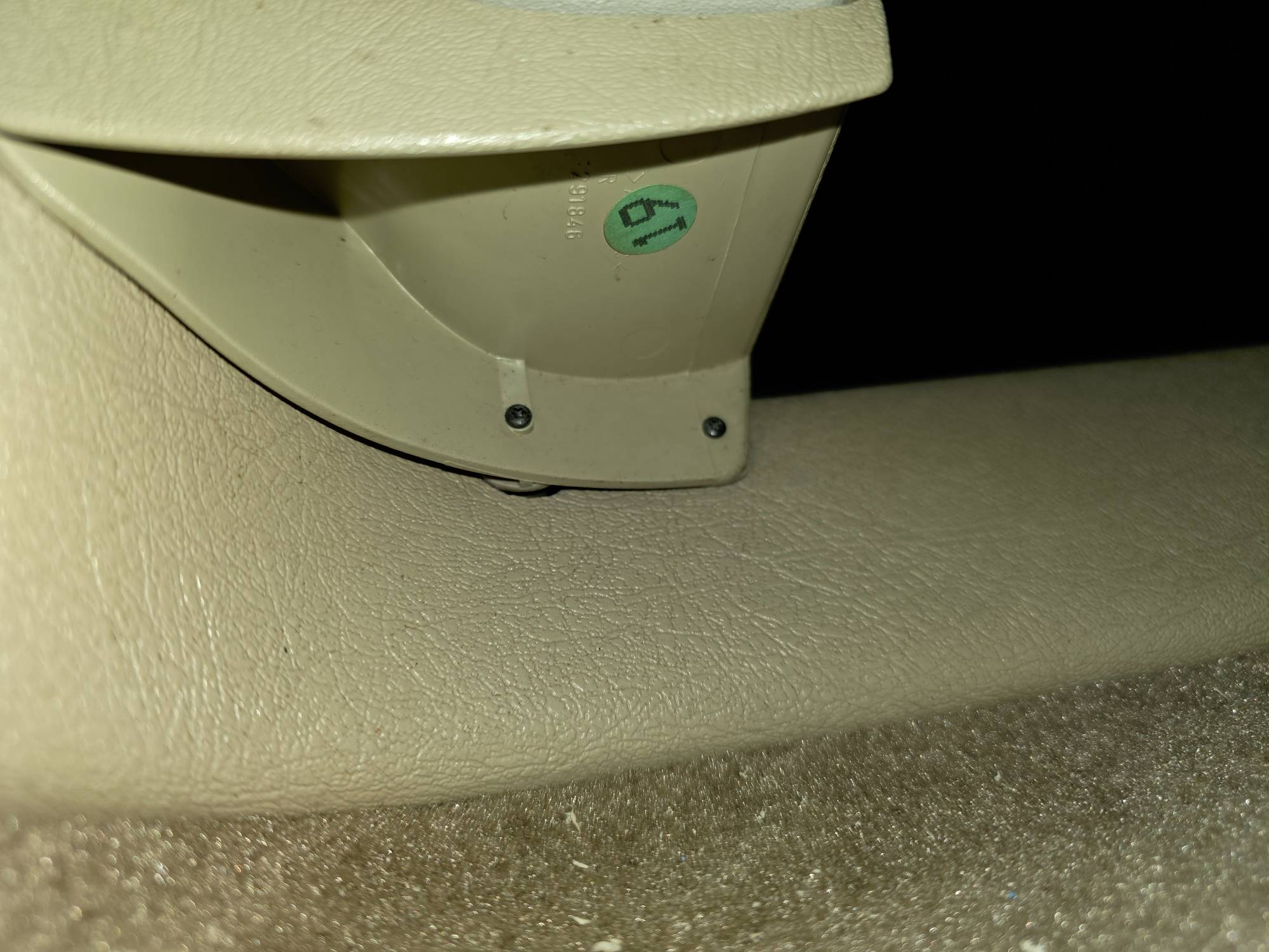

I finally got around to installing the cargo cover! I want to again give a big thanks to RobertDIY for repairing and selling me one of his cargo covers as well as Neil (scot850) for sourcing and sending me the templates he had, which has been very helpful.
The templates require those pieces of trim with the grilles to be removed as the templates hook onto the trim edge underneath it. Be careful removing them as they have become very brittle, I ended up accidentally snapping the drivers side one in half. I used the method Neil discussed with me about using masking tape and a marker to mark the diameter of the holes and the rough center point using the template. I used a step bit to get the holes as close to 1/2 inch as possible. I then used a 1/2 inch drill bit to clean up the holes and get them accurate.
The problem I ran into is that the rubber feet on the cover did not fit in the holes. What I think happened is that over the years the rubber has swelled a bit and became dimensionally larger as a result. The step bits I bought could not go larger than 1/2 inch before bottoming out on the metal panel behind the trim.
Today I drilled out the holes with a wider step bit from work. This allowed the rearmost feet to go in but the forwardmost feet (located on the curve) still would not go in. It appeared that the holes were too close together. What I ended up doing was drilling out the forward holes even wider with the step bit until the cover could go in all the way. It looks a bit uglier like that now but whatever, the trim was already cracked and broken, as long as it works.
The car looks so much more complete to me now, very happy with it. Just gotta vacuum out the shavings and clean the cover up a bit.
