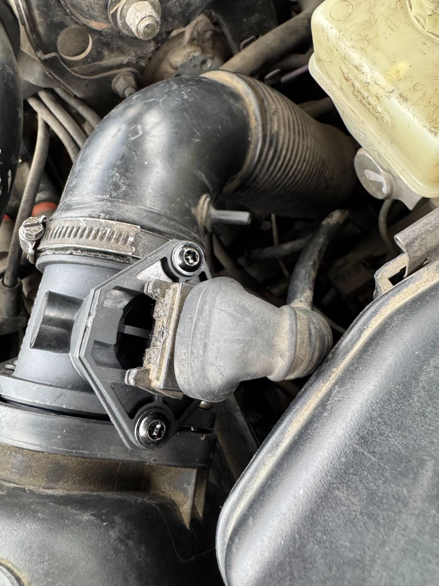

Our car was towed last week; upon picking it up at the tow yard in Denver, it would only move 20 feet before the engine stalled.
I ordered a new MAF from Penguin Parts and installed it, but the same issue with stalling persisted. Two possible issues from
\reading forum posts. Always use a Bosch MAF. There is probably an issue with a vacuum leak, because a hose is missing from
the pipe downstream from the MAF, as shown it a picture. The underside picture of the engine doesn't show any obvious destinations for where to attach the missing hose. If someone has a suggestion, I'm open to it. Just in case the open port is a problem I can try buying a cover for it.

Look under hood on the right side for a sticker with the vacuum hose routing. They vary between models amd engines in a given year, so you need your diagram. That might be the fuel pressure regulator vacuum supply, needed
- Posts: 11912
- Joined: 25 Jul 2009, 14:03
- Has thanked: 311 times
- Been thanked: 817 times
Yes it goes to the fuel pressure regulator but check your sticker to be sure.
See bullet point #3 in this post: viewtopic.php?t=63615
