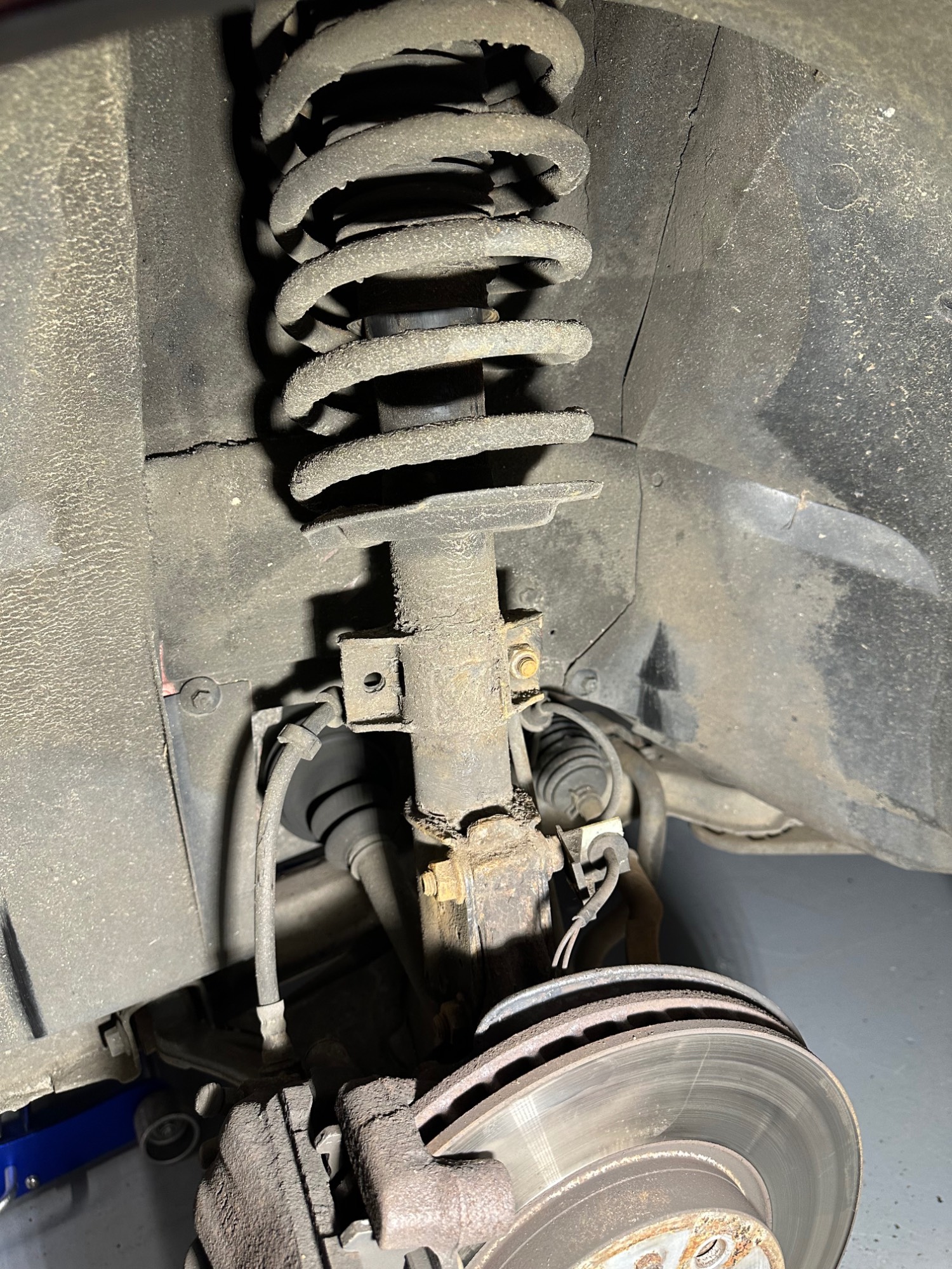

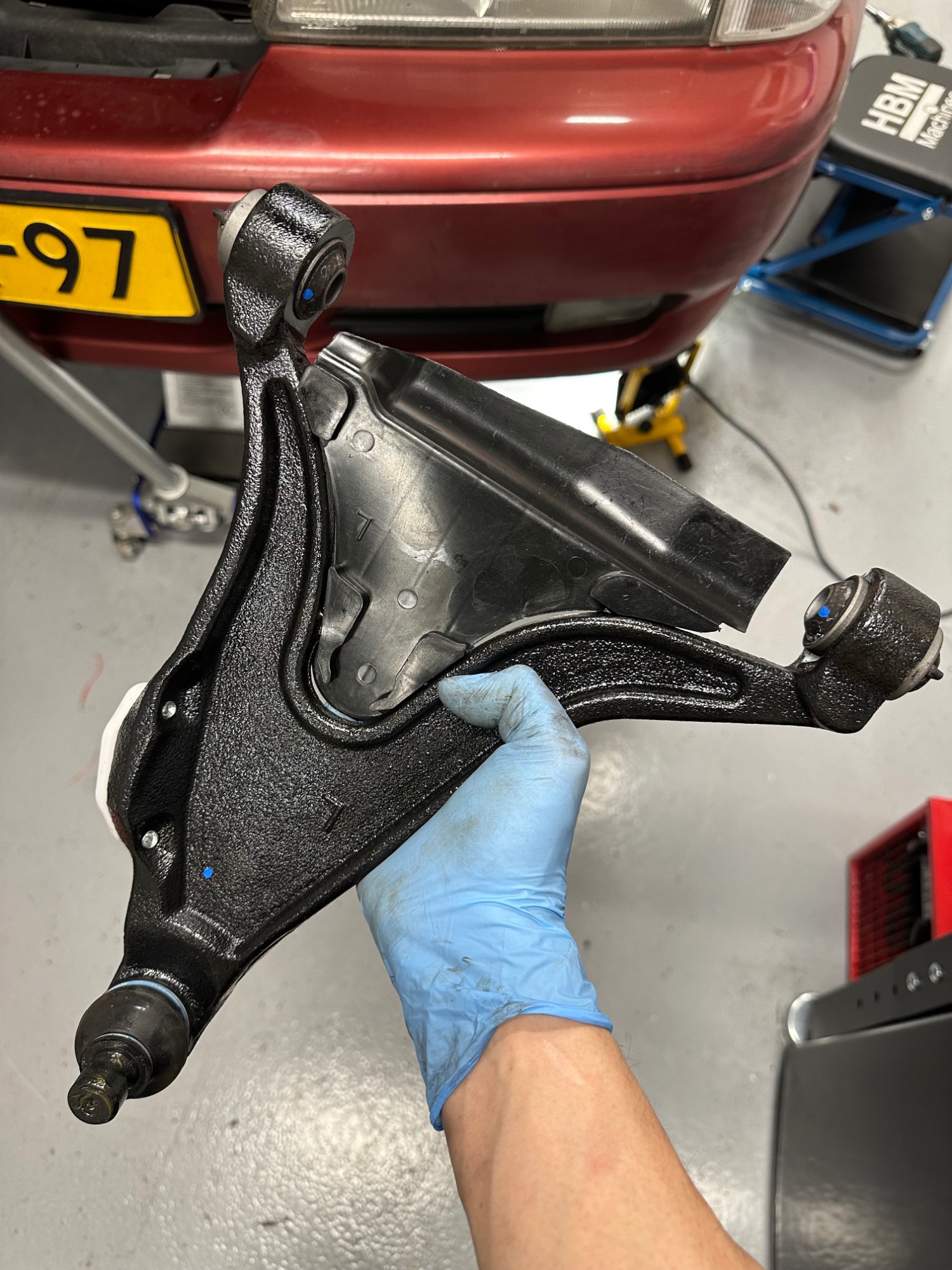

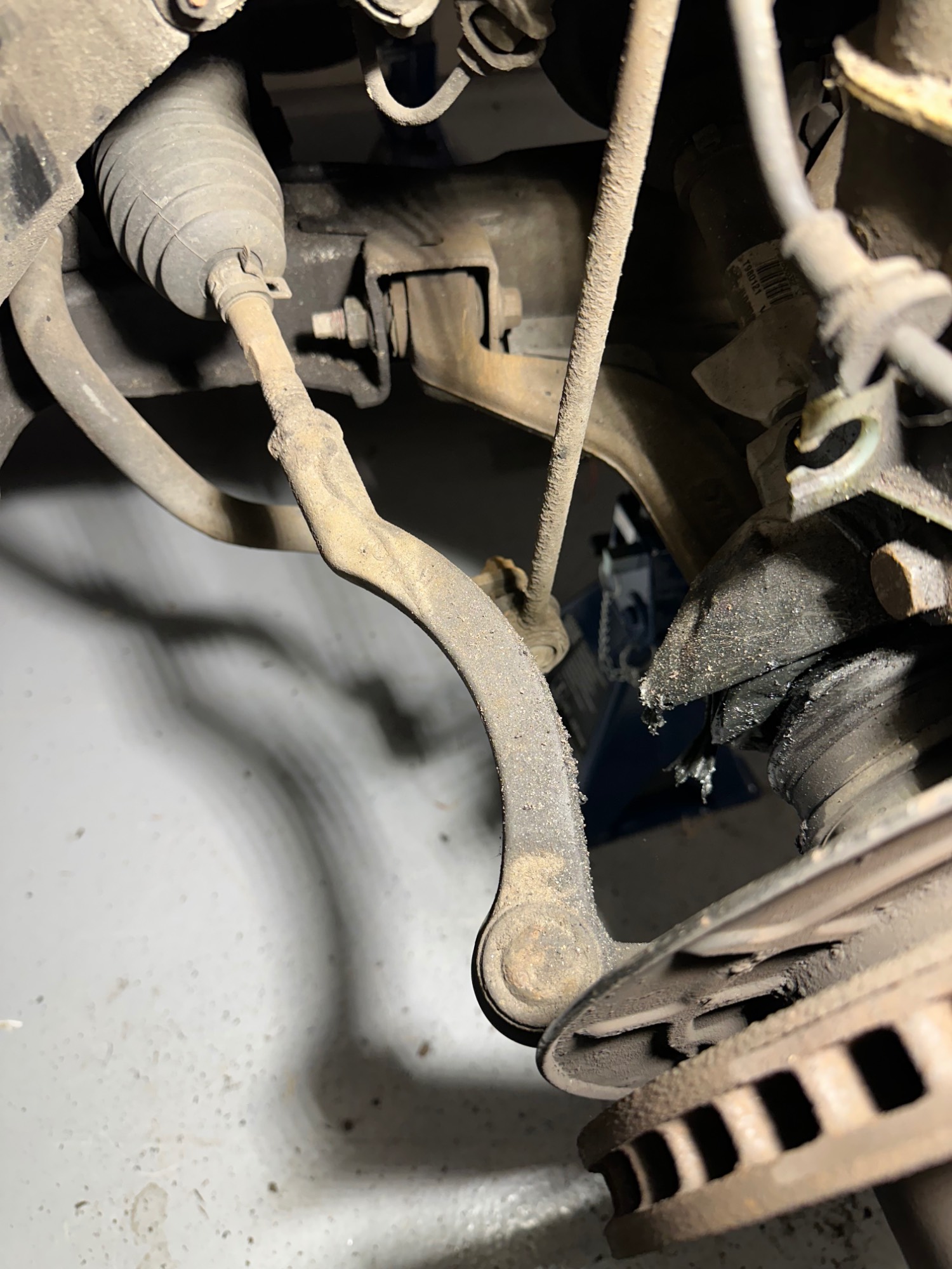

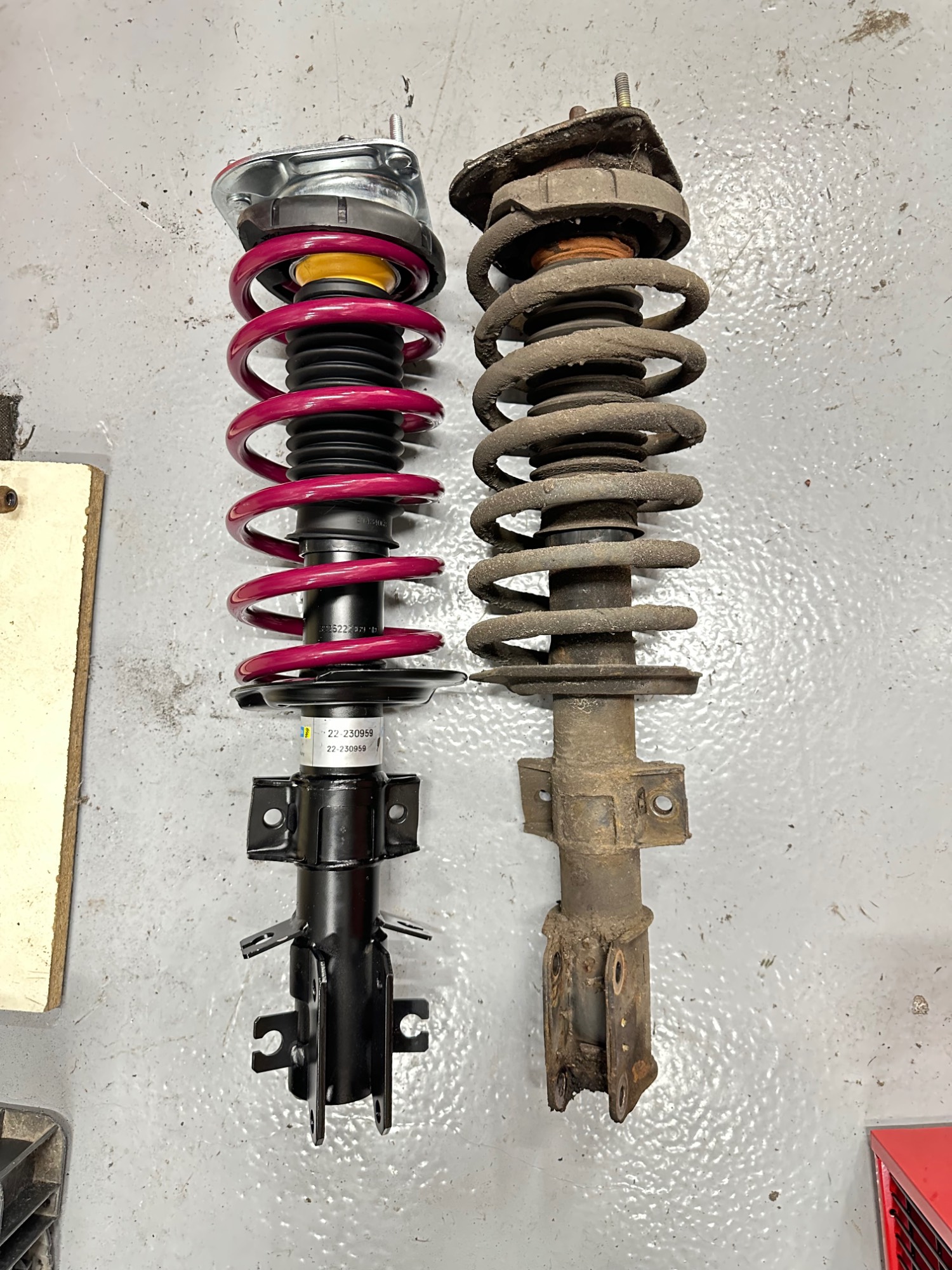

Can’t believe I’ve spend half a day on this and I’m not even halfway done.
Left side done:
- new strut
- new control arm
- new sway bar link
Left side not done:
- outer tie rod. Stuck as hell. Tried turning both ways. Going to replace inner and outer now. Just have to order the inner tie rods.
Right side is half disassembled and going to do:
- outer cv joint boot
- control arm
- inner and outer tie rod
- swaybar link
1/2 a shitbox V70 1998 2.5 NA

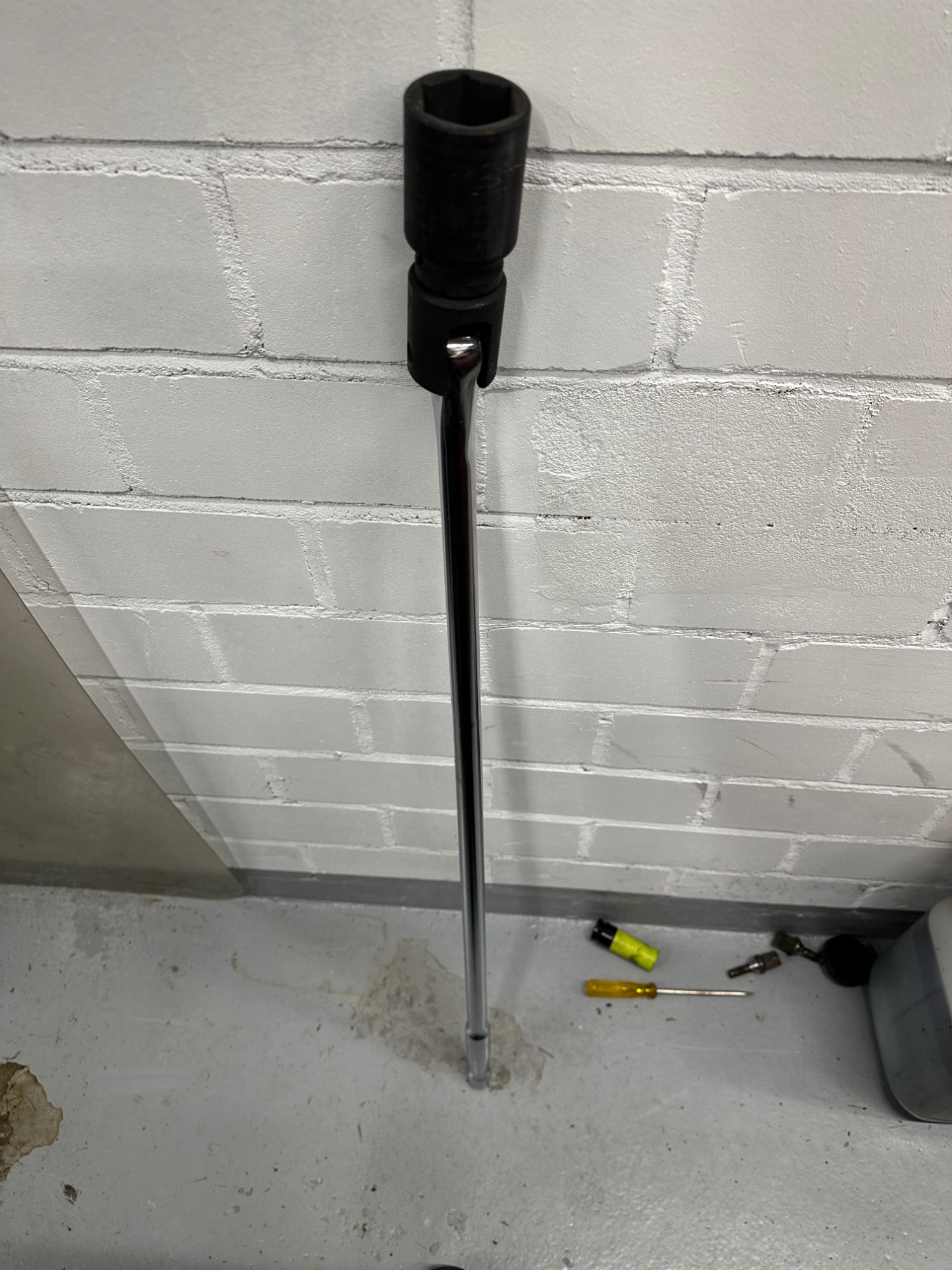

Great progress and it will all be worth while once you have got all the deferred maintenance and worn parts up-to-date!
Heat may help to separate the inner and outer tie rod, lots of it.
I have broken 2 x 1/2" breaker bars (yes they lived up to their names) trying to undo the hub nut on P80's. I now use an impact wrench but also have a 3/4" long breaker bar and socket just in case!

My P80 is the only vehicle I've ever had to remove an inner tie rod. I absolutely hate the perfectly smooth round design with no edges to put a wrench on it. I ended buying a tool that grabs the shape as you try to turn it but it wasn't small enough and I had to jam a pry bar into the tool at the same time. I wish I had bought one that has some kind of clamp to tighten. Good luck.

I’ve read that a large pipe wrench should do the trick. Can’t remember which tutorial it was.

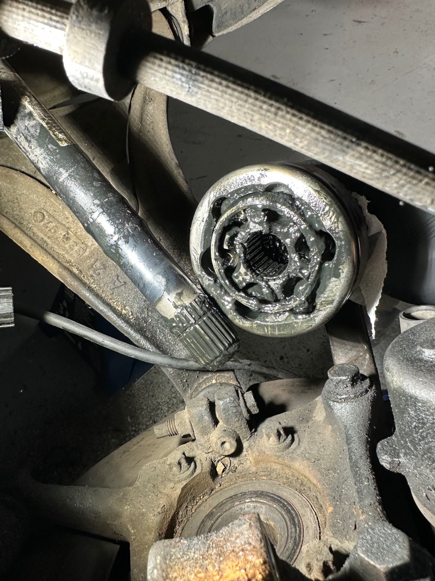

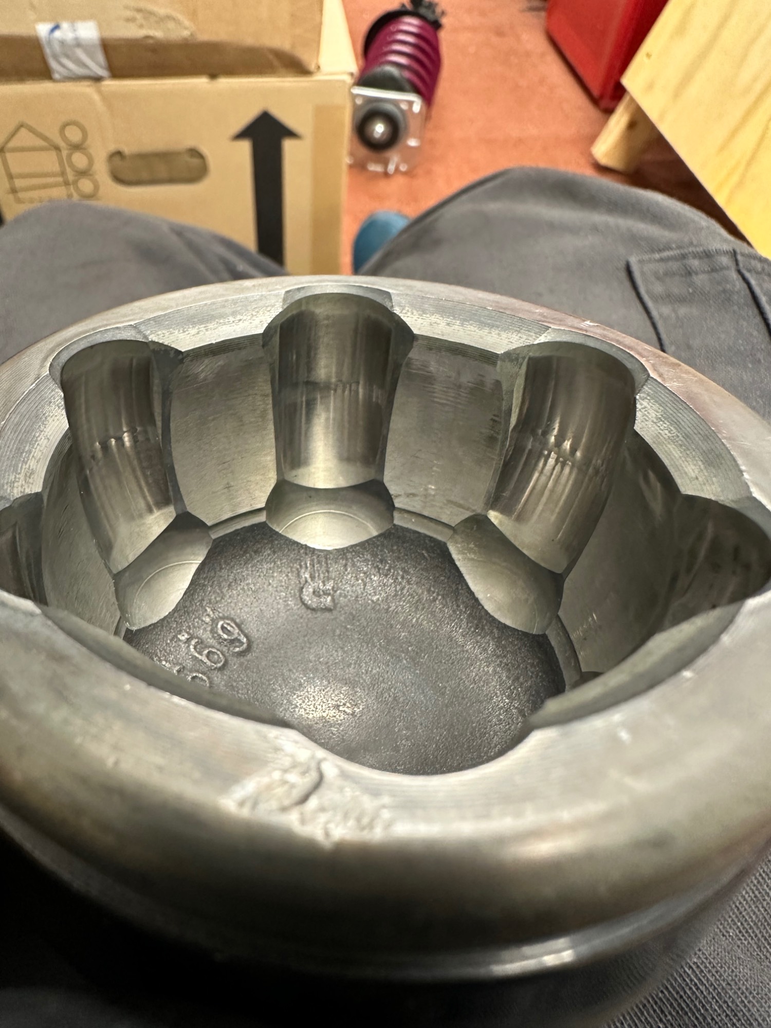

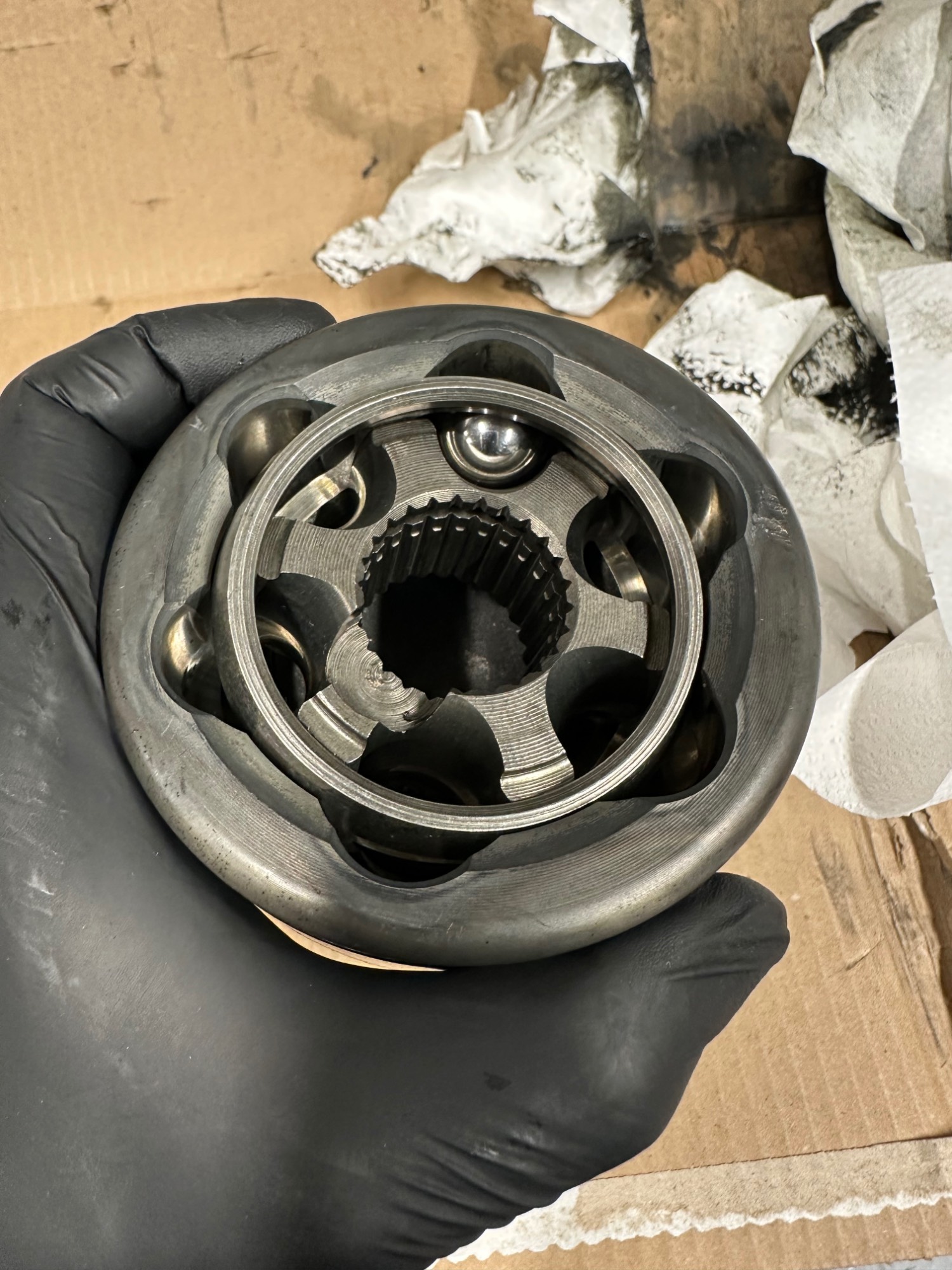

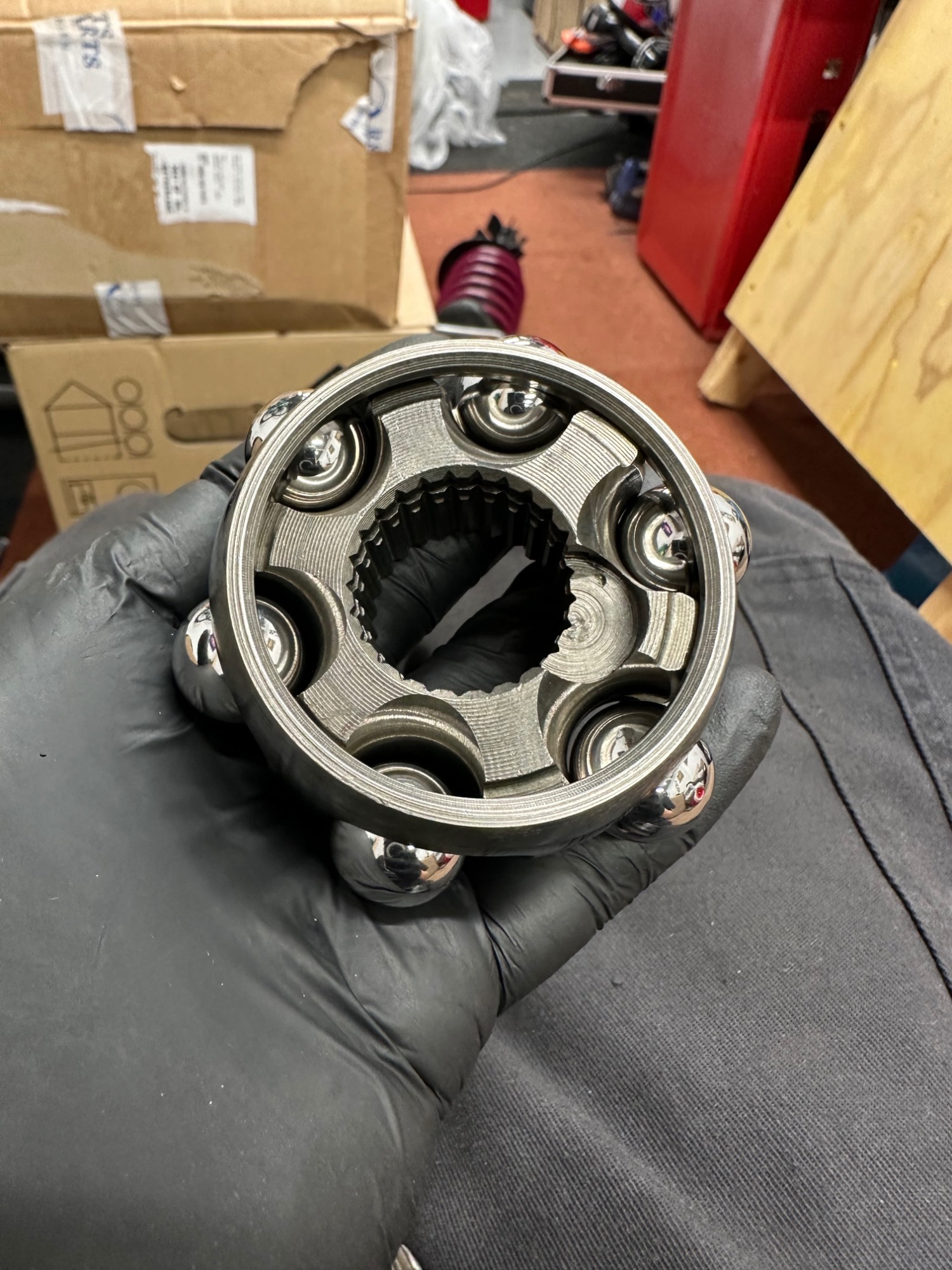

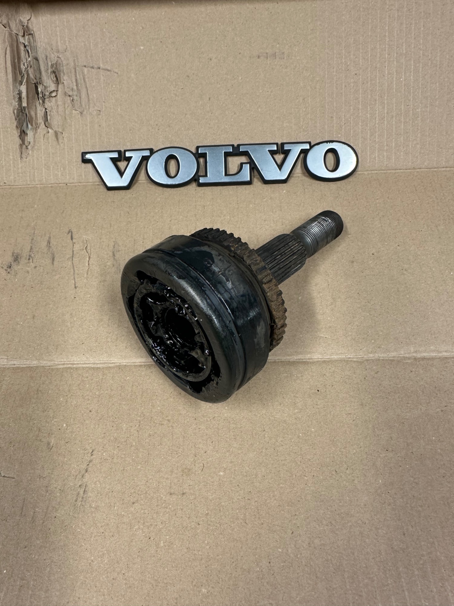

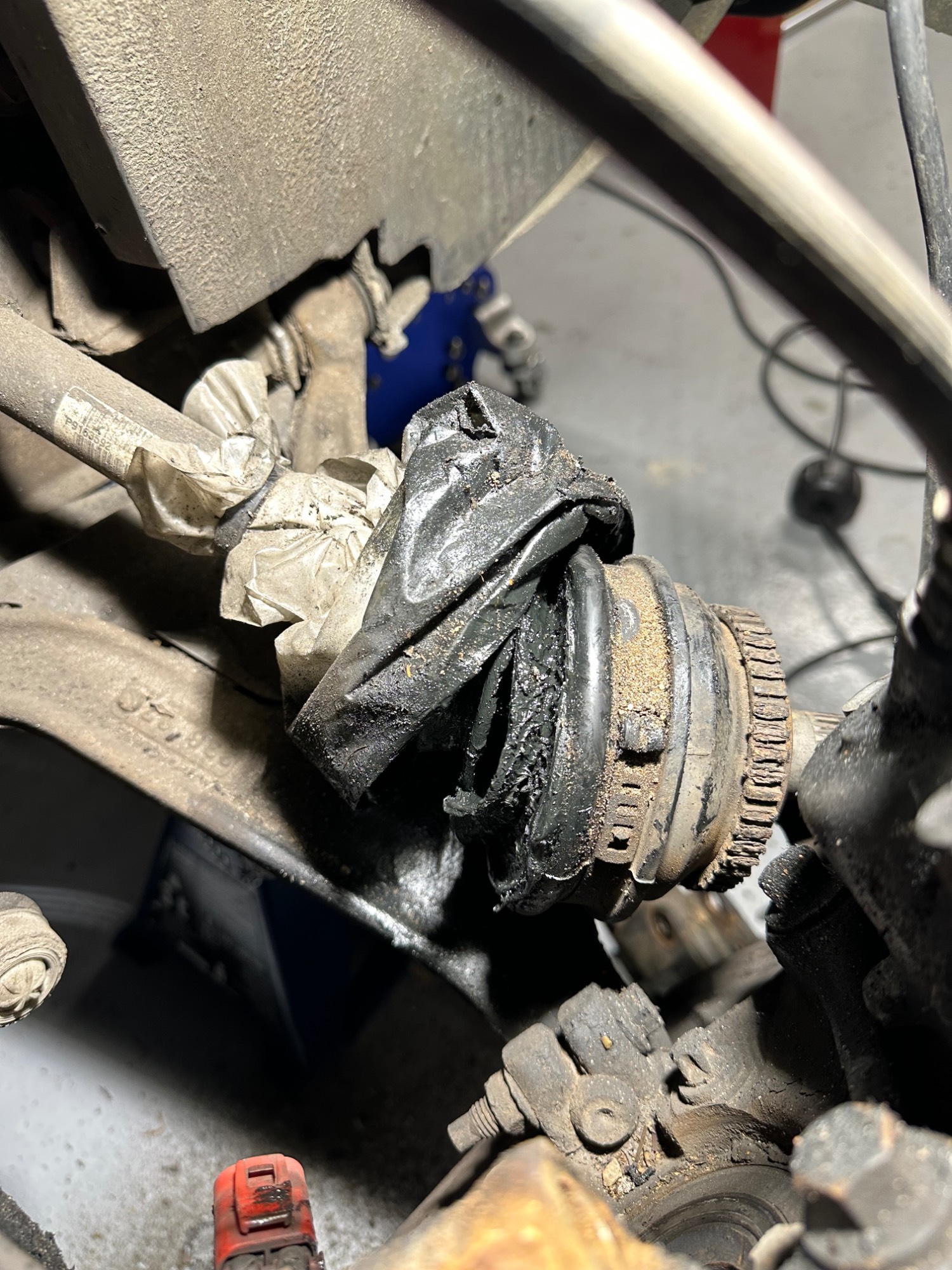

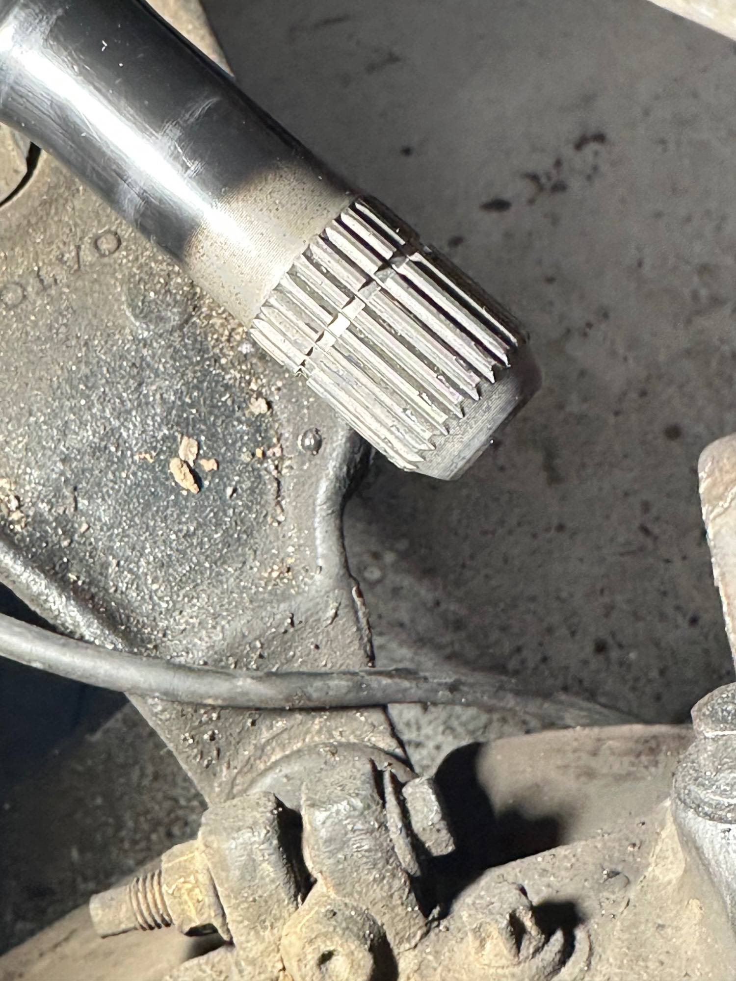

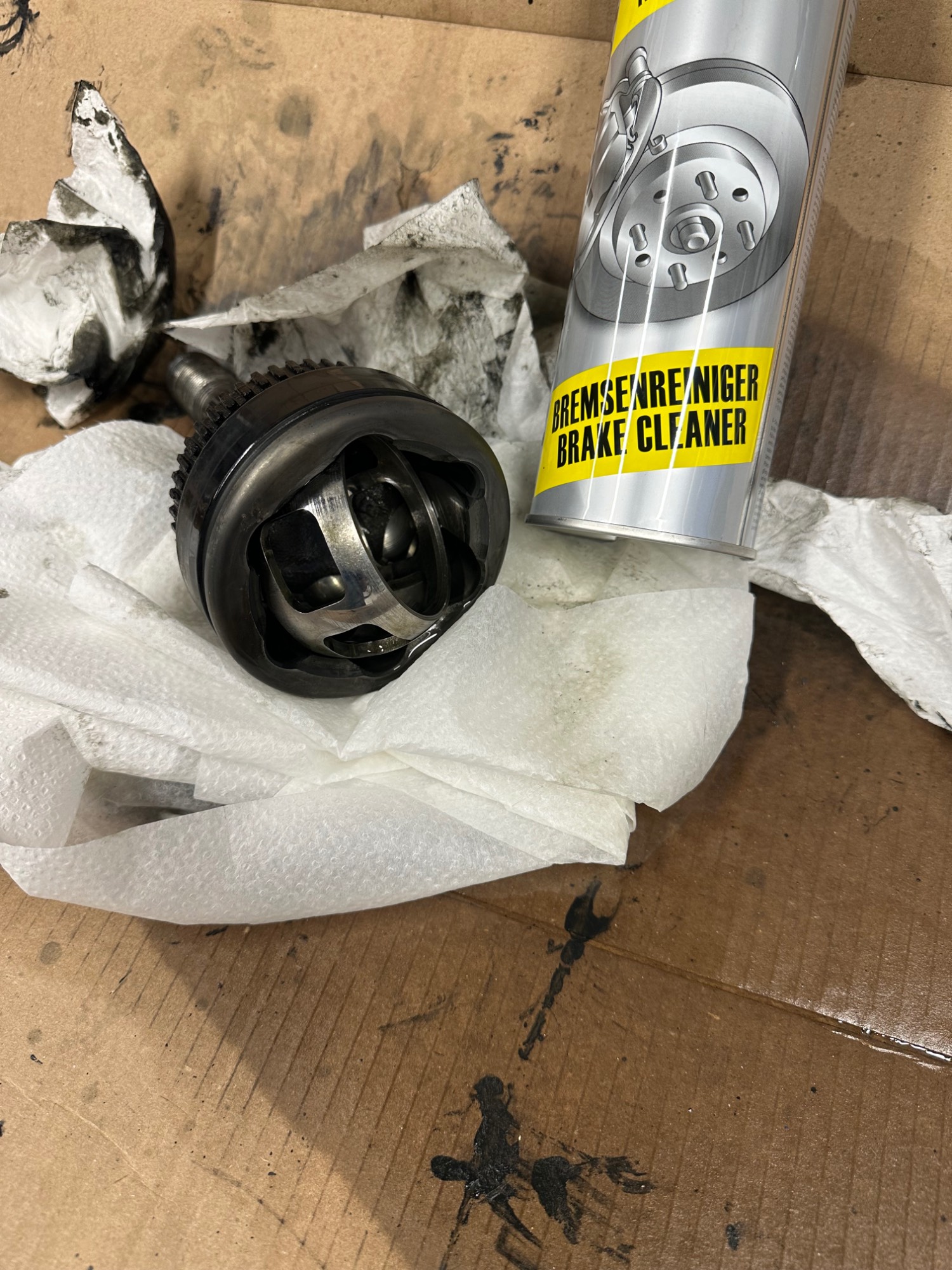

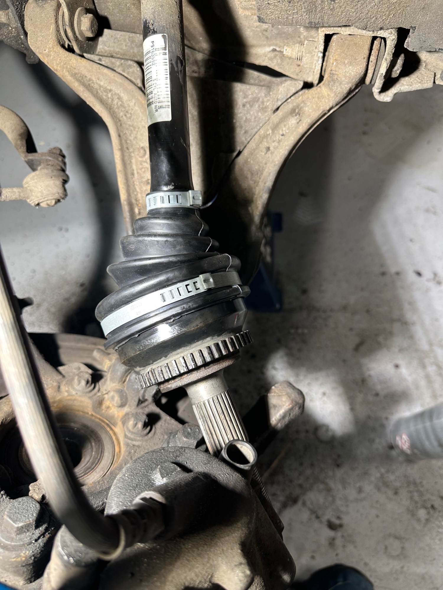

Replacing the cv joint boot I got lucky and the cv joint was easy to get off the shaft. So I didn’t pull the axle at all.
Getting the bearings back was a puzzle. Until I found a mention of using grease instead of doing it dry.
