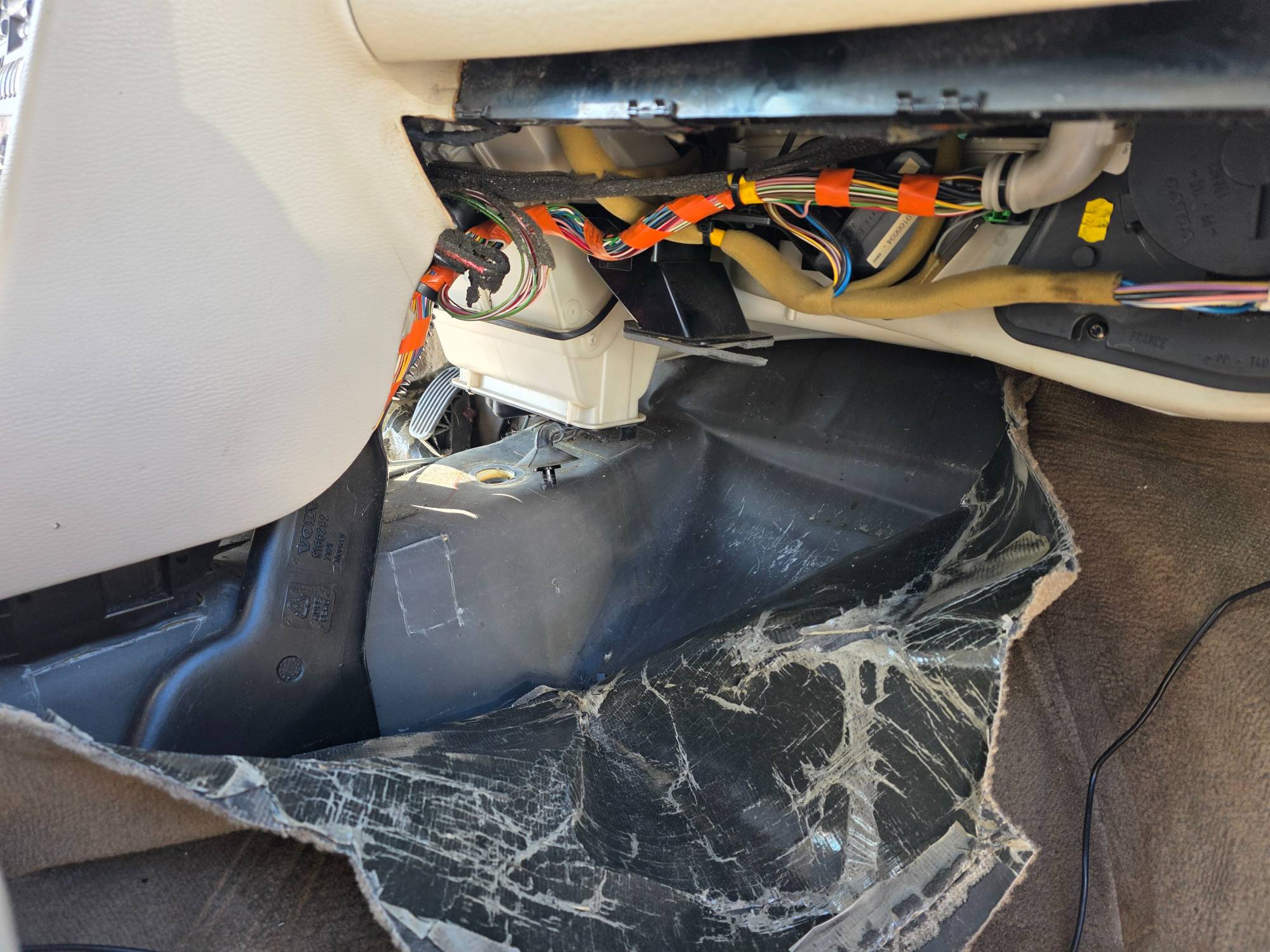

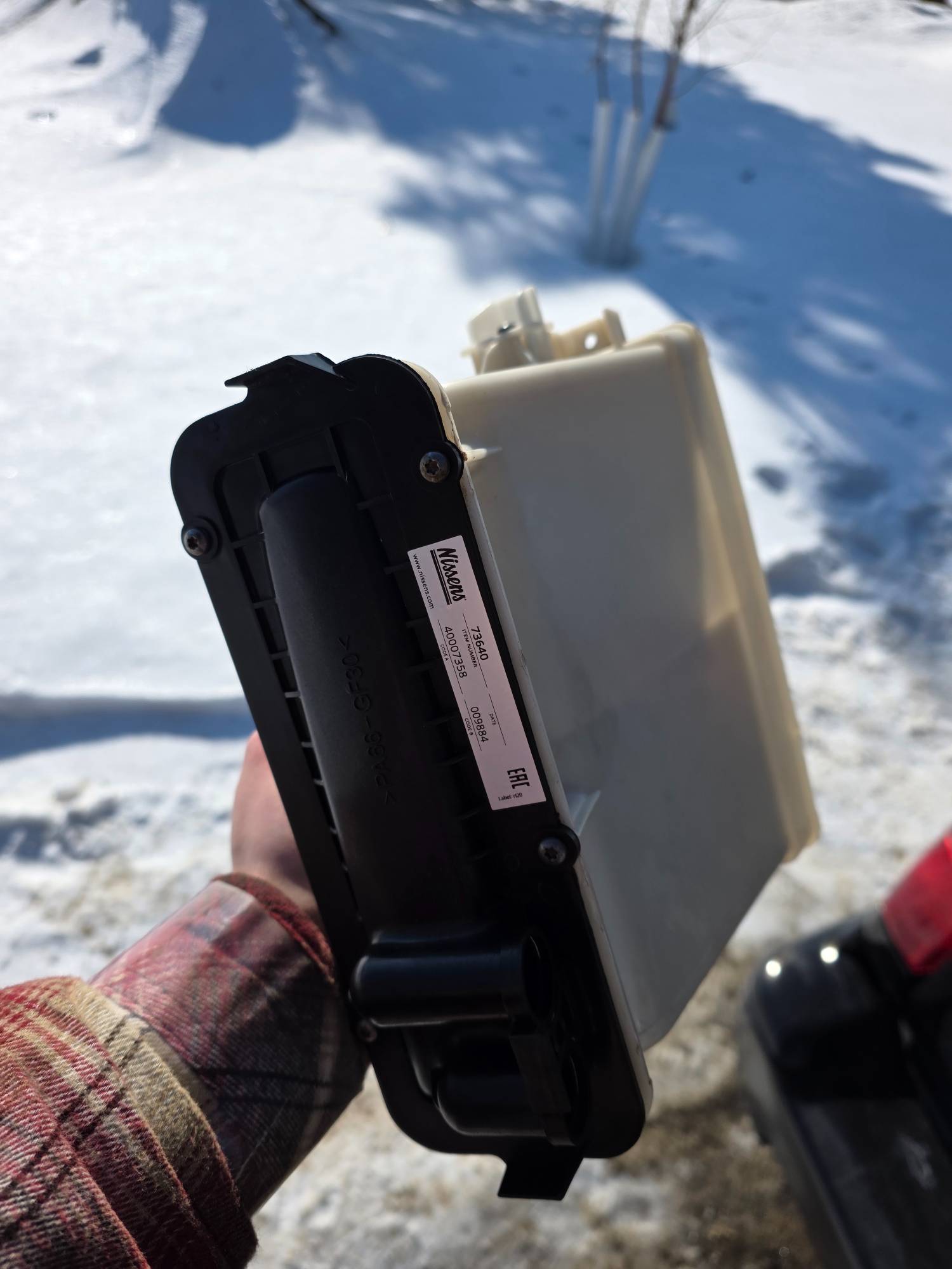

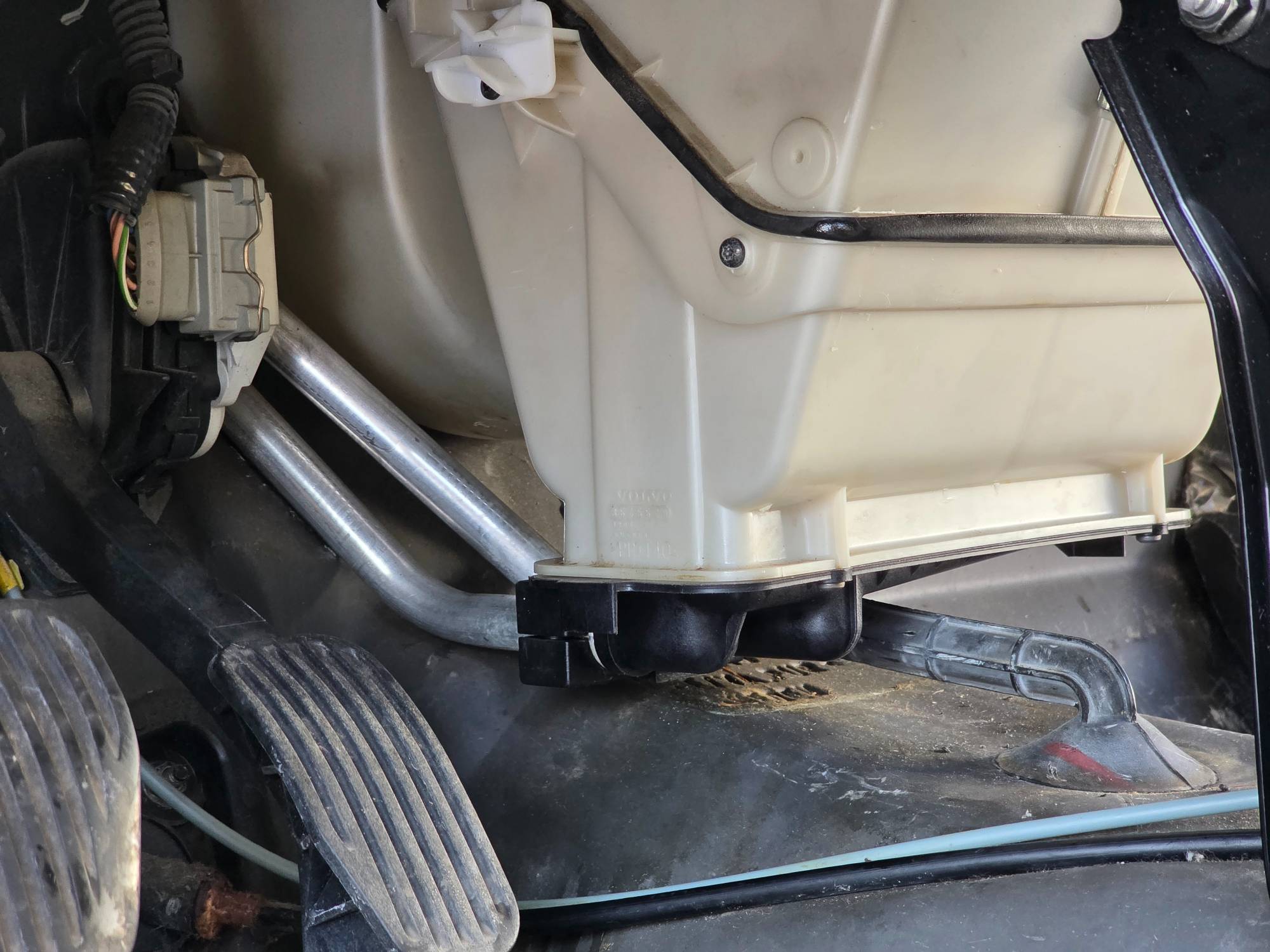

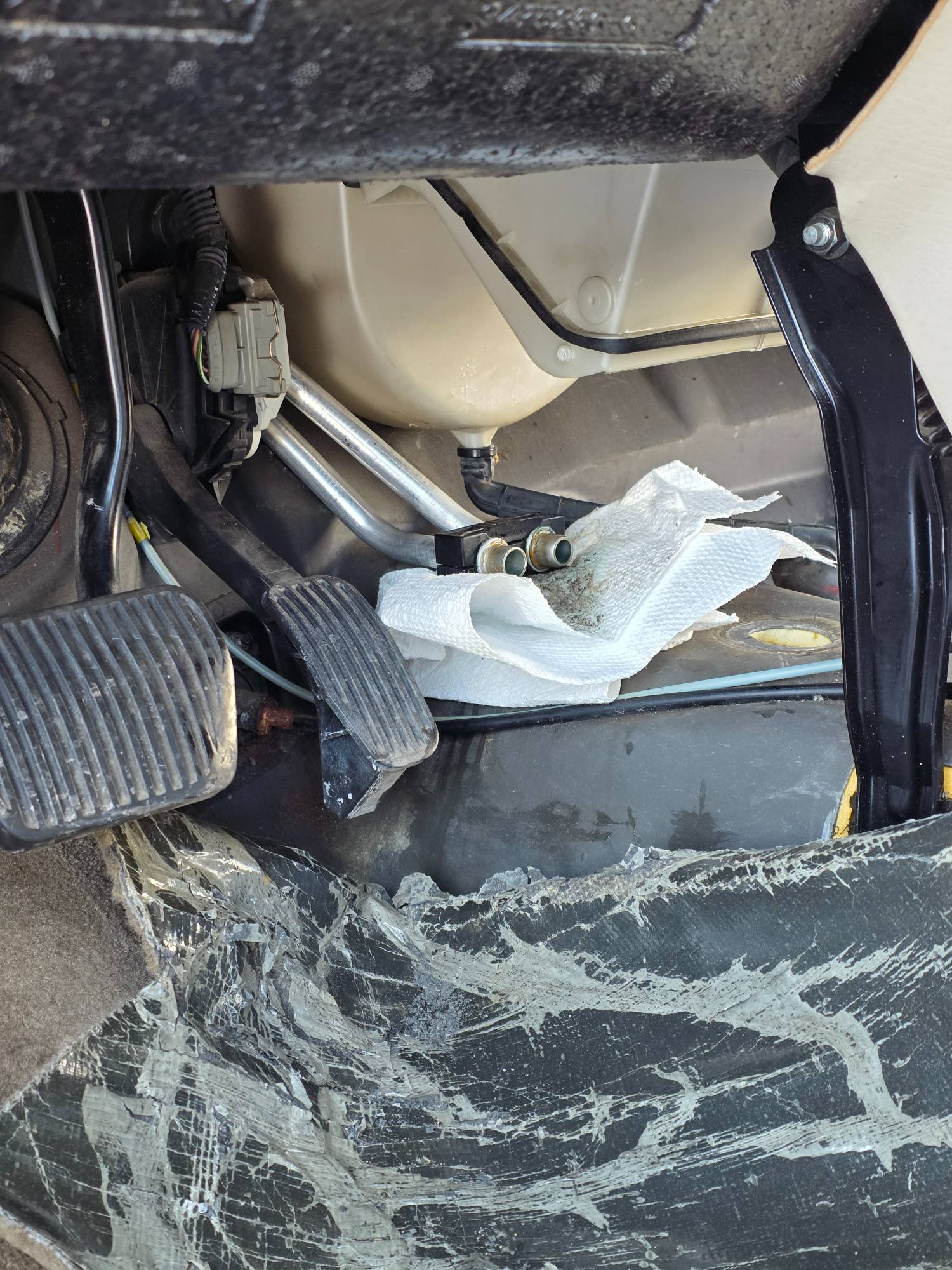

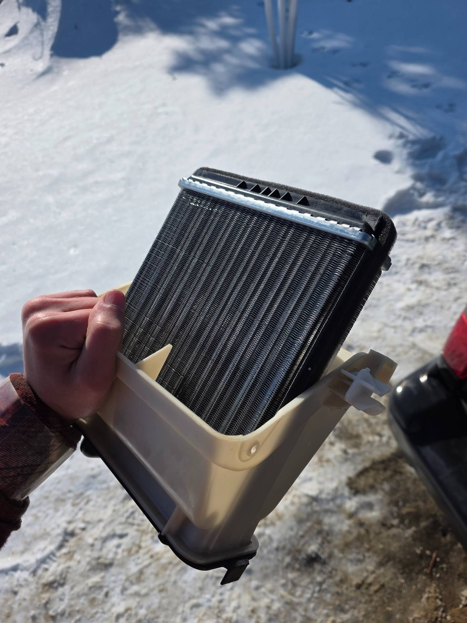

The job is done! There wasn't any obvious copper stop leak in the old core like I thought there might be. I might try to flush the old core with water just to see what happens. It's definitely not the original heater core, but I don't know how old it is or what brand it is, appears to have been a cheap no-name replacement.

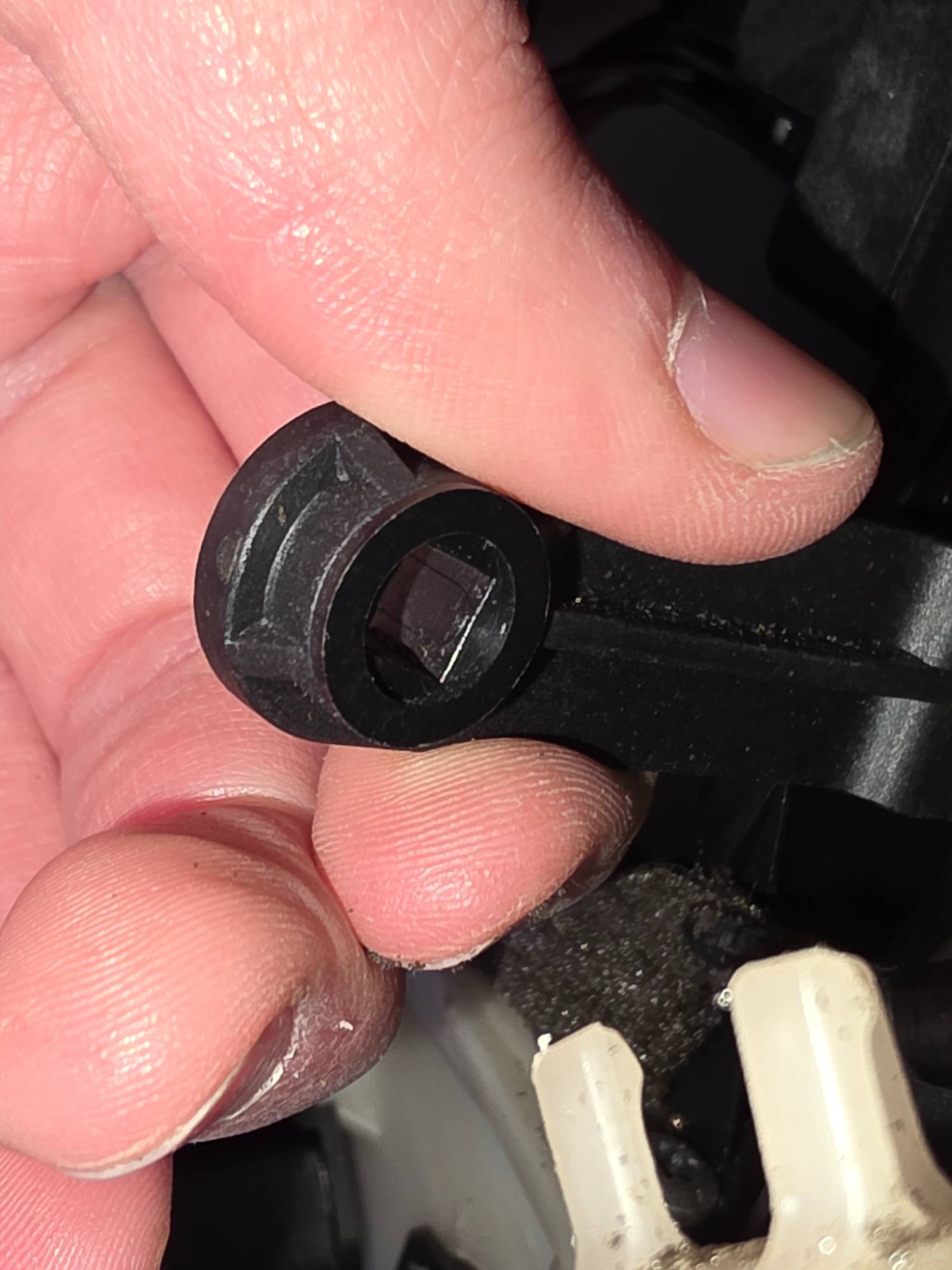

Upon removal of the glove box, I discovered that the recirc damper arm was not attached to the actuator. However, when I pulled the arm towards me and got a good picture of it, I saw that it wasn't broken. It actually looks like a new part. Somehow it fell off of the square drive of the actuator, maybe due to vibrations. I put the arm back onto the actuator and viola, the recirc function works again.
Either way, the car now has nice, HOT heat. Have to give a big kudos to the Volvo engineers for making the heater core an accessible part.
