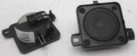

Do you mean the bracket portion of the 6849410 speaker assembly? Pictures from a random website:

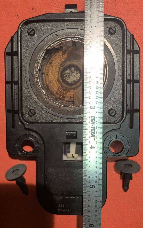

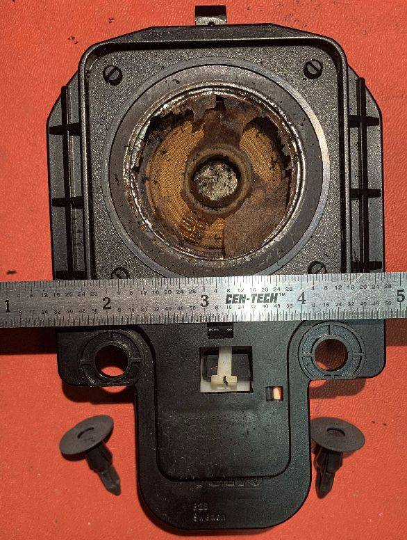

This is the '99 tweeter (P/N 3533623) from another random website:
Here are measurements of my '97 tweeter:
It looks like '99 to '97 substitution is a no-go, because the mounting hole locations have changed.
Is it the four double-headed tabs at the tweeter corners that are breaking? I think even if you get a new bracket, they're just going to break. The old plastic doesn't have any flex any more. Better to let them break, drill out the stubs, and attach the new tweeter to the bracket another way. Maybe RTV, or else machine screws and hex nuts with threadlocker.
