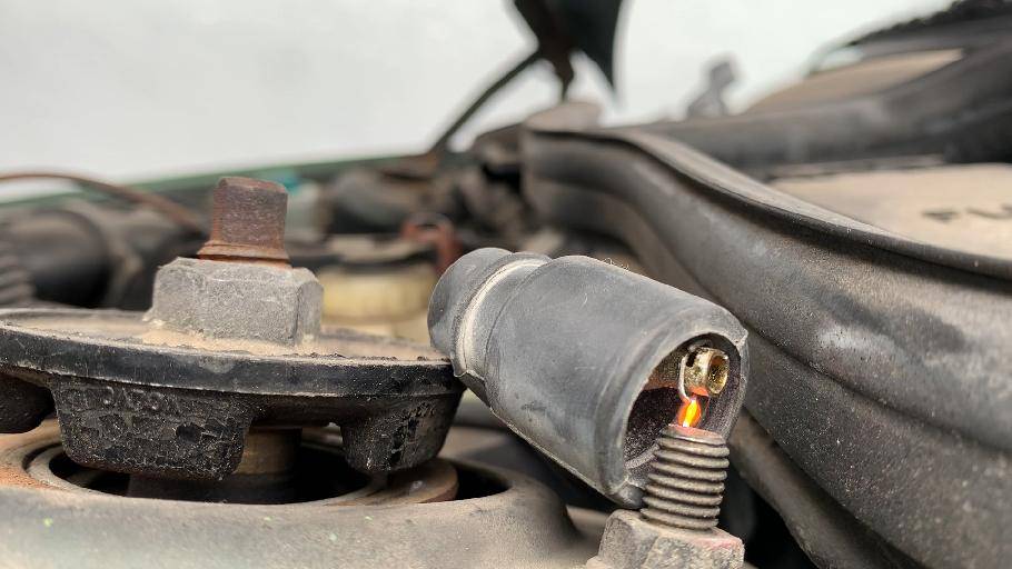

You said it doesn't "seem" like it's getting spark. Is it getting spark or not? In 2026, it's a one-person job to check. You can leave your cell phone under the hood recording video while you go in the car and turn the key.

Or look after dark.

Have a neighborhood kid hold the coil wire and see if he jumps
