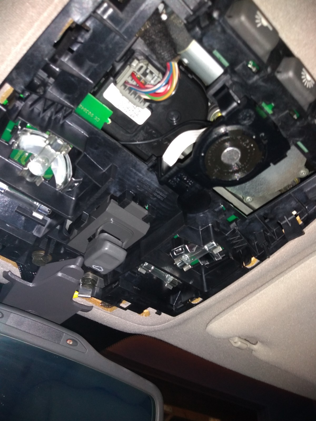

Few months ago I installed an Android HeadUnit radio with all the modern infotainment features, including hands free calling. Problem is the microphone hangs from the headliner and looks bad. I remembered early versions of the S60 had a built in phone option and the doom light still has a mic grill, so I opened it up to see if it was possible to install the mic there.
Found the old microphone holder
