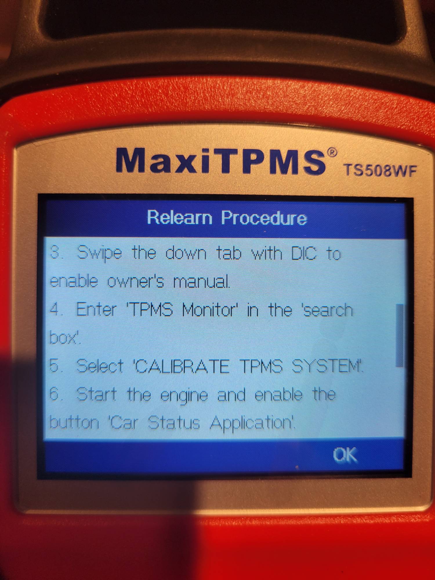

It appears that this car can have 3 possibilities for sensor programming. One of them is indirect learning.
For the rest you need to have a tool which is compatible with your tpms sensor and able to talk to your car. I had a good luck with Autel. Universal sensor from Autel is $25. But can be only programmed with their tool.
