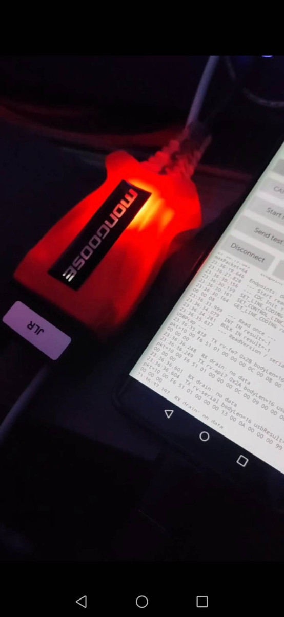

vtl wrote: 04 Jul 2026, 09:17
dikidera wrote: 04 Jul 2026, 08:52 Any internet is fine. The databases are stored on google's servers as PAD, Payload assisted delivery. As such it will download a few files. The diagrams are optional and are around 6.7GBs in size. Any one on a metered plan must pay attention so they are not billed excessively.
I was thinking more about having a VIDA-like diag in good places. And good places have no cellular network.
I finally managed to connect Mongoose to my Android smartphone. I had to completely abandon the driver and control the device via serial, sending binary command packets directly (a pseudo-driver). All of this works without an internet connection. I'd also like to extract various diagnostic commands, but that would take a lot of time.
