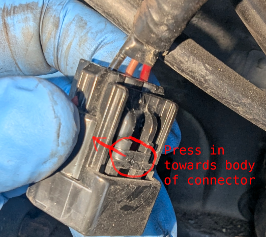

Great write up - thank you. Having had the sunroof get stuck in the open position, I seemed to have resolved the issue by pulling the siren module fuse....but then months later it got stuck again....I think it may have even opened itself but I am not sure. So...I bit the bullet and followed your guide to removing the siren module....which has now seemed to fix the issue again - thank you! The battery was rotten in the siren unit, with its connecting wires corroded off. The circuit board is not too bad - so I have cleaned it up with some electrical cleaner and I _might_ replace the battery (I saw them on ebay as I recall) and reinstall the siren unit......although car theft or a 2004 XC70 here in Vancouver BC is not all that likely.
I haven't reinstalled pop rivets pending making my decision on re-furbing and reinstalling the siren module - the wheel arch liner seems to hold in quite well (it has some clip like mechanism (just lugs really) that slide on to something above it - just look for them on the top of the wheel arch liner).
I am posting to offer a couple of small additions to your write up.
1. There is a youtube video of a fella showing how the siren module can be accessed by removing the front bumper and right hand headlight rather than drilling out the rivets in the wheel arch liner. I was going to go that way _but_ I thought removing the headlight wipers might be a high risk procedure with the small, likely corroded nuts. The wheel arch access route proved fine and easy to do - folks need some steady drilling screws and a bit of caution not to over drill but the rivets are so soft most folks could do this.
2. Disconnecting the connector from the siren module - I struggled with this - it is hard to get a good look at it and I wasn't clear from your description as to how to press the in the retaining clip mechanism....so for others that might run up against this....push it _in_ towards the body of the connector or, in other words towards the left hand side of the car - and the connector should then easily pull out. Photo attached.
3. Removing the anti-tamper bolt - mine turned easily with vice grips so I would try these or pliers as a first approach.
4. To remove the siren module with its bracket, my bracket had to be rotated upwards a small amount to free part the bracket that fits through a hole. It then slid out backwards as you describe.
That's all I've got
Thanks again!
