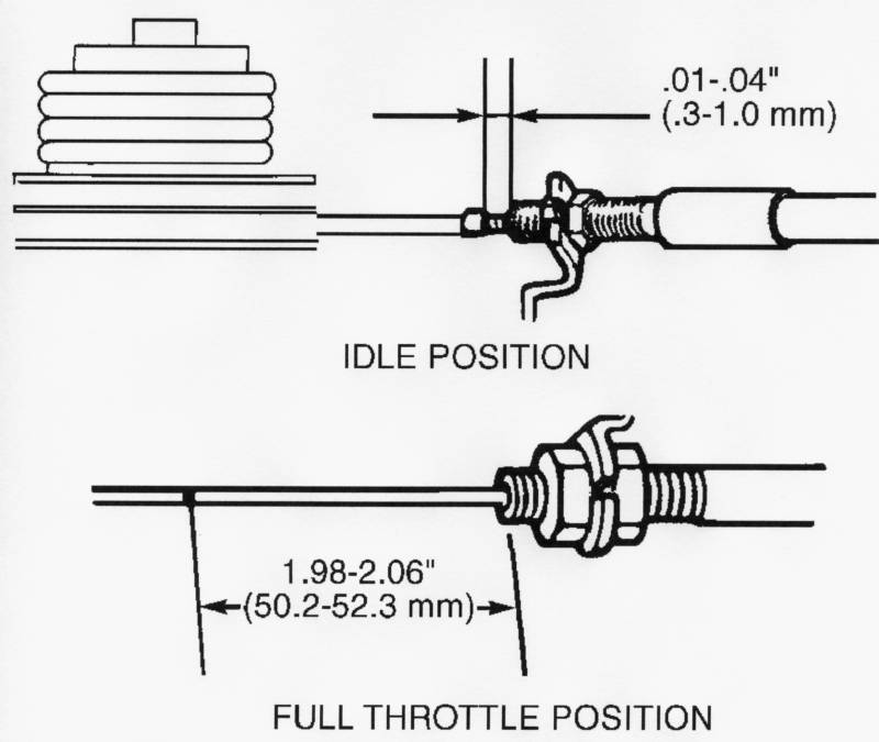

Look in to see where the cable is attached. You should see a cam around which the cable wraps. Carefully turn this with a screwdriver. It's spring loaded so be prepared for it to spring back as you will be rotating it against the return spring. Once rotated to the fully extended "full throttle" position, stick a screwdriver in to wedge it and you should be able to pull the cable end free of its hole. The old cable has a round stop which fits into a recess at the transmission end and is bolted on at the other end.
Remove the cable.
Re-assembling is a reverse of the above. Use a small amount of synthetic grease on the O-ring.
Once installed in the transmission install the upper end and adjust it so it just slackens when the throttle is at idle. You should be able to hear the valve clunk slightly when it slams back to idle. Install the small crimp around the cable core about 1/8" up from the rubber gasket. This crimp is important as it prevents excess cable from entering the transmission and keeps the cable in the pulley groove.
To adjust the cable depress the accelerator pedal. The distance from the end of the outer cable to the crimp should be 1.98" - 2.06".
Kick down cable.jpg (48.29 KiB) Viewed 719 times
I see you have now found the throttle part. The plastic cups can be obtained separately if you ever need them again. Also be aware that there are two different control rods depending on the engine type fitted. The B200 engine has a different rod from the B230 engine. If you find the rods are different the plastic cups fit both. One has a left hand thread.
