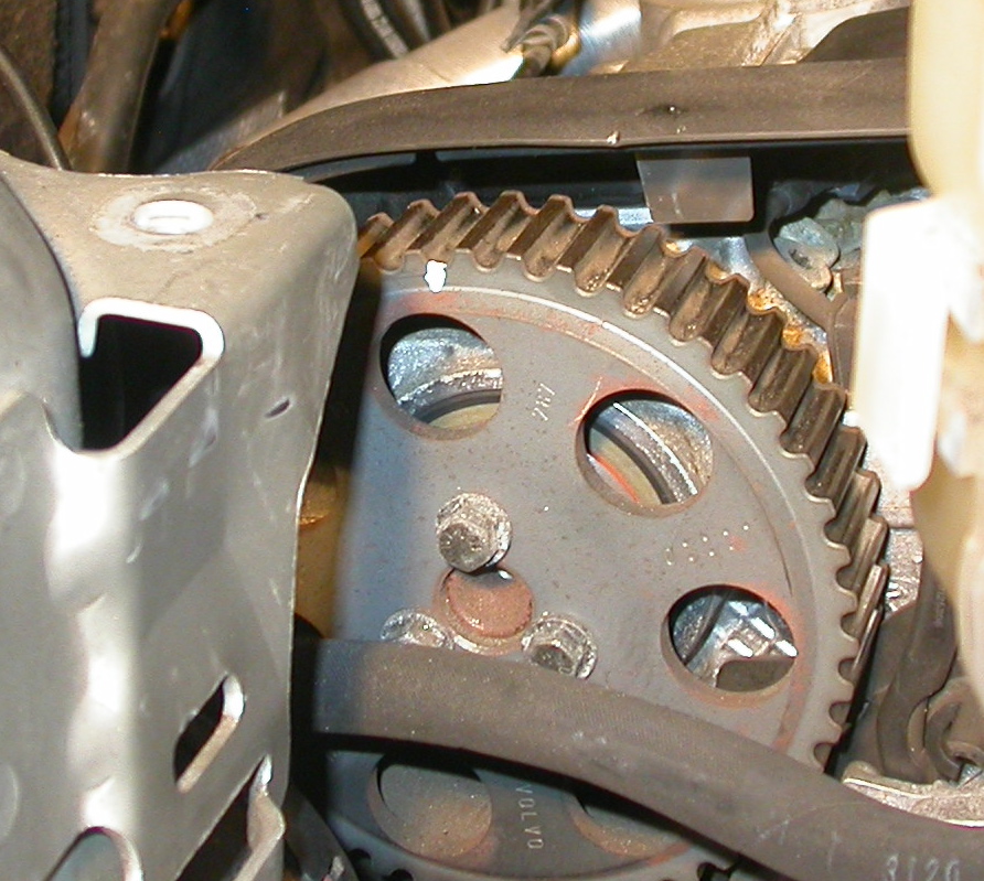

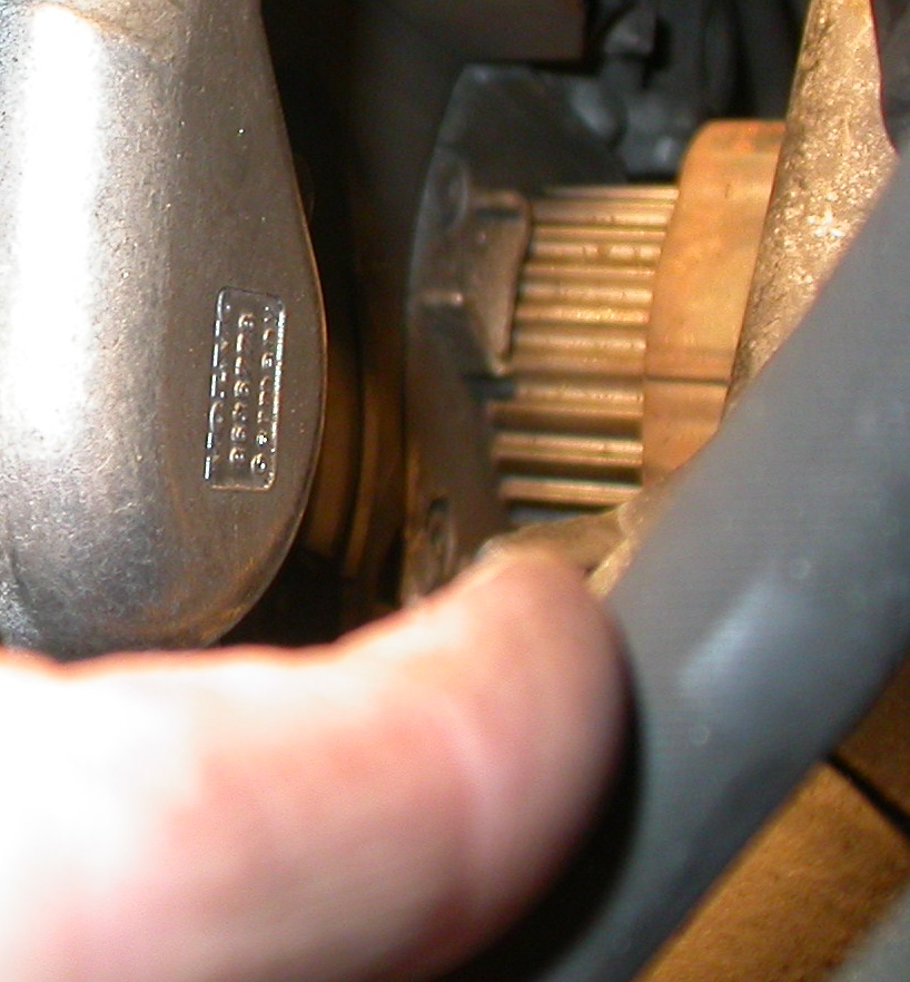

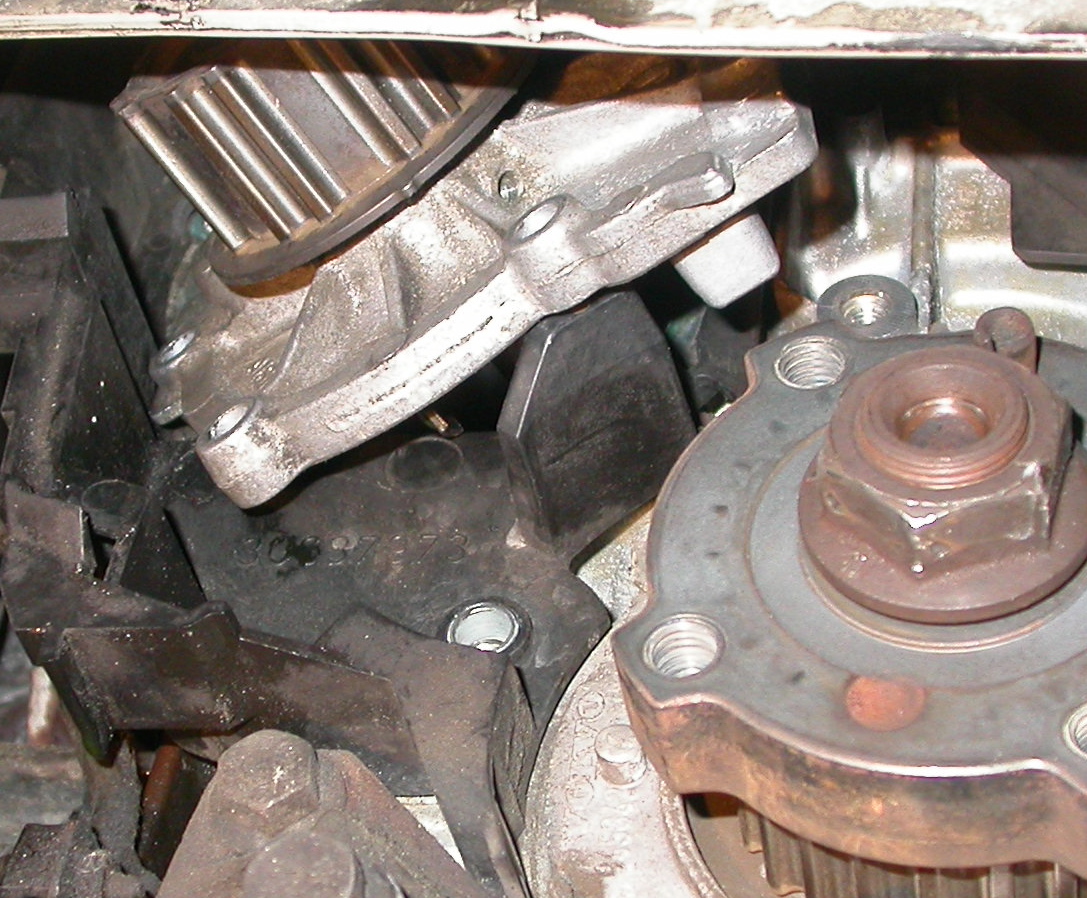

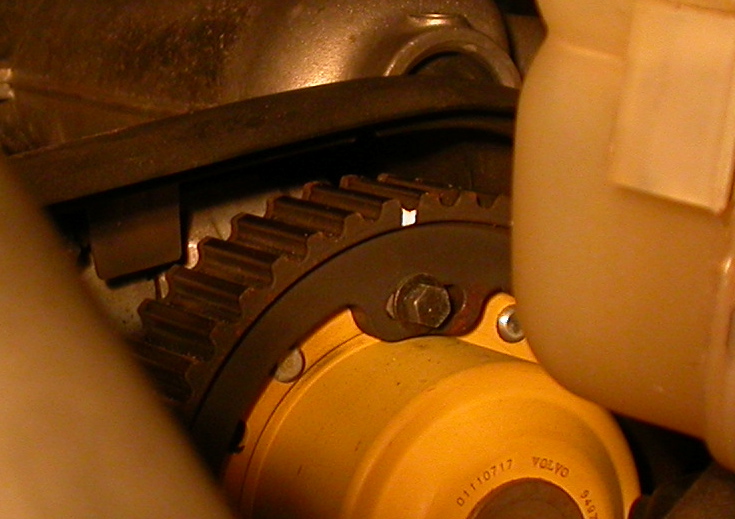

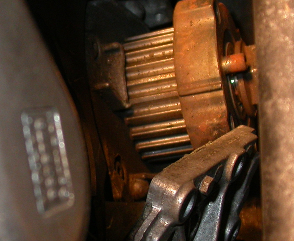

photos below show the problem
- how water pump is stuck
- DSCN4294.JPG (450.87 KiB) Viewed 1518 times
- exhaust cam position
- DSCN4295.JPG (311.4 KiB) Viewed 1517 times
- intake cam position (photo not so good)
- DSCN4296.JPG (139.78 KiB) Viewed 1518 times
- main crank gear
- DSCN4299.JPG (240.15 KiB) Viewed 1519 times
- main crank position again (a bit better)
- DSCN4300.JPG (292.62 KiB) Viewed 1520 times

I did do the magic with the 1/4 turn past tdc and then back. I am lost in terms of the timing. if I have it on the right marks, then number one should be at tdc. If I am on the wrong marks, I should not have found the timing marks on the cam in the right place.
