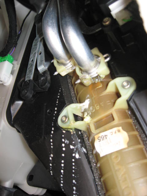

Update - I finally finished this repair. It took me a while because I could not get the lower pipe to seat properly. After refitting it with the old O-ring and driving for another week, I tried again and got it on with a little more gentle persuasion (rubber mallet). Keeping my fingers crossed and waiting until it seems that the leak has stopped. BTW, I found it much easier to get the cotter pins out with needle nosed pliers rather than the pick tool. Your mileage may vary.
Here are a few photos to supplement the ones in Mr. Winkey's Volvospeed link above (some in that post were out of focus). Another thanks to Mr. Winkey who created the fine how-to on Volvospeed. If not for your post which made it sound so easy, I might not have tried it.
- You can see the stain from the leak - seems pretty obvious that this is the problem.
- IMG_4186.JPG (65.75 KiB) Viewed 1813 times
- View with lower pipe removed. I could not get mine to swing out of the way as much as Mr. Winkey on Volvospeed. Worried I'd break something.
- IMG_4188.JPG (72.41 KiB) Viewed 1813 times
