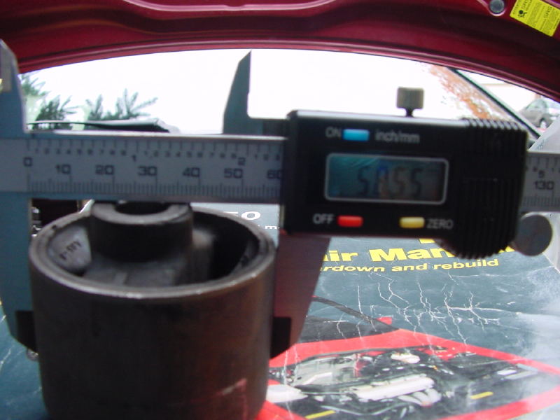

I ordered a new upper engine mount and installed it with no problem, only to find that the circumference was out of spec and the entire bracket could move from side to side.(this is why the installation was easy, it just slipped in)
I was not satisfied and the supplier gave me a new mount.
See pics for the difference in specs
Out of spec mount:
New mount:

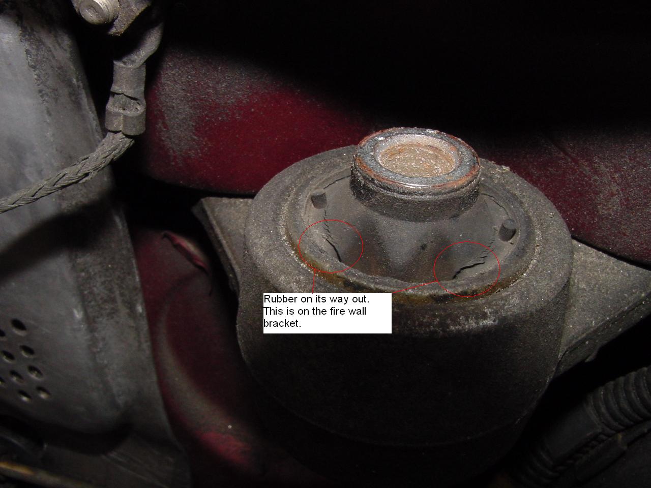

I noted that the mount by the fire wall is also looking tired and needs replacement. Is the replacement procedure similar too the larger upper mount ?
Pic of firewall mount:
I have reviewed the posts about upper engine mount replacement and have come to the conclusion there must be another way, or am I out to lunch here .Can anyone offer some pearls of wisdom once again.

Unfortunately, I don't know of anyone replacing just the rubber piece inside of the firewall mount- and I've only seen them sold as a whole piece. However, I have seen folks take those mounts off the firewall and fill them with silicone (like you would caulk your bathroom with) and let it harden up. You might consider that or buy the entire piece from a place such as www.fcpgroton.com

That firewall mount is about $26 @ dealer, (just ordered one this morning).
Funny that you have a small bushing slipped right in. The one I got (Febi) is too big, I tried, tried but after 5 hrs still wont go in, I give up.

I did follow the instruction of that write-up but no go. I think the bushing I got is out of spec (the diameter of the bushing is 2.5mm bigger than the hole).

Today I replaced the firewall mount as well as the upper engine mount. The upper engine mount that I had replaced originally was the incorrect diameter and easily moved sideways within the bracket. I was not happy and got another one from my supplier.

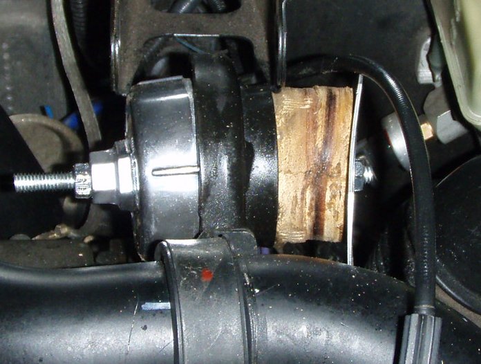

It will go although it is extremely tight- I replaced mine a couple of weeks ago on my S70. Once you get it started WD40 seems to be a good lubricant. Here is a picture of how I used an old oil filter wrench and a piece of wood (with a 1/2 inch hole cut in the middle) to push mine in:
You can see where the wood seems crooked and the metal plate I was using was warping but still the torque mount went in without a hitch!
