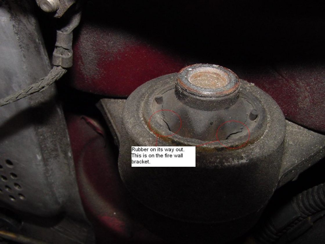

picture1289yy5.jpgI noted that the mount by the fire wall is also looking tired and needs replacement. Is the replacement procedure similar too the larger upper mount ?
Pic of firewall mount:
