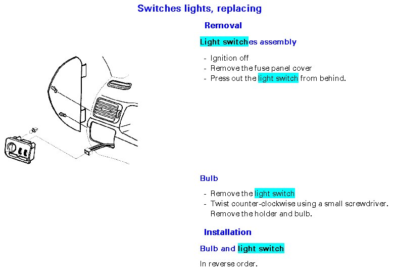

I own a 2001 V-70 2.4T GLT with a diagnosed defective headlight switch. I'd like to replace it without paying VOLVO $262 but don't know how to remove the existing one.
Any comments would be appreciated.

Seems pretty straight forward and on your model, I don't believe you need a software download after it is replaced either:
V70 Headlight switch.jpg (43.49 KiB) Viewed 2875 times
The replacement part number you need is #9441046 if you don't have fog lights and #9441232 if you have them. These part numbers should be fine unless you have "headlight adjustment" (I would say that your V70 has these adjustments up front on the headlight bracket itself) or "fuel leakage" diagnostics built into the switch, which I doubt...it should be obvious if that's the case as there will be more than just the one connector on the back. Good luck and post back if you need the other part numbers- there are a whole bunch of them depending on how your car is trimmed out.

Thanks so much! I'm not terribly mechanically inclinded but I believe I can even follow this one 8)
