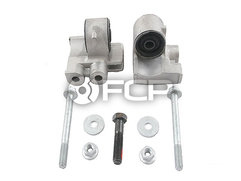

Anyone know of any DIY write-ups for the rear trailing arm bushing replacement ?
- volvo trailing arm.jpg (53.86 KiB) Viewed 454 times

Haynes covers it pretty well. The only real trick is to mark the location of the bolt so that you can get the alignment back halfway right. Even then, you should go ahead and get a 4 wheel alignment since the bushings are where the rear toe in is set.
