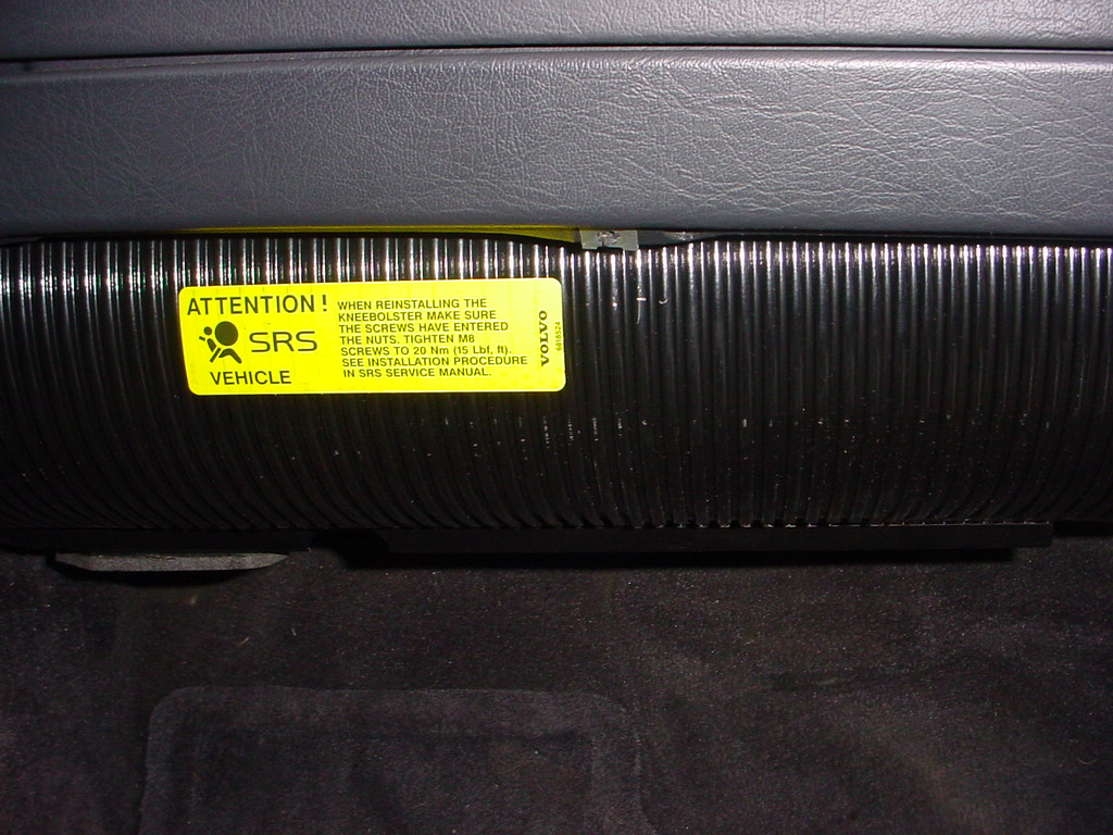

To replace the blower you first need to remove the lower dash panel on the passenger's side of the car. It is held in place with three T-25 Torx head screws. Once the lower dash panel is removed you will be greeted with the knee bolster which has an SRS sticker on it.

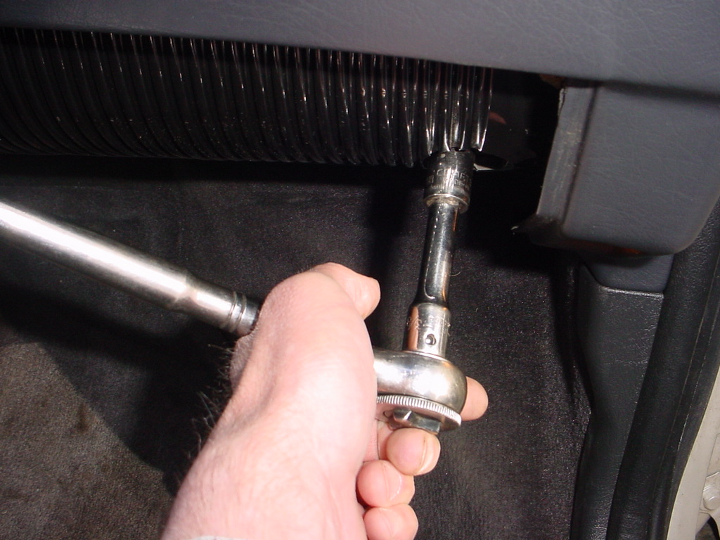

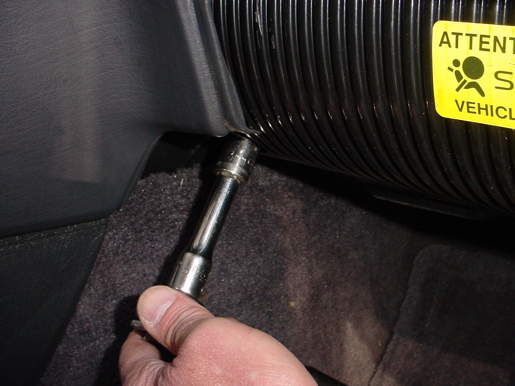

Fear not, the knee bolster has nothing to do with the SRS and you can remove it without worry of setting of an air bag. The knee bolster is held on with three nuts. Use a deep 13mm socket and an extension to remove the nuts. You can fight it out now or you can wait until after you remove the glove box.

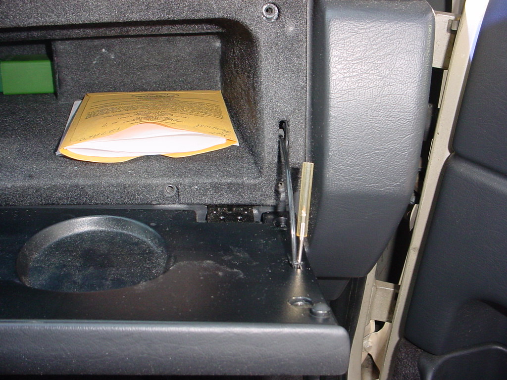

The next step is to remove the glove box. You first need to release the retainer arms with a small screwdriver. Next to the glove box door side of each of the arms there is a small hole. Slide the screwdriver into the hole and it will release the arm.

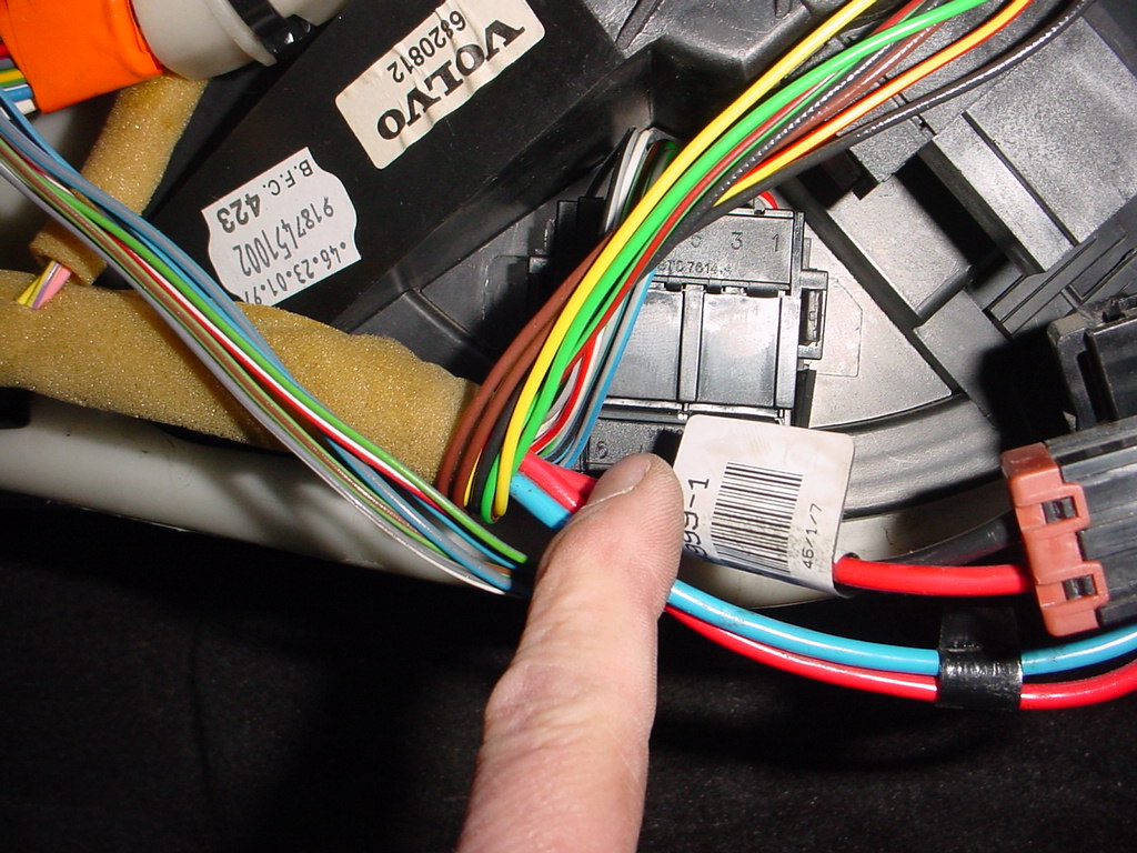

There are two screws on the left (high and low) and two screws on the right that are much nearer the center. Before removing the screws you need to remove some of the wiring harness that is anchored on the blower housing. Near the bottom there is a connector that is held in place by the blower itself. That connector needs to be removed from the blower but it doesn't need to be disconnected. There are a couple of release tabs that need to be pulled back to get it off. I am pointing to it in this picture.
