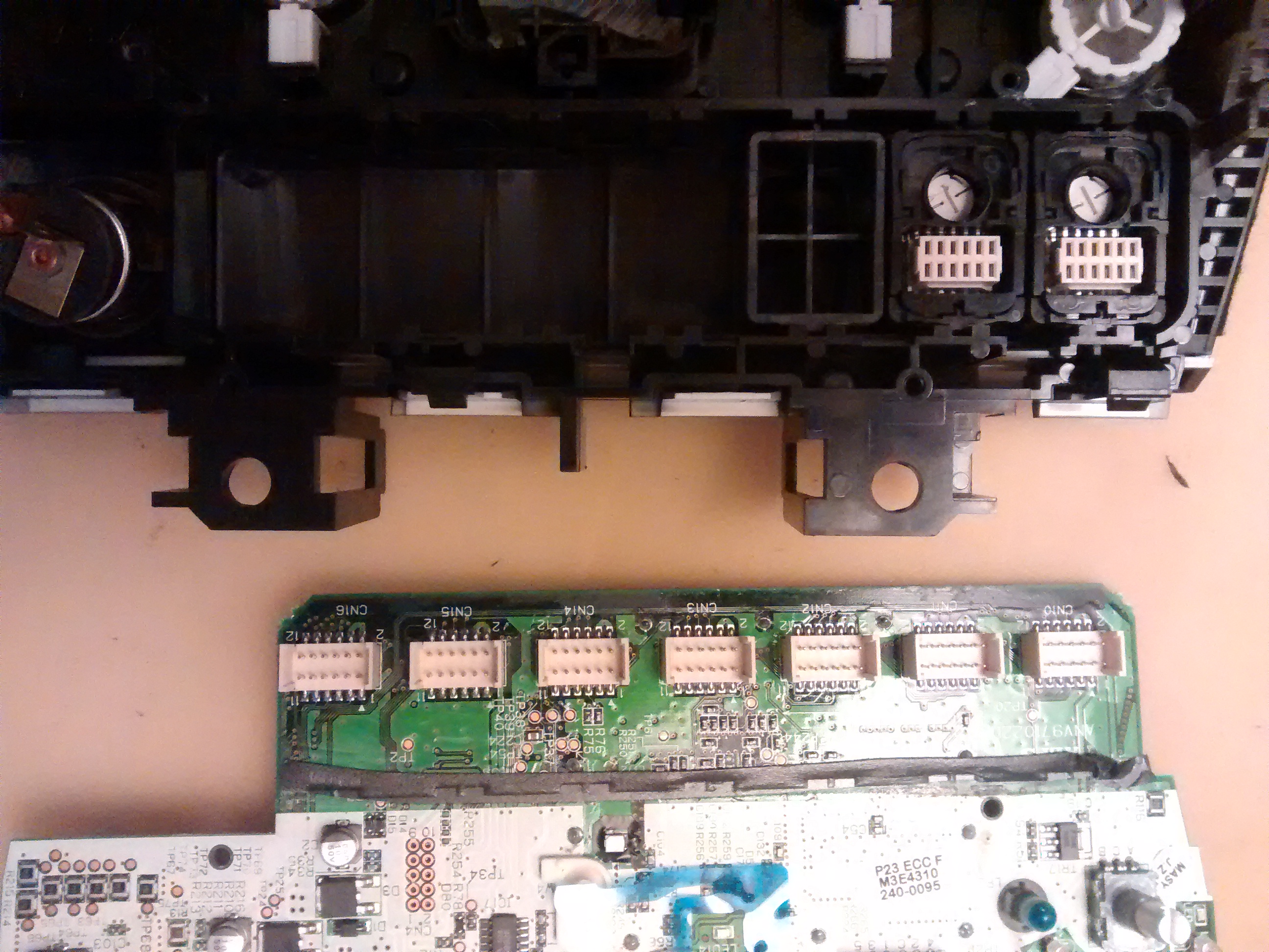

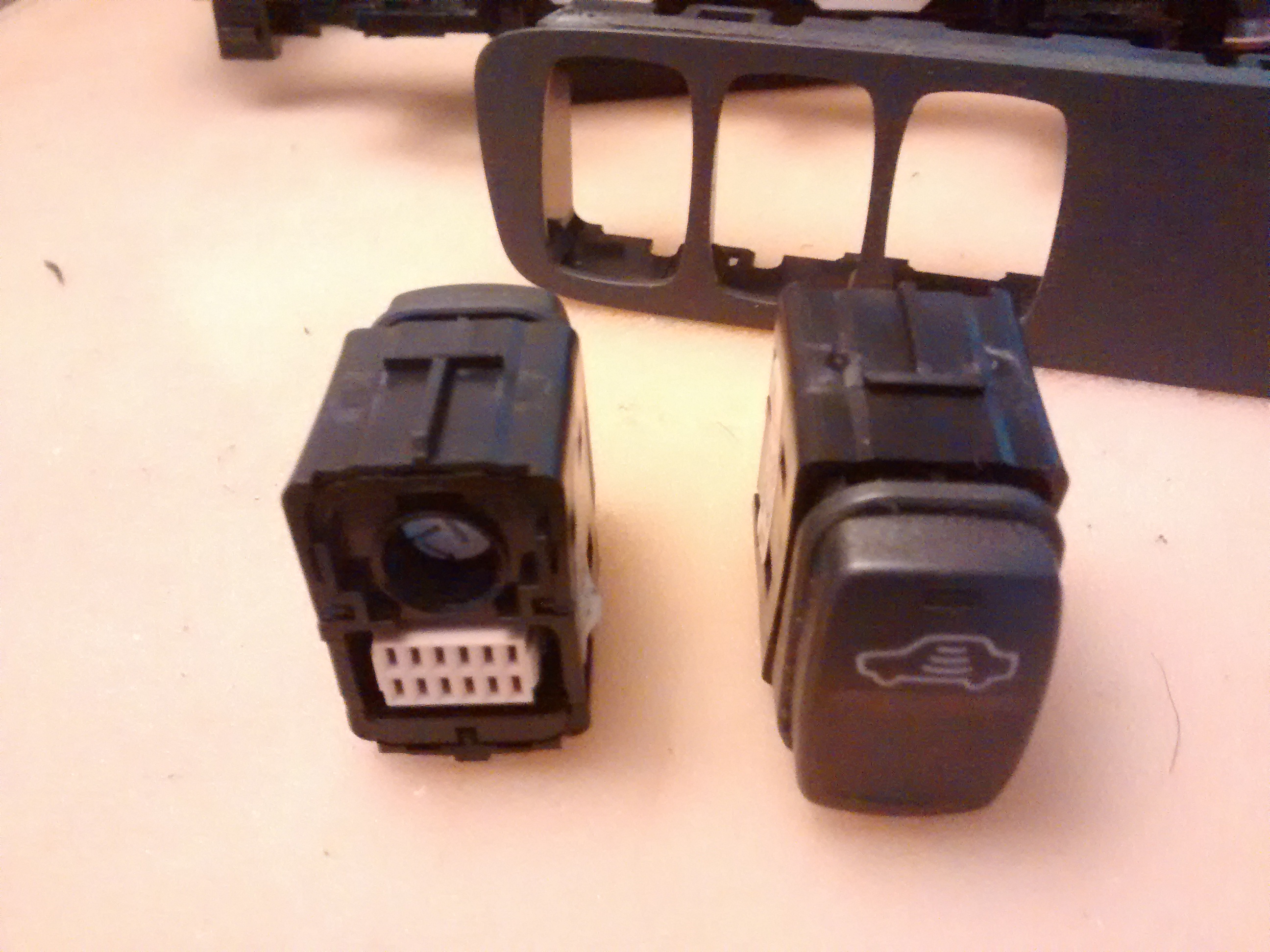

Sandcastle, transferring the switches is easy - since I have a spare ECC and only time to lose, I checked. Once the case is open and the PCB out (if unsure how to get there, look here: viewtopic.php?f=9&t=82005)
The button cover is held by some tabs that can be released from the inside: Once the button cover is loose, so are the buttons: I think the tough question is: will it work software-wise? I don't know.
