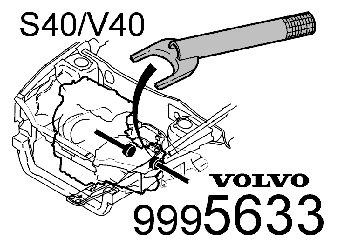

P.S. You can use two large slotted screwdrivers as the "jimmy tool." Or...you can use something that looks like Volvo's tool (maybe you can find one at the auto parts store):

Job went great! The only hitch was that I pulled on that thin metal shield when I was moving the spindle out of the way. When I put the tire back on and drove around, the shield was scraping so I had to get back under there and bend it out of the way.
I didn't need any kind of jimmy tool. Once I removed the bearing cover, the axle came right out with just a little tug.
