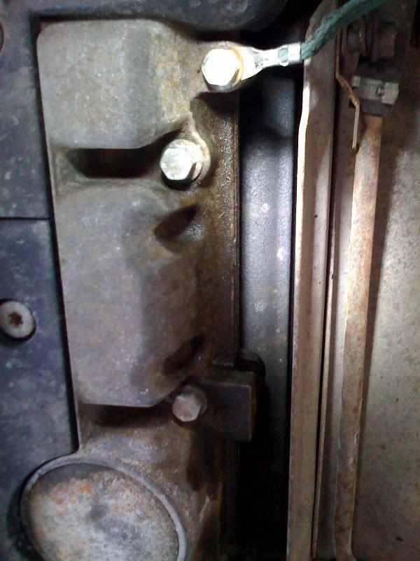

Well....
I was out looking over the vacuum lines again today with the flashlight, and I saw this..
Back side of the engine, seems to be oil right about where the seal is. I do not have any white film on my oil. It does smoke white smoke and runs rich. Idle has been rough for a while now, hence the checking of the vacuum lines.
What do you guys think?
Thanks,
Randy

That's just seepage at the upper head; the only thing that flows through there is oil. Not a big deal. The head gasket is under the lower head.

That is a relief :) I went out today and scrubbed the entire engine bay, got rid of the gunk and muck left over from winter. I will keep an eye out for more leaks/seepage over the next few days. I still can;t find the reason for running rich and rough idle though. She run good under load, but idles just a bit rough.

Symptoms of Blown Head Gasket: bubbling coolant, oil in coolant, coolant in oil.
My guess is a bad rear cam seal. I had a lot of oil where you are showing. In my case, it was a leaking rear cam seal. It leaks on the side of the engine then makes its way to the back. $10 in parts and an hour or two your first time at it.
If you decide to do the cam seal, it is a great time to swap some of the old vac hoses for silicone, since you need to move them out of the way to get at the seal.

MIJ, I went all around the engine last week with carb cleaner and had no surges. I had considered replacing the vacuum lines anyway, assuming they are 10 years old. However, when I was scrubbing the engine, I noticed that the hoses all seem to be in very good condition. Not brittle at all. So I am guessing they were replaced not too awful long ago.
a2matt, I will keep a close eye on the leak and see what it does. In any event, I will be replacing a seal or gasket somewhere, I am sure.
