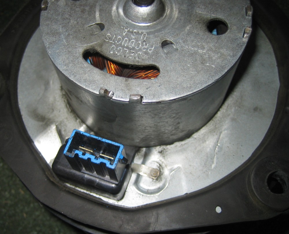

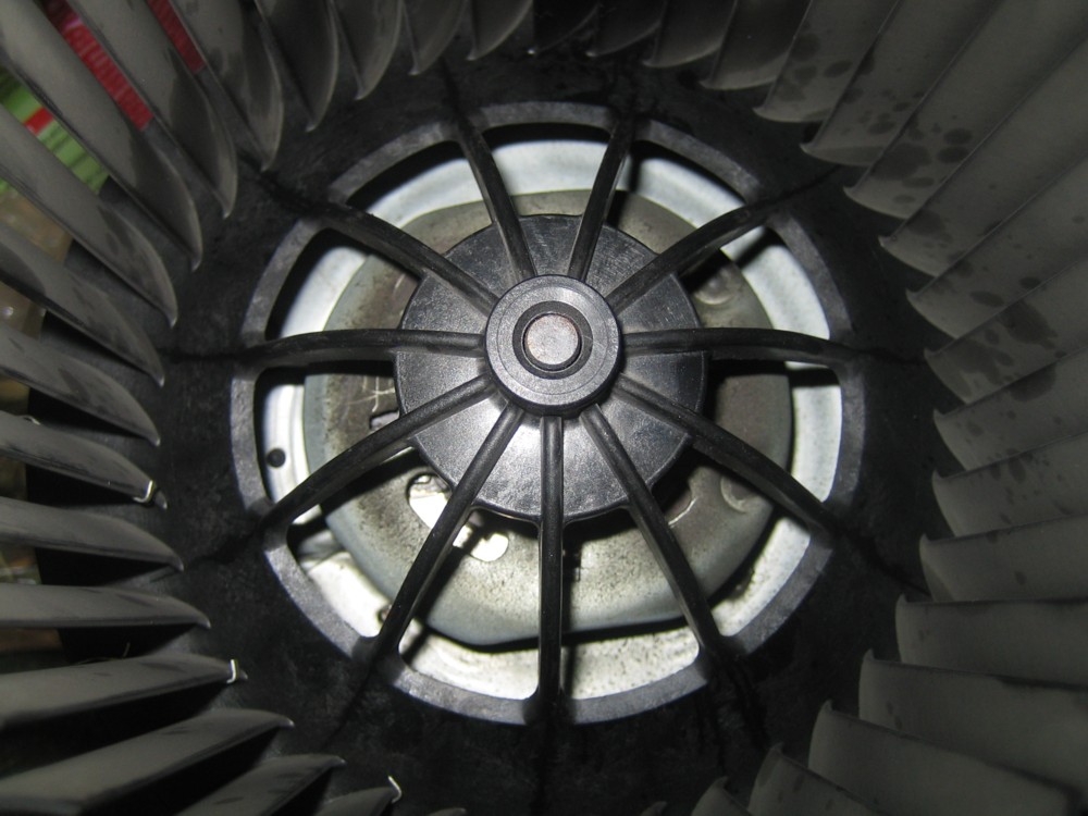

I have the blower assembly out but cannot figure out how to take it apart to get to the wires that seem to be needing crimping... I don't want to wrestle the connector or anything else without being fairly sure that I going the right path. I have attached a few pictures of the assembly- perhaps someone can direct me to the right path?

That is not an OEM Bosch blower so I sent you down the wrong path. On the Delco blower motor I have no idea.
...Lee

Ozark Lee wrote:That is not an OEM Bosch blower so I sent you down the wrong path. On the Delco blower motor I have no idea.
...Lee
OK. In my humble newbie opinion it is not meant/made to be taken apart. I guess I am on the lookout for a new blower...
