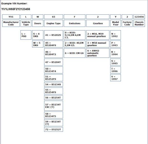

You can find out what model year car is with Vin numbers.Like this:
- VIN.JPG (41.04 KiB) Viewed 1299 times

Misha thank you.. that is an awesome bit of advise and tool you provided.. thanks
